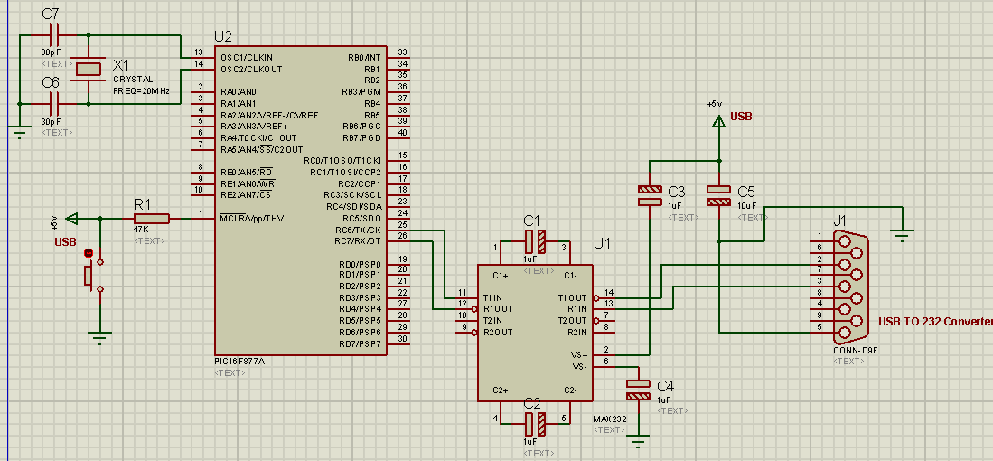

but i cant make it working in Mikro C pro... i do not know how to setting it... i use win7 64bit... i also connect 1 USB as the power source at the MAX232 pin 2(+) and pin 6(-) and i make it to power the PIC16F877A also... but it run hot... when i plug out the USB for voltage source it not produce heat.. i use laptop, so i use the USB 232 Converter... to make it run i use 1 usb and 1 232 converter at my laptop... is it my config wrong?
Here i make schematic in Proteus : Converter.png
i dun know how to upload attachment file... when i connect USB RS232 nothing happen, when i put power via USB, the PIC run hot like fever body but still can not program the PIC... I need install driver or something? if i need it where can i get it? why it hot?
You can only program a pic via serial if you load a bootloader....
To program a pic you need to use PGC, PGD, MCLR Vdd and Vss.... Via a pickit2/3 or home made hardware.... Using software to suit the design..
The MCLR is HVP ( high voltage programming pin) this is the one that needs 12.5v+ whilst programming... Look at the circuit I showed you.
