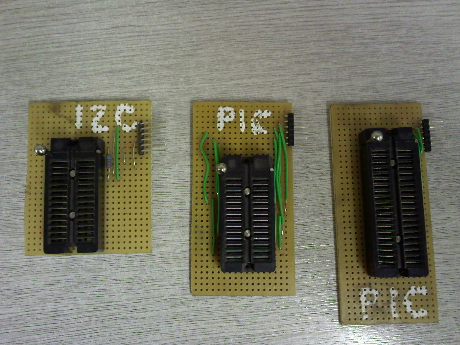

To program a pic you need to use PGC, PGD, MCLR Vdd and Vss.... Via a pickit2/3 or home made hardware.... Using software to suit the design..
The MCLR is HVP ( high voltage programming pin) this is the one that needs 12.5v+ whilst programming... Look at the circuit I showed you.
The other option is to use Nigel's hardware ( in my tutorial ). I don't think Nigel's maintains the software anymore but I'm pretty sure it does the pic16f877a

I built a relatively cheap pickit2 clone... It cost me less than a tenner.... pickit2's are the best way to go...
Have you used MPLAB? With MPLAB and pickit2 or 3 you can program all pics.... I have a 40 pin programming socket and two 28 pin sockets... With these I can program most chips

The training kit got 40 pin ZIF socket, if i want to program it on the Training Kit without use the ZIF socket(i think this is it name), which pin that i need to connect to the socket... what i done before i connect one ground pin(12), MCLR pin(1), RB07(40) and RB06 pin(39), both VCC pin(11,32) = PIC16F877A... result is error 10.47v... sometime i got different PIC detected... did my connection miss/misconnect?

To get a "MCLR is low voltage" error means you have too much loading on the MCLR pin. Do you have a pullup resistor from MCLR to Vdd?
