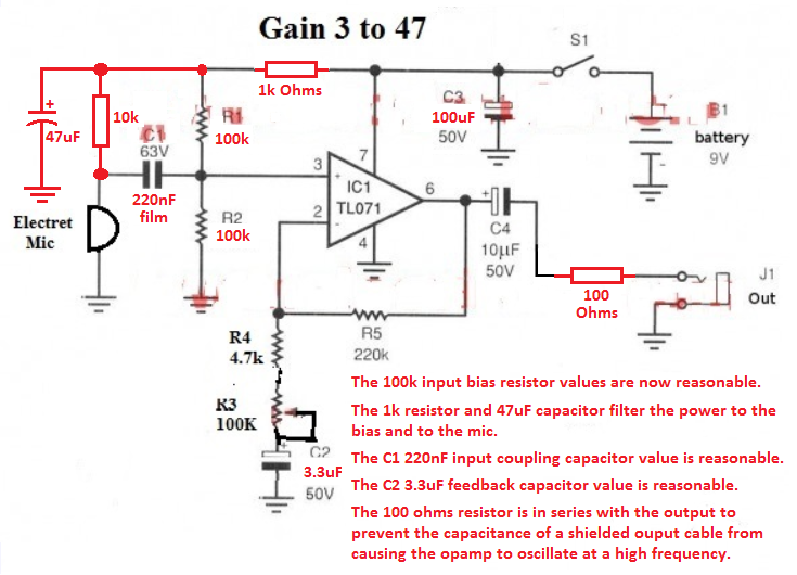

I have been watching YouTube videos on Op amp design and how they work. I need to take notes and learn the rules how they work so I can figure this out for myself. Take a look at this circuit I made some changes. Will this work?
An electret mic is a condenser mic that has an extremely high input impedance with a 48V bias voltage stored in its electret material. There is a junction field effect transistor (Jfet) inside the mic to convert the very high impedance to a reasonable impedance. The Jfet must be powered. My circuit powers it from 1k and 47uF filter from +9V and a 10k resistor. This new filter also filters the bias to the input of the opamp to prevent low frequency oscillation called "motorboating (put, put, put ...)".
The 100 ohm resistor at the output prevents the capacitance of a shielded output cable from causing the opamp to oscillate at a high frequency.
Here is my fixed circuit:
Hey that looks good. I will build that when my parts arrive from China in about 3 weeks. Thanks for all the help.
