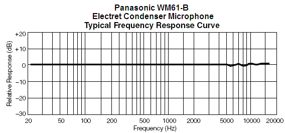

Actually the frequency response of them is exceptionally good - they don't have an in-built first stage, they have an FET buffer which is required for it to work.
Here is the frequency response of a half-decent electret microphone. A cheap one is not much different.

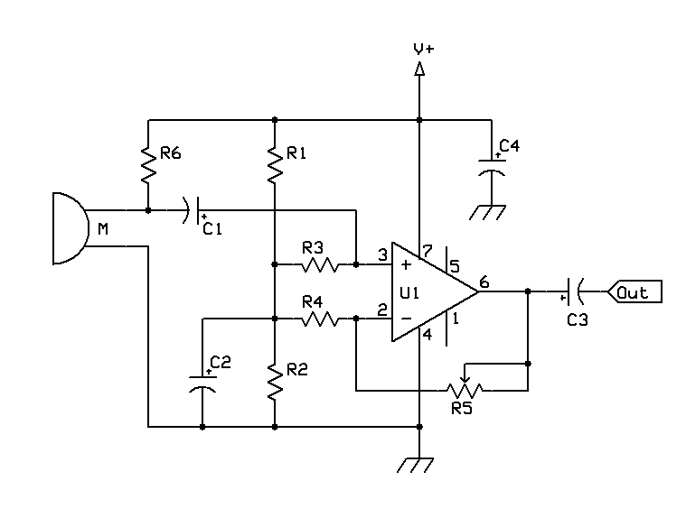

Attached is a simple non-inverting amplifier based on an op amp.
Your application - the amplification of a signal of fairly high level from an electret microphone - doesn't need a really high performance op amp, so the lowly LM741 should do fine, as would the aforementioned TL071 or TL081. The pin-outs shown are for the single-section op-amps mentioned, but dual-section op amps could be used if the appropriate pins are used for a single section - you'd just leave the unused pins floating - which wouldn't matter in this application.
How it works:
R1 and R2 are equal resistance and form a "virtual ground" at "mid-supply" voltage with C2 filtering out any noise and residual audio. Because the non-inverting input needs a voltage reference, R3 biases it at the same mid-supply - but since there is a little bit of audio that gets back to R1/R2, C2 removes that audio.
R4 and R5 work together to form the feedback circuit to set the gain, with the left side of R4 working against our "ground" (again, C2 is important here as it sets the impedance low at audio frequencies) and the voltage gain of this circuit is:
1 + R5/R4
You can read more about this circuit here: https://en.wikipedia.org/wiki/Operational_amplifier#Non-inverting_amplifier
The values aren't critical at all, except as noted:
R1 = R2 - They must be the same, but they may be anything from 1k to 100k. I'd pick 10k.
R3 - This should be pretty high to prevent loading of the electret microphone so anything from 10k to 100k would be fine. I'd pick 22k-47k.
R4 - This partially depends on the potentiometer that I have around, but you don't want it to be too low. A good range would be 1/20th of the maximum value of R5 or so - or even a higher ratio - let's say, 10k.
R5 - If I had a 100k potentiometer, this would give me a maximum voltage gain of 11 (about 21dB) and if I had a 500k potentiometer this would give me a maximum voltage gain of 51 (about 34dB). It all depends on what you need. I suspect that the 100k will work in your case - but you can always decrease R4 OR increase R5.
R6 - This sets the bias on the electret microphone and the value depends on the microphone itself. If it's an unknown microphone I'd start out with 10k if V+ is 9 volts: You should see 1-5 volts at the junction of R6/C1 when the microphone is operating normally.
C1 - This would effectively set your low frequency response. If you need, say, 100 Hz as the low end, you can get away with something as low as 0.1uF and be just fine - but I'd not go much above 10 uF. (A polarized is shown, but it not need be.)
C2 - This should be large enough in value to bypass audio that might appear. A value of 10uF-100uF is fine - I'd probably use 22uf-47uF.
C3 - This sets the coupling of the output. If it's driving a high-impedance output, 1uF-10-uF is fine and if it's lower impedance, you might need to go as high as 47uF-100uF. I suspect that your application would be OK with something in the 1uF-10uF range.
C4 - This bypasses the power supply. Often, you can get away without this since the batter that one might use has enough bulk capacitance to do the job. I always put at least a 0.1uF there for good measure, but a single 10uF would be fine, particularly if the power source was located some distance away from this circuit as the lead length can cause instability.
V+ - This depends partly on the op amp that you choose. "Officially", the '741 and the TL071, etc. may not be happy with a partially-discharged 9 volt battery, but usually all that happens is that the output gets anemic rather quickly when the voltage drops down. Since are not likely to be needing the full output of the op amp under any circumstances, I suspect that a 9 volt battery would be fine, but anything up to 18-24 volts (assuming that the capacitors' voltage ratings are adequate!) would be suitable for the '741 or the TL071/TL081. If you choose a different op amp, you'll have to check its ratings!
One thing of which one should be aware: With an op amp like the '741, don't expect it to work really well with a voltage gain much above 20-50 or so with a good frequency response - but that's probably not much of a concern in your application.
Best of luck!
WRONG. An electret mic has the same low level output as from a dynamic (coil and magnet) mic. The preamp needs a gain of 50 to 200 times. But if the piano is played loudly and the mic is inside it then the gain can bhe maybe only 10.
Why use the antique noisy old 741 opamp when an audio opamp like a TL071 is inexpensive and available?
It would result in disaster, probably noise and oscillation. an unused opamp should be disabled properly.
Since we are talking about an amplifier used only to boost the audio from an electret to drive a tuning meter, a cheap, crappy '741 should be just fine for this application: I take your point about the TL071 being much better - and it should be used if it is already on-hand, but I'd be really skeptical if it were to actually make any difference over the '741. If the '741 is readily available at the store down the street but the '071 is not, then I would certainly go for the '741 if I already had them available - unless I had a need for low noise, low offset, good tempco, high open loop gain - all those things that the '741 isn't good at!
As for the unused sections' pins left floating: I should have qualified it a bit better than saying "...in this application". Since this IS a learning forum, it's worth noting that in a dual op amp, the individual sections' isolations are typically on the order of 70-90dB and even if it did oscillate - which is unlikely since the output and inverting input pins are next to each other in the typical package and the stray capacitance would (probably) prevent it anyway - such a phenomenon would likely go unnoticed, if it were to happen at all. Still, you are right in that it probably isn't a great idea just to leave them floating.
What one of us should have mentioned was what, exactly, to do with an unused section. For an unused section one typically ties the output to the inverting input and then ties the noninverting input to either V+ or V-, as convenient: It probably isn't a good idea to tie both the inverting and noninverting to the same place as this, too, can cause oscillation in some devices, but for most modern devices, wiring it as a unity-gain amplifier is quite safe. Now, the pedants among us would point out that there are exceptions to this (e.g. Norton amps, certain types on which V+ and/or V- is outside the allowable range for an input pin, certain devices that are NOT stable at unity gain, etc.) but those are unlikely to be encountered by most, and if they have gone out of their way to use such a device, they should be reading the data sheet, anyway!
Interesting. I've always found the output of the electret element to be on the order of 10dB+ or so above the raw dynamic mic element. As one who has used both types in communications equipment I've always found it necessary to use a preamplifier with a dynamic microphone if it is being used in lieu of the originally-supplied electret on a piece of equipment - and it wasn't a question of impedance matching, either. Interestingly, condensor/electret type studio microphones seem to have about the same output levels as their dynamic counterparts, but I just attributed this to the former being padded down to match...

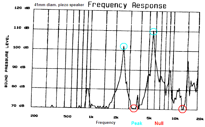

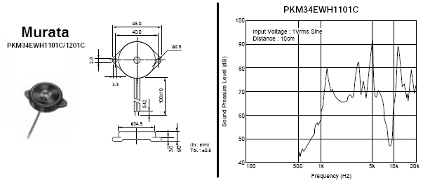

You need a microphone with a flat frequency response to pickup the fundamental frequency of the piano you arte tuning.
1) A piezo mic has many resonances that pickup the harmonics, not the fundamental, and it has nulls that might be the fundamental frequency that you want. You found a low gain circuit that is used to pickup the mechanical vibrations of a drum or from a car engine.
2) A cheap tiny speaker has a strong resonance that will completely mess up the fundamental frequency that you want.
Use an electret mic (they have a very flat frequency response) with a good preamp that has as much gain as you need.
Here are the frequency responses of two typical piezo transducers and a typical electret microphone:

The recent circuit you posted has the piezo wafer glued to the body of a guitar or drum to pickup vibrations, not pickup sounds in the air that you want.
If I use an Electret mic on the above TL071 circuit will it have a gain higher than 3?
OR should I be looking for an suitable LM741 circuit?

The gain of a non-inverting opamp like the LM741 circuit or the last one you posted is simply the ratio of the negative feedback resistors, plus 1. So the gain of the last circuit you posted is (R5/R3) + 1 which is (220k/100k) +1= 3.2 times with ANY kind of input signal. Since the value of its C2 is much too high at 10uF then the value of R3 can be reduced to 4.7k ohms for a gain of 47.8 times.
