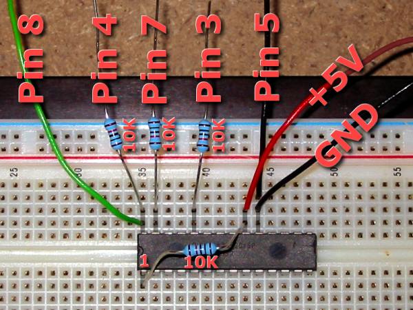

I just connected the respective pins of the Com port to the Respective Pins of The PIC through Resisters as shown here. **broken link removed**
Then I used the settings: JDM programmer, Windows API, and the only available comport, COM 1. Then I programmed using Program All, command.
The software is little Awkward, in that It took about 1.5 minute to program (my small program). Then it took another 1.5 minute to verify. Since It kept verifying without issuing an error, I at first became quite hopeful but quite cunningly at last it threw out: "Verification failed at address 0000". lol.
From that very page
For reading and writing program memory using this adapter, you also have to apply power to the PIC (+5V at Vdd) and tie MCLR to high level (Vdd) (Microchip suggests to use a resistor for MCLR because of latch-up risk). An oscillator circuit doesn't have to be connected. Of course, connect the three lines PGD, PGC and PGM to this adapter, too.
And then he gives you a picture showing the 5V line. You have to provide that 5V supply and tie its gnd to gnd from the serial port.

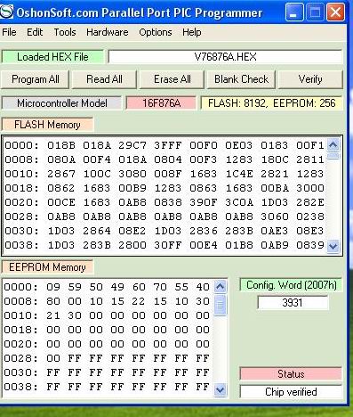

Well have just changed one of the parallel port pins to make my programer compatible with the Oshonsoft software which I loaded and ran on all the default settings apart from the chip type.
As you can see it the program is almost 8k and it burnt in 30secs and verified in 20secs.
Seems their software is really very simple with mininal settings to change or confuse folk.
It still sounds as if something is not right with your build, as mentioned earlier a new strip board or pcb built 'tightly' with all new parts and using a short shielded parallel cable should work ok.
If you were a pure hobbist I would almost offer to post you out one of these boards, but as you are a EE student with resources available to you that would not seem the right way to learn.

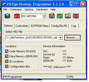

Let me tell you a funny thing you can program a 18f2550 serially with **broken link removed** software. Use it to load the
firmware for a pickit2. The programmer **broken link removed**
I don't have a pic hooked to but you can see it found the programmer it a JDM like ICSP That I made three year ago for some one on this forum
