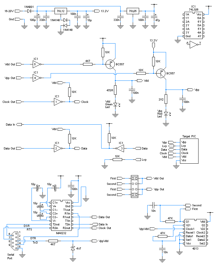

Serial Port PIC Programmer
but the schematic seems hung.
I hope I require only this part
But what do I connect to the
Vcc, V+, Data Out, Data in, Clock out, Vpp Vdd ?
Here's the full schematic.
Your image shows only the MAX232, you need the complete circuit.

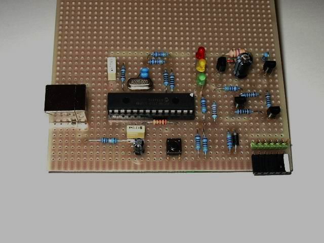

Either buy a proper usb programmmer like a genuine Microchip Pickit2 or build your own like the Pickit2 Lite as shown many times in this forum.
Max-232 is said to boost the voltage in itself (by using external caps). What do I need the 13 volts supply for?
(I am not into buying professional programmer nor into trying things as complex is pickit2 lite)
I built a MAX232 based programmer that just needed 5V. I still have it somewhere and it worked well. I believe the Vellman kit is very similar.
Well have tried and failed to get JDM type programmers to work,the type of serial port on your pc has a lot to do with it apparently.
Had a degree of success with the Parallel Port programmers though most seem really limited in the chips they can use etc.
The Pickit2 Lite is actually very simple, if I can build one sure anyone can.
The only part you might find difficult to source is the 680uh choke ( the Ferrite is not needed )
The other problem is that you must program the 18F2550 chip to start with but sure a local ET member might help out there.
The advantages would take too long to list.
The 13V is required to program the chip. It is applied to the VPP pin during programing.
Generating the 13V VPP is often the fly in the ointment.
If you have a 13V supply you can use it place of other methods of generating VPP (MAX232 RS232-port charge pump). Just be sure the programmer uses a transistor to turn it on and off.
If you do not have one you can build one with a LM317 regulator and a few resistors and caps.

How did you generate 13V+ source? I am thinking of using 12V battery in series with 1.5 volts. OR, just a fully charged 12-V Lead-Acid battery (which I posses) is enough as it is around 12.8 Volts?

For the 13V, use a 12V regulator, 7812 or 78L12, add a couple of resistors to change the output to 13V.
This requires a pre-acess to around 15V DC or higher isn't it?
O.k. then I have to search for 220/15 V transformer.
