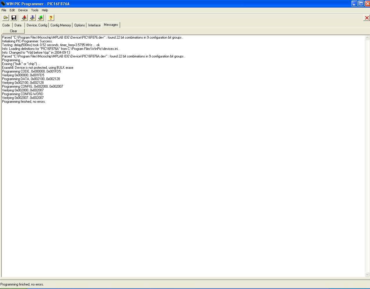

Well wonder why I wasted my time building several PP programmers and taking the trouble to write a PDF for others to use to complete a pic project I did, if they don't work ?
Have just programmed a chip with one as you can see on the screenshot below.
As already mentioned you may have damaged your parallel ports or still have some damage or incorrect wiring on your programmer board or possibly even blown your pic chip.
You also have to check the programmer software that all the options / parameters are also correcly specified -its easy to miss them.
Thats why its so difficult for a beginner with limited knowledge, abiltiy and parts to get them working first time.
Often you find it easier to totaly scrap you existing board and build a new one with new components.
With all you have now learnt why not give it a fresh try....
