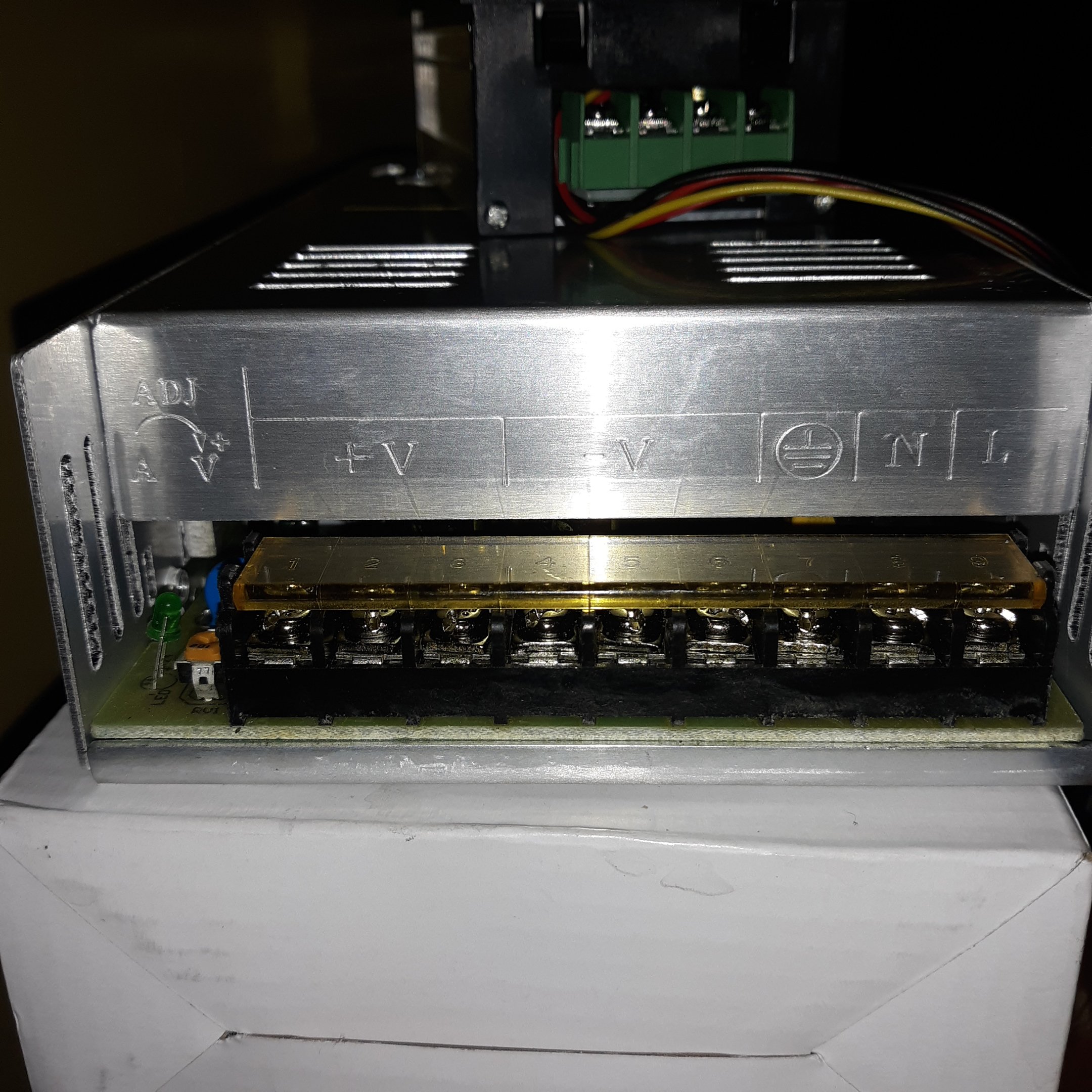

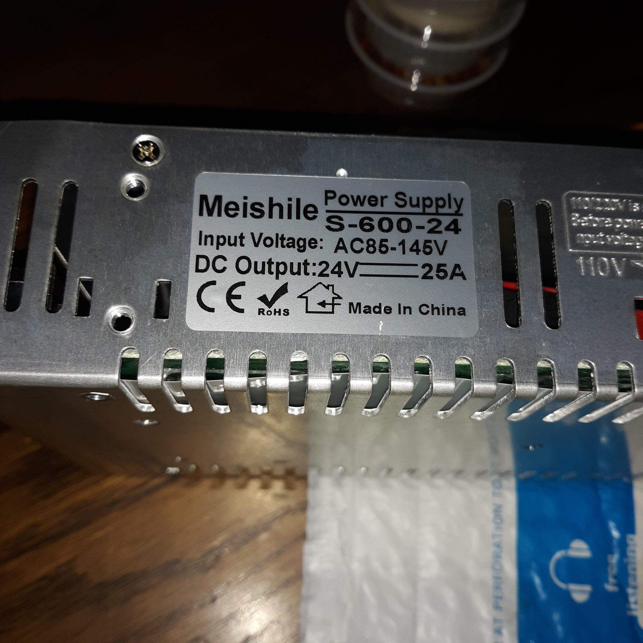

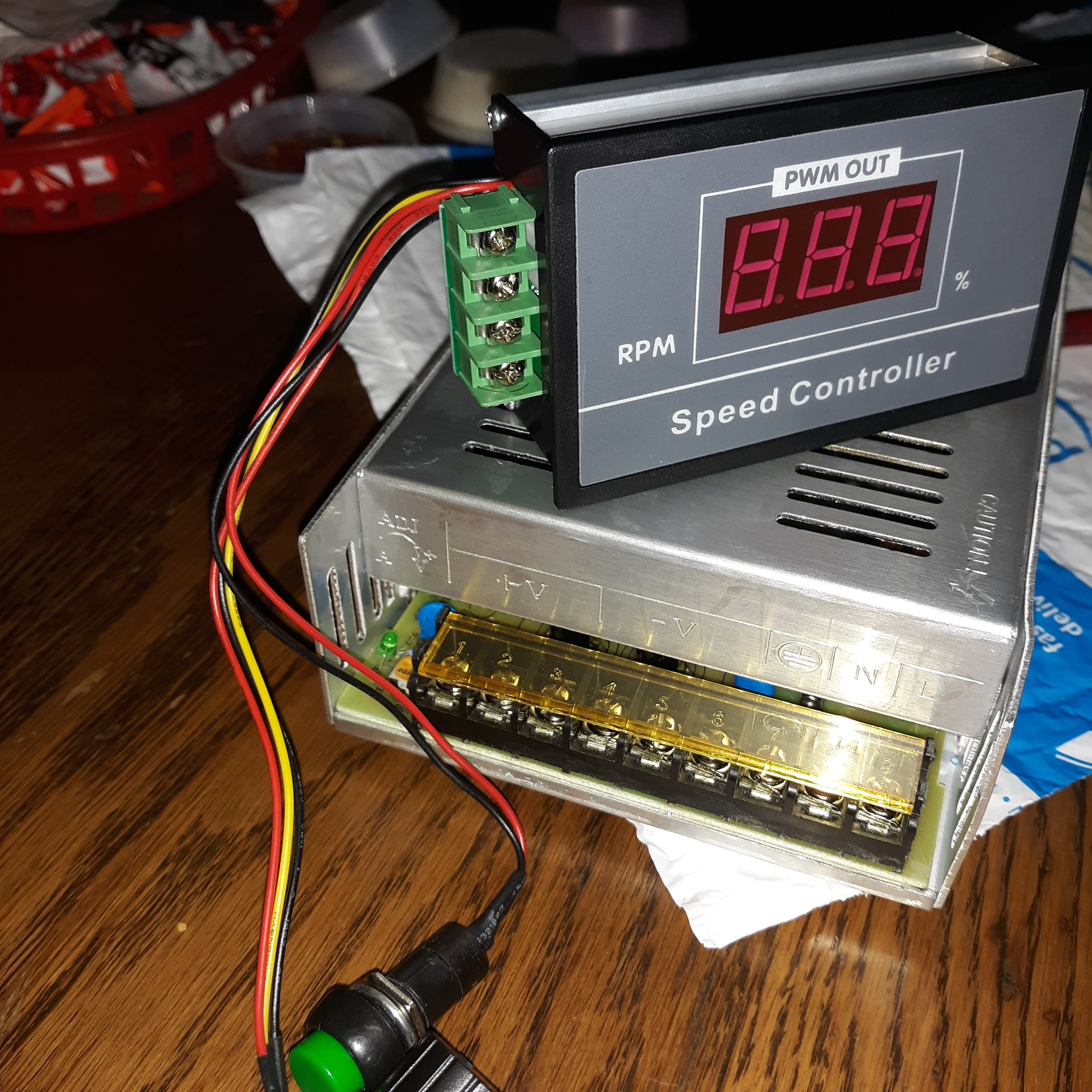

Ok so I baought a 24v switching power supply 25Amps and a speed controller with a potentiometer a d start stop button. How would I wire this to run a wheelchair motor?

The hook up should be intuitive as all devices should be marked with the specific terminations.
120v AC supply in to the P.S.
24vdc output to the PWM controller and PWM out put to the 2 leads of the motor.
Max.
So this power supply goes from 3v to 60v ,there is 3 positive and 3 neg terminals . How does this ps know to operate at the voltage the motor is wound for?
Your power supply is clearly marked as 24V DC @ 25A. What makes you think it's 3 to 60V?
Edit, posted simultaneously.
Do you have a link to the PWM controller as I assume your next question will be how to control it.
