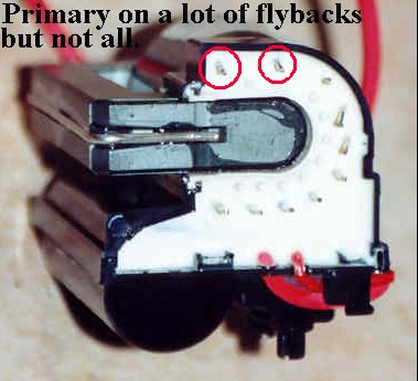

I'm aiming to build a high-voltage power supply for an electrostatic precipitator cheaply using a salvage flyback transformer. Fortunately for me, my in-laws had an old TV they wanted to discard. Unfortunately, I'm kinda puzzled by what I'm seeing.
The biggest puzzler for me is: What's that thing between the flyback and the suction cup?
Picture:
As you can see, it's got two high-voltage connections on the top (they're labeled "in" and "out") and 4 pins on the base.
My Google-Fu has failed me here: I'd think it was a splitter, but there's only one output. My next guess would be a rectifier/voltage multiplier, but aren't those supposed to be incorporated into the flyback casing? Anyway, I'm stumped.
Does anyone know what this thing is? Should I remove it from the line or keep it? If I keep it, what (if anything) to I do with the pins on the base?
The primary on mine was 1 to 2 ohms.
When you get it working, hold the HV wire near the other terminals.
It will tell you which one is the HV negative.

There is most likely a Resistor(s) and a Capacitor from the high voltage to pins on the bottom of the "Thing".
Many small Flyback Transformers do not have the RC. The transformer from post #2 does have the RC in side the transformer.
The capacitor reduces the ripple voltage.
The resistor is there for two reasons, 1--is to supply a minimum load. 2--is part of a voltage divider to take the high voltage down to 5 volts for feedback. (used to measure the HV)
Resistor: I can not see but there might be only one resistor to a single pin. Or there might be a 2 to 5 watt resistor to a pin and a second resistor from that pin to another pin. (so both resistors of the voltage divider are in the "thing".
If you can find the ground end of the focus pots....connect to ground.

ClydeCrashKop: The pins you circled correspond to pins 1 & 2 in my chart (1.8 Ohms, tied for highest resistance with 1 & 3). Does that sound right?
ronsimpson: What should I do with the "thing"? Connect some or all of the pins to "third rail" earth ground? Back to the negative pin on the secondary (once I find it)? Leave the pins disconnected? Remove it entirely? (Aside: On closer inspection, "C", "NC," "NC," "NC" is stamped in the plastic near each pin on the bottom of the "thing." No idea what that means...)

Could the "thing" simply be a voltage multiplier, x3 or x5 ??
No, it's a capacitor (to regulate the voltage to the CRT, basically a reservoir capacitor), it will also include a discharge resistor, which 'might' be used for voltage feedback as mentioned previously (but that would be unusual).
I suspect such additions, which were pretty rare, were to compensate for poor design? - with a decent designed LOPT stage the CRT capacitance is plenty.
It was not common for old TVs to have a bleeder resistor on the HV. I used them to save TV repairmen and to help regulate the High Voltage.
The picture size is related to the high voltage. On most TV sets a picture that is 99.9% black is smaller than a picture that is 99% white. I have seen 10% change in size.
Watching TV with Cowboys and Indians running through the trees .... no one notices that the size of the trees changes depending on how bright/dark a tree is.
The reason we hate to see computer text on a TV is that the size of the picture changes with the video. It was a real problem to have a line of black text on white background followed by 10 lines of white text on a black background. These "text boxes" changed size from top to bottom.
CRT monitors used for computers or medical imaging can not have the size change with brightness. Low end monitors used bleader resistors to help with regulation. Capacitors limit how fast the HV can change. A large capacitor does not hold the HV constant but it might take 100s of lines for the voltage to change. This looks better.
In good CRT monitors there is HV feedback and some times horizontal size feed back. For many years we made monitors that held 30,000 volts to with in 10 volts from full load to no load. We bragged we held the horizontal and vertical size to 1/2000 under any condition.
