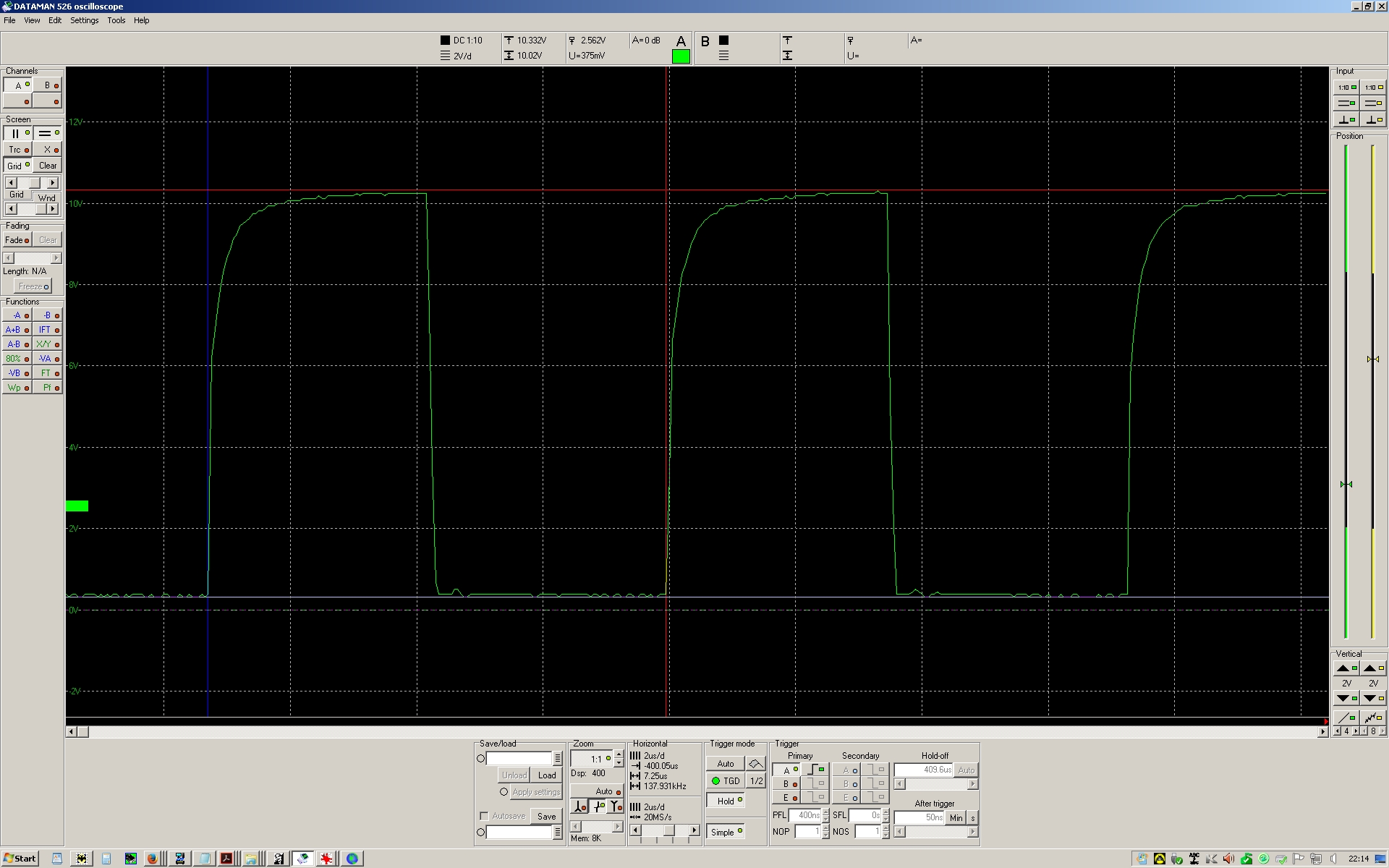

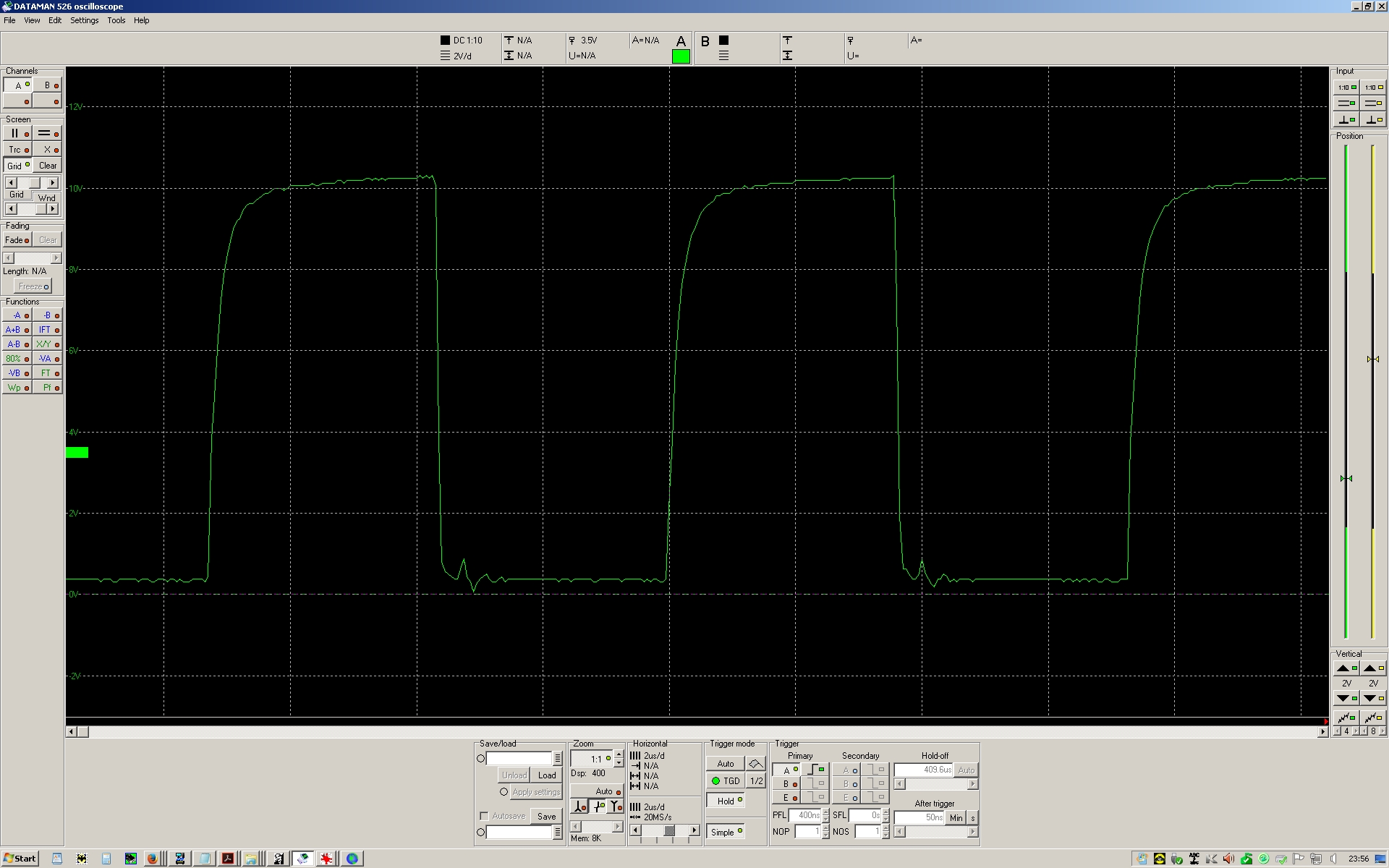

I may have tried to be too clever, but to avoid some tricky de-soldering I removed the 50V supply to the drains and re did the
measurements with the following captures obtained. Note changes in voltage scaling. Thanks for your tireless interest!!
OK thanks.
Can you now put a short across the capacitor at the output of the 74F74 and repeat the same measurements.
spec

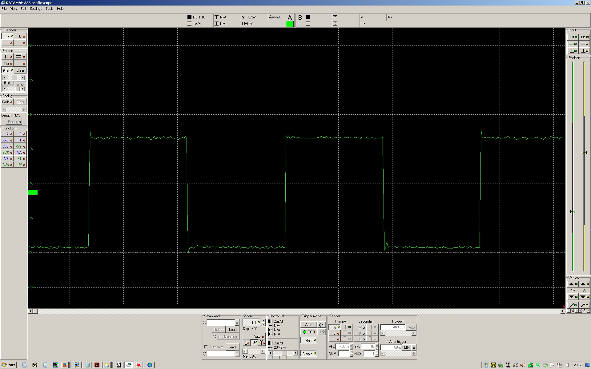

OK, same probing as before, same scope settings, but with C1 shorted across so it's effectively no longer in circuit. Your patience is remarkable! Sincere thanks :)

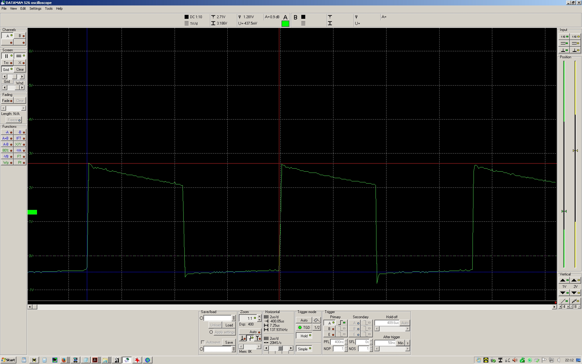

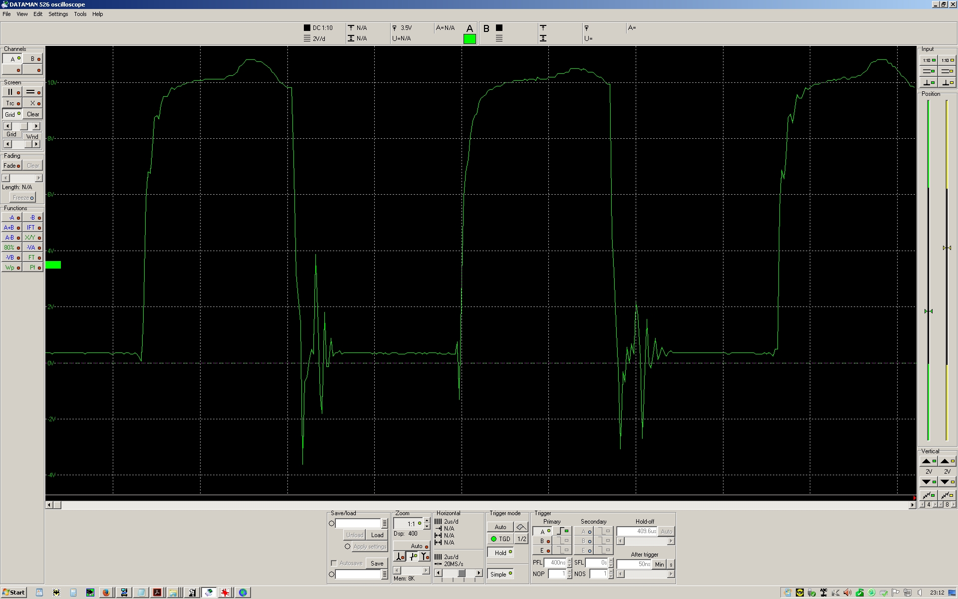

Gate when output just went "funny". No blown FET but output transformer heats up darned fast and Scopematch goes berserk. This is from tonight's transmissions.
Is this fault condition with the 74F74 output capacitors effective or with the capacitors shorted out.

I suspect that there is not sufficient high frequency decoupling of the IR2110 supply lines- gate drivers are particularly touchy about decoupling. The 74F74 may also have insufficient high frequency decoupling.
Can you connect a 100nF ceramic capacitor (no other capacitor type will do) with as short a leads as possible physically across the following pins of the IR2110:
(1) VDD [9] to VSS[13]
(2) VB[6] to VS [5]
(3) VCC[3] to COM [2]
Can you also connect a 100nF ceramic capacitor across the following pins of the 74F74;
(4) VCC [14] to GND [7]
spec
spec
With them in circuit. I cannot run without them as I have proven that one pin of the driver is always high with no signal and without these caps. I run the amp powered up all the time, only the input signal applied sets it into action. If I tried to run with these caps shorted and no signal I am sure a pair of FET's would just go bang. I did wonder if the drive signal would be "stronger" if the value of the caps were to be increased. I attach a circuit from a UK amp designer that shows how the capacitive driving of the FET's is normally done on these LF amps. Pluse he has some nice safety circuits.
