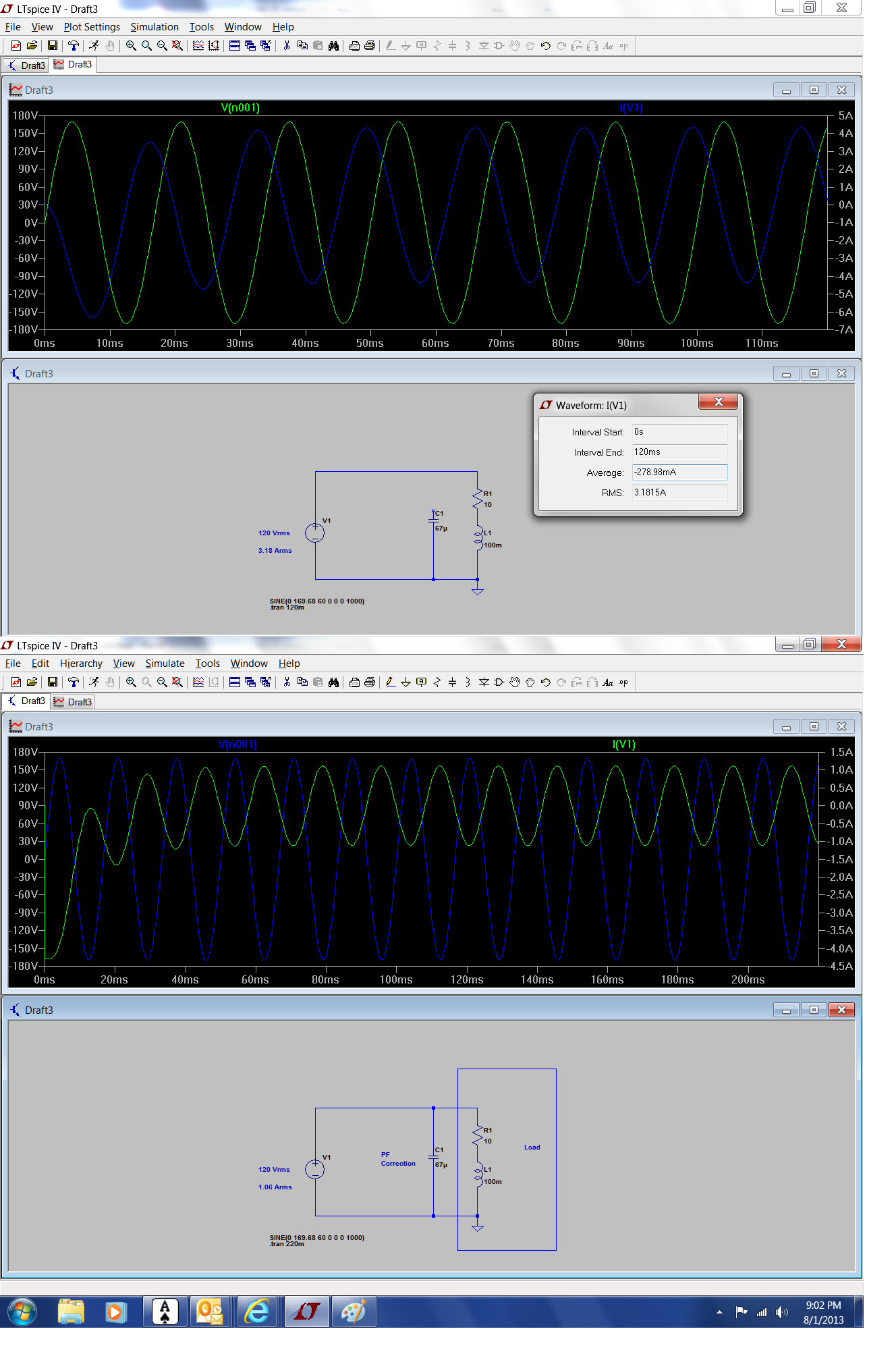

PF
The whole thing doesn't work in my mind. :rolleyes::p:confused:
But I can understand that uncorrected the first trace needs 3X the current from the power source as the one with power factor correction.

ok maybe the motor is a bad example.
3KVA X power factor of 1 = 25 amps
3KVA Watts X power factor .7 = 17.5 amps
There is a recurring theme that if you had a 3kw load and it had a PF of 0.7 it would not be a 3kw load anymore.
If I designed a 3kw load for DC it would use 3kw. (25A from the example in post #8)
If I designed a 3kw load with a pf of 0.7 and used 60hz it would use 3kw. (35.7A not 17.5A in the example)
I see a 3kw load (under rated conditions) uses 3kw.
