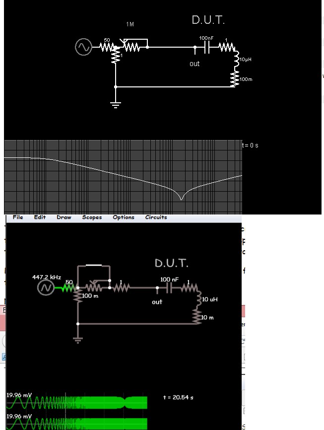

Any 5V CMOS clock @50 Ohms ESR or so will work with a series R if one doesn't have a Sig. Gen.
Or Sig Gen with FM input for measuring DUT input impedance.
Getting back to OP's question, it would be easy to generate a 1MHz CMOS clock with a larger Series R as CMOS outputs are close to either 25 or 50 Ohms depending on type of CMOS, THen measure the square wave Vpp with a precision OP AMp diode rectifier with gain then input an ADC to measure the resulting square wave at a slow conversion rate.

One of my goals in trying to determine ESR through real world testing was to eliminate the value of C from the equation so that we get a measurement of ESR alone without interference from what the value of C might be. This might not be mandatory however, as i and others have noticed that bad caps tend to increase in capacitance as well as ESR. Maybe new caps wont follow this rule though so i thought it would be good to try to eliminate the C value so no matter what it might be or change to, we still get a good ESR reading. Interestingly, i think this is possible even at low frequency like 120Hz. Havent experimented with it yet.
My ESR meter measures at 120Hz and 10kHz, which gives slightly different readings depending on the device.
Normally it is pretty close but begins to change and include ESL.
DF at 120Hz is pretty standard and EU has to convert to 100Hz by a simple calculation as it is directly related to the tan delta which is the ratio of ESR/X(f)

What kind of meter is it? Is it homemade? If it's a commercial meter, one would think it would also measure at 1 kHz.
One would think it would measure at 100KHz, as that's the standard frequency used for ESR testing, and the value normally used to generate the values in the capacitor datasheets.
As far as actual usage goes, again it makes sense to use a high frequency, as that's similar to what the capacitors work at in SMPSU's.

This thread is about ESR meters, which measure at 100KHz - for an LCR meter there isn't really any need for a specific frequency, and (assuming it uses frequencies at all) very obvious reasons for using a wide range of different ones.
