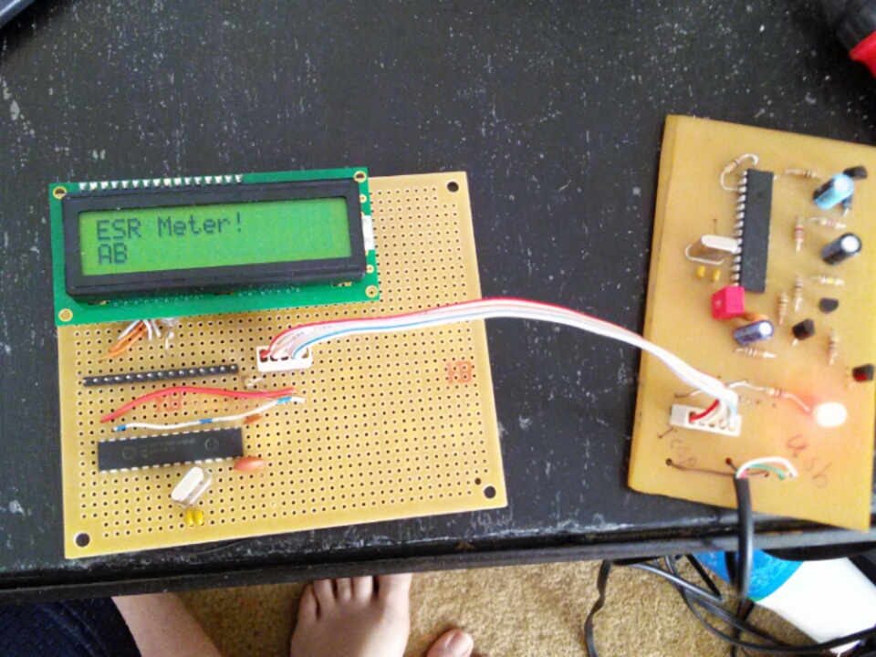

I don't think it cares about what the wave is sine or square. I just want it to work good. Yep could buy one but I can make one too its just getting the math right from the pic. I think I got that part ok
Now I think I got the wiring figured out.
Started a board last night after work stayed up till 4 am playing with the output side. To get a good 100khz output
Tonight I'm hooking up the LCD and the rest of it got my stuff from tanyda in.
So I'm set to go.

I got the board made almost I tested my code for Lcd
The Lcd works now to add some more part's for the tester the thing on the right is a home made pickit2 clone. Glade i made some of them I lost my real pickit2 when I moved to KY.

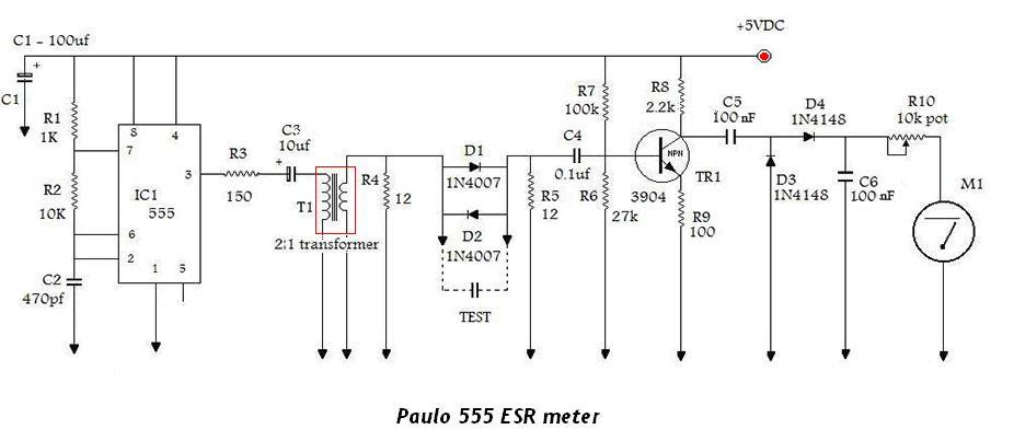

Hi, I made other more simpler ESR meter (look at attached schematic) from here **broken link removed**
Amazing! It is working well. I had to use 33 ohms emitter resistor instead of 100 to get full scale reading because my cheap meter was 500uA, instead of 50uA. Probably you also felt hard to test very high value capacitors like 4700uF etc. Lets say- their well condition ESR is approx 0.002 ohms and very poor (damaged) condition ESR is approx 0.8 ohms. But with such analog meter, it's hard (not possible) to measure 0.002 and 0.5 ohms difference. Both shows full scale on meter and both seems good quality capacitor. How did you repair or decided in the condition?
To distinguish such detail you'd prob have to add a range switch to shift the DC bias point of the base and permit greater A.C. amplification via the neg. feedback emitter resistor. Perhaps with a 10uF cap across that emitter resistor.
Hi Willen,
Theres little diffrence between the ludens schematic and the one you posted, in fact the ludens one has less parts, the osc and the amp are in one 8 pin chip, not having a transistor theres little in the way of biasing resistors.
The scale on mine starts at 30 ohm, going to 2 ohms 1/2 way, and the last quater way is 1 ohm, so you can read down to a fraction of an ohm, the only thing with a log scale is that you couldnt resolve 10 ohm from 10.5 ohm, however its more than acceptable for repair work, I dont read resistance the diffrence between a good and bad cap is usually large, tens of ohms.

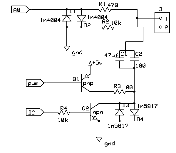

I'm going to use a tl431 to set my adc vref to 2.50 volts I was thinking maybe just use two diodes that would get me closer to 1.40 volts I thought I I had a 1.25. But are there any ideas on how to get me close to 1.1 volts the adc doesn't need much to work I figuring on setting it to few mA what would be bad about using the tl431 and voltage divider I can't change chips the 18f2550 is soldered in lol
