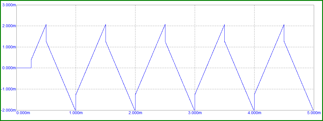

I did a quick simulation of 1000uf with 0.030 ohm ESR. Waveform attached. The source is again a plus and minus 4v square wave, and the added series resistance for the test was 600 ohms.
This is certainly a simple method with a scope.
The Step voltage is a result of the ESR in the Cap, which in this case is 0.4V out of 4.0V pp or 10% and thus 10% of 600 Ohms or 60 Ohms.
Using the ESR*C figure of merit, this cap is 1000u*60 = 60ms which is a good result. ( 1ms best... 1 second is poor)

Sorry, but i dont understand what you are trying to say here.
The graph i had shown shows a total wave amplitude of less than 2mv, and the ESR amplitude is only about 1/5 of that (estimate) which means it is only about 0.0004v and at 8v/600 amps current change that means we have ESR that is:
ESR=0.0004/(8/600)=0.030 ohms.
We have to use 8/600 instead of 4/600 because the current changes from +4/600 to -4/600 which is a total change of 8/600, and that leads to the correct ESR.
I guess you were also working in millivolts intead of volts which makes sense.
My attention to units failed.
step change on output 0.4mV ?? my mistake
step input = 4V
Rs= 600 Ohms
step attenuation = 4V/0.4mV = 10,000
if you add both input current steps + and -
then you have to add both output steps.
So dont.
So you input is only a 4V step not 8V
And my mistake output scale was mV
ESR = 600/10,000 = 60 mΩ
did I get it right this time?

Well, if you look at the voltage waveform in the post with that wave, looking at the very peak of the wave we can approximate that is 2mv. That means at that point (and because the voltage is so low) we can approximate the current at the top to +4/600 amps because of the input voltage at that time is +4v and the resistance is 600 ohms. The next thing that happens is the input switches from +4v to -4v, and that means the current is now -4/600 amps, and a nanosecond later the voltage goes from +2mv to +1.6mv (estimate), and the current required to force that change was 8/600 amps. To look at it another way, the ESR resistance is 'biased' by +4/600 amps at the very tip of the wave, then 'biased' by -4/600 amps at the lower point maybe 1 nano second later (at the bottom of the steep drop). So the resistor is first biased positively and then negatively, it does not hover at 0 amps for any real length of time (maybe 0.1 nanosecond). If we did look at that point in time, we would see a point in the steep voltage drop that is 1/2 the way down to where it starts to ramp rather than at the very bottom of the steep ramp.
What else helps to visualize is to graph the current along with the voltage, which i didnt do unfortunately. That way we see the current change rather than the absolute current value. Doing that would show a current of +4/600 amps at the very topmost point and -4/600 amps at the very lowest point of the steep slope which is the start of the downward ramp.
One other thing i should point out is that if we do a simulation with a capacitor in series with a 30mOhm resistor and using a square wave of plus and minus 4 volts we get that exact waveform. If we double the resistor value to 60mOhms then we see twice the change before the downward ramp starts, so instead of about 0.0004v we would see 0.0008v there.
The attachment shows the waveform with 60mOhms of ESR.

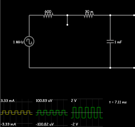

I got it now....
Using a sufficiently high f square wave then there is no time for the cap to charge up.
then it is plain to see the Voltage ratio from input to output is 4Vpp/200uVpp = 2000
so ESR is 600/2000=30mΩ
This is an easy method to check when there is ripple on a SMPS in circuit with excessive ESR . Although too low and some LDO's can go unstable, with too low a voltage feedback as the ESR*C time constant gets too low and causes phase shift in the feedback voltage with ultralow RdsOn type LDO's
