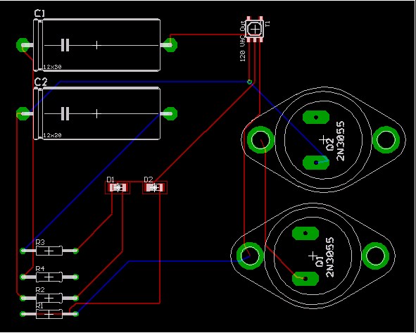

What would this DC-AC inverter look like?
I just put this together for you:
It will look something like this, but i think I got the wrong transformer (T1) chip, its kinda small and I dunno how small or big these things really are, so...
yes, you put transistors instead of the diodes, i might work.
and another thing, look at how thin the lines are, they will sart heating at below 1A and 1-2A will be enough to destroy them
I was talking about the SMD diode package which he has used instead of normal DO type package.
And one more thing, normally inverter transformers are not mounted on the PCB due to their large size. So just put large pads for its connections on the PCB.

do you know you dont understand how it works?
and another thing. this inverter is capable of absorbing 15A(!!!!!) from the power suply, so you need to make really good conections if you are going to use it at full capacity. the circuit is relatively simple and you can do it without a board, because you will need also great heatsinks for the transistors so you might not place them on the board...
I would suggest that when you build this circuit you call a friend who is good in electronics to check it out...
