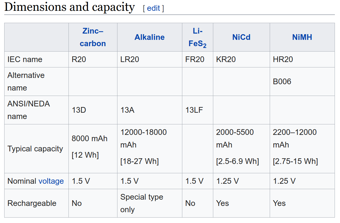

Funnily enough I was looking at D cells the other day - as (in my new job) I was repairing a couple of items (both the same) that take 12 of the Alkaline versions!.
Part of my job (the major part) is designing products to improve what's available, or try and develop new items entirely, and as I could easily greatly improve this unit and make it much smaller and cheaper I looked up specs on different batteries. Obviously I would prefer re-chargeable, as small as possible, and hopefully longer lasting. I was staggered to find that Alkaline D cells are really pretty impressive, and my dreams of a handful of NiMh or Li-ion beating them were dashed :arghh:
Not to be beaten, we're now approaching the people who use the units, to see how long the batteries last, and if having shorter lived re-chargeable ones (that you could recharge either from mains or in the van) would be acceptable. We're also like to know how much the existing units cost, and what sort of market there might be for an improved and lower cost unit.
