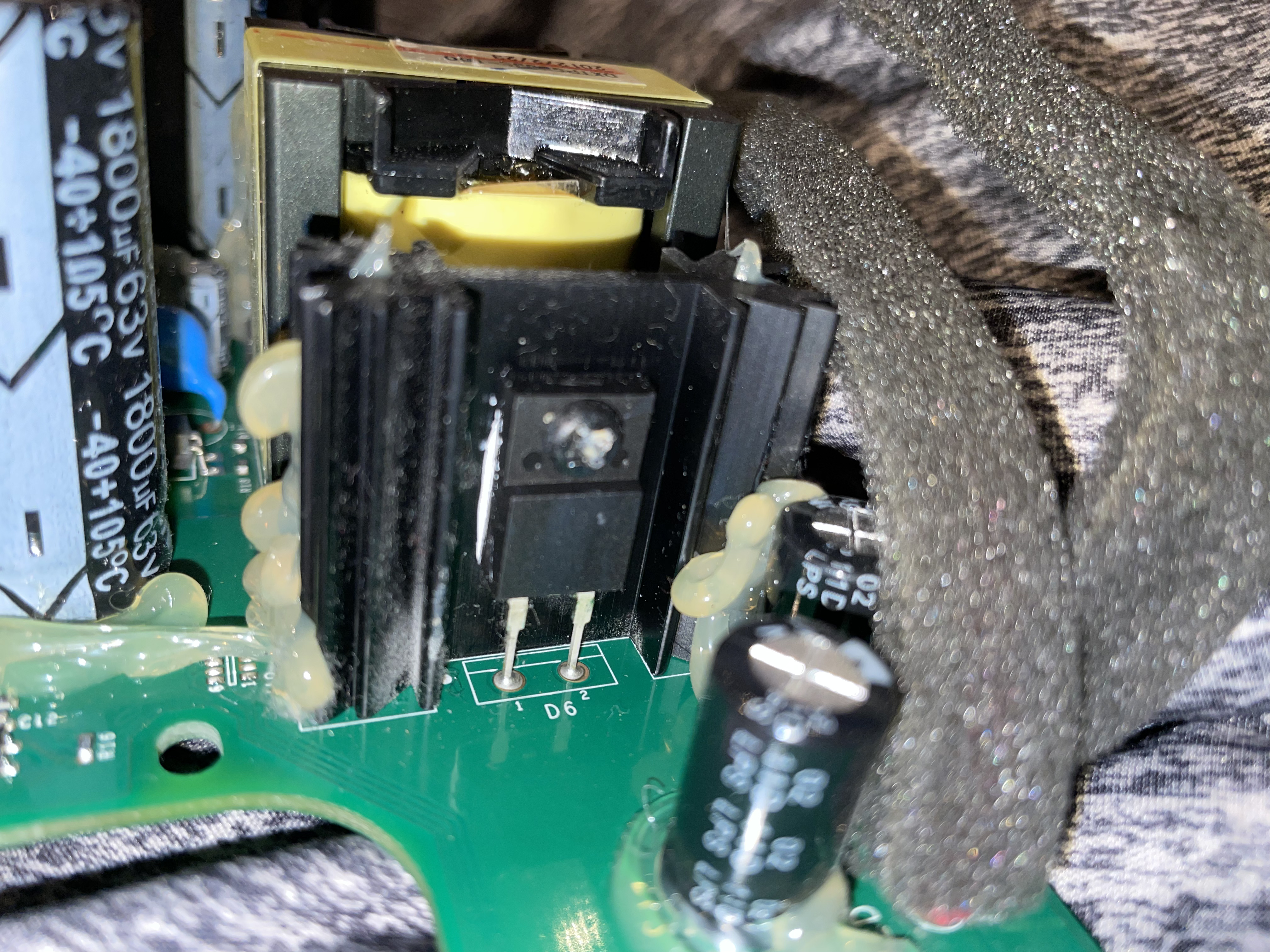

Trying to troubleshoot a defect Sonos Sub since it doesn’t start.
I have started some measurements and I have observed the following which might sound strange.
The Bridge Rectifer, when measuring between negative and positive is showing around 0.56V while I expected around 0.9V since two diodes are in series. Does it mean it is defect? When measuring between other combinations on the bridge rectifier, it seems to be fully working with regard to voltage drop and resistance except for the 0.9V.

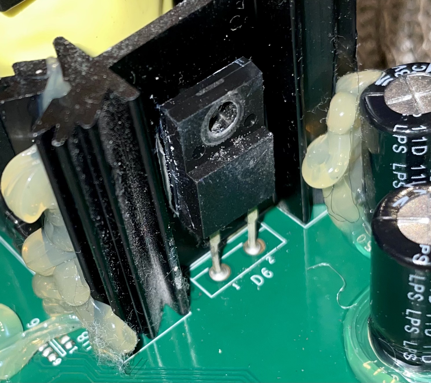

However, there is another part that caught my attention. I have measured this part (shown in the picture) and it seems to be defect. When I do diode measurement, I am getting 0.0V in both directions and ohm measurement of 0.2 ohm in both directions as well (suspected short). It seems to be connected to the transformer just behind it. But I cannot find a replacement for this as there is no marking on it. Maybe it’s a difficult question, but how do I proceed after this? Thank you.

If you're testing them in-circuit, then don't - you're not testing just the diode/bridge, you're also testing everything else connected to it.
BTW, randomly testing components isn't the way to fault find.
In a switch-mode PSU though, it is useful in a small number of areas - one of which is the secondary rectifiers - these quite often go S/C. Assuming D6 is a secondary rectifier?, then it could well be S/C - once you've found a secondary rectifier that reads S/C you need to take it out, and test it again, to confirm it's the diode, and not something else.
Generally, when testing the secondary rectifiers, I wouldn't use both probes across the diode - I'd stick one probe on chassis, and simply run the other probe down the positives of the rectifiers - as the negatives of the rectifiers go to chassis via the transformer windings. If one reads short, I'd then stick the probe on the negative side, just to check in case it's a negative supply rail :D This only takes seconds, as it's all easily accessible and obvious.

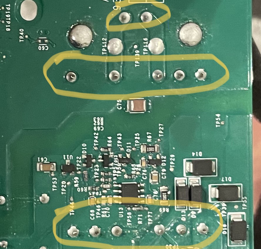

I have de-soldered the part and it still gives a short circuit reading and 0.0V reading. So I assume that the transformer is receiving a badly regulated voltage. (The input pin seem connected to the transformer and the output goes to the transformer as well when checking the PCB board?). I have marked the two pins and the transformer connections (with the many pins).
Next question is what I should replace it with since there is no marking on it… could it be a schottky diode? Why would the manufacturer not put marking stamp on the part? Seems so counterproductive.

Yes, the PSU will immediately shut down because of the short - if you're lucky (if not it will destroy itself) - it's not the feedback though (which is voltage regulation), it's over current protection.
Alright. Then I might be on to something here.
Just out of curiosity, why is the secondary rectifier diode connected back to one of the transformer pins? I am reading the circuit board correct?
Common practice, particularly on cheap Chinese gear, but even on decades old equipment manufactured in the West.
The actual 'part' doesn't matter, and a wide range of parts are interchangeable in that position - so as to avoid confusion the manufacturers often use 'in-house' numbers, and have the semiconductors supplied with that (meaningless) number printed on it. So you order your components from various different manufacturers, giving a required specification, and telling them what you want printing on them - so if one manufacturer isn't able to provide them, you can get them elsewhere. Basically they simply choose a suitable existing device from their range, and print it accordingly.
It will be a schottky diode diode, 100% - just choose one the same shape, with the connections the same way round - anything that sort of shape should be a similar current, and a couple of hundred volts rating should cover it.
For all my schottky diode repair needs I used to keep just two types - in draws labelled 'big diodes' and 'small diodes' - essentially the same size/shape as 1N5408's and 1N4001's. Those two replaced pretty well everything I even came across. The type you've got is somewhat rarer, and I'd order something suitable if and when I needed them.

It's the feed to the diode from the transformer.
If you look at this circuit, there are five rectifiers at the left, D12-16, connected to transformer windings down to chassis - this is similar to what you've got:

Oh, no; the rectifier short means AC is getting to all the circuitry downstream (which was
designed for DC operation). Sometimes replacing the rectifier is only the start of troubleshooting
(a filter capacitor shorted will sometimes cause this kind of rectifier fault).
This kind of shorted diode usually happens on the high-current low voltage side, so
the transformer OUTPUT connects to it, not the input. Bad voltage into the
transformer would saturate the transformer and burn a fuse, not an output rectifier.
I'd judge from the heatsink that this is a circa 8A fast-recovery diode, in insulated 'fullpack'
form, TO-220; something like <https://www.digikey.com/en/products/detail/micro-commercial-co/MURS860FA-BP/12395916> perhaps. Best, though, to try to find a schematic or
maybe even clean the removed component and examine with a microscope to find
a part number.

Do you think this would work or is it rated too low?
I am having troubles finding something that is better rated than this one and is fully insulated like mine (fullpack variant)… looks similar with a “broken” off pin in the middle just like the one I found in the link above.
I must be honest with you that this is actually the first time I am attempting to repair a circuit board … ☺️
As long as the connections are the same way round it should be fine.
Seems like I found another one that has a higher voltage rating.
Should work fine too?

Yes, but probably no need for that voltage - on the assumption it's a secondary rectifier.
