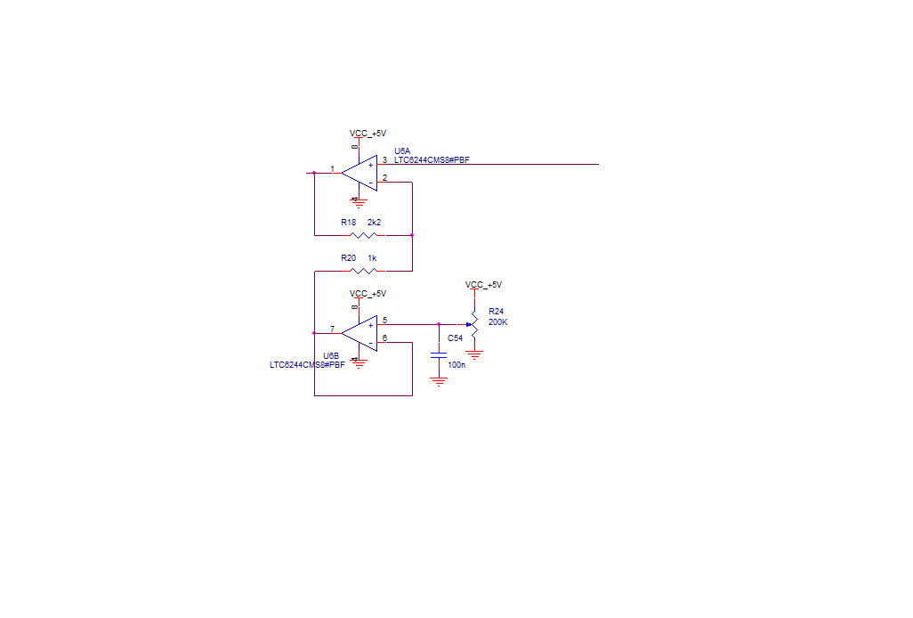

What is the gain of this circuit?
johnkaz77
Hi everyone!
I found this circuit which is supposed to be offset voltage adjustment, can anyone tell me what's the gain of the upper amplifier? Thank you.
Gain = (R18+R20)/R20 = 3.2
(2200+1000) = 3200 ,,, 3200/1000 = 3.2
I prefer the usual way G+= 1+ 2.2k/1k = 1+ 2.2 = 3.2
You are correct.:eek:
I misread the schematic resistor value.
