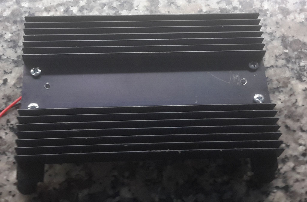

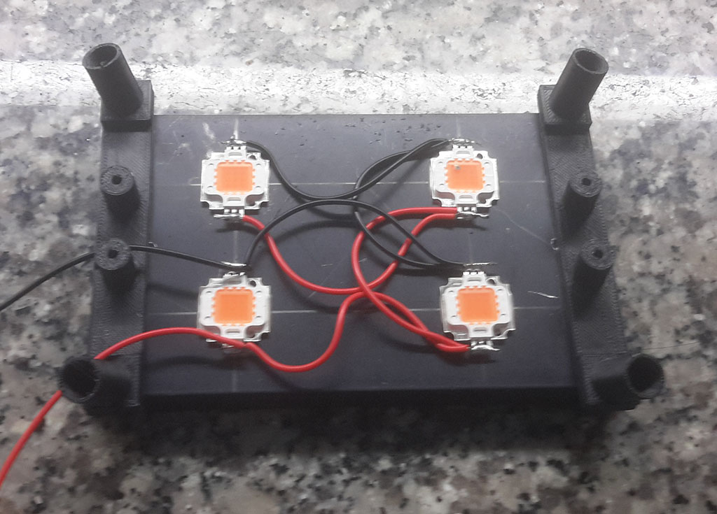

I bought 4 x 10W LEDs very similar to the above. I mounted them with thermal epoxy on a 150mmx100mmx16mm heatsink. They are 12V units and at 12V they take 1.3A! That is 16W - and they get very hot. Don't be tempted to power them without a heetsink. With all 4 combined I used a 0.22Ω resistor in series with them to reduce the power. Soldering them was the easy part. Images below.
Edit, for the curious, they were for an indoor herb garden which I managed to kill.:mad:

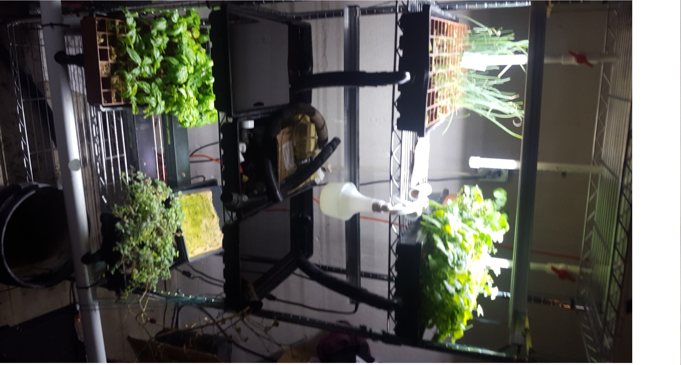

above are my herbs growing on a 40 watt 3ft strip that i paid 130$CA.. the leds are about an inch apart and uses AC power.. they dont get very hot at all ,,,,, but when the plants grow too high they still touch the light cover and burn.

herbs like cool light and shaded areas , summer veggies like it hotter,
summer veggies love the higher intensity but if the leds are getting that hot then i would suggest following the same rule as higher intensity bulbs and keep a bit further away or vent
The best cooler is a surplus CPU heatsink and fan with variable speed. with 3M thermal tape and torque on screws carefully not to crack LED. Your heatsink will fry eggs.
lol , in the first photo that is basil, oregano, lemon balm and onions ... i think onions are summer? but the smaller lights are all the herbs need

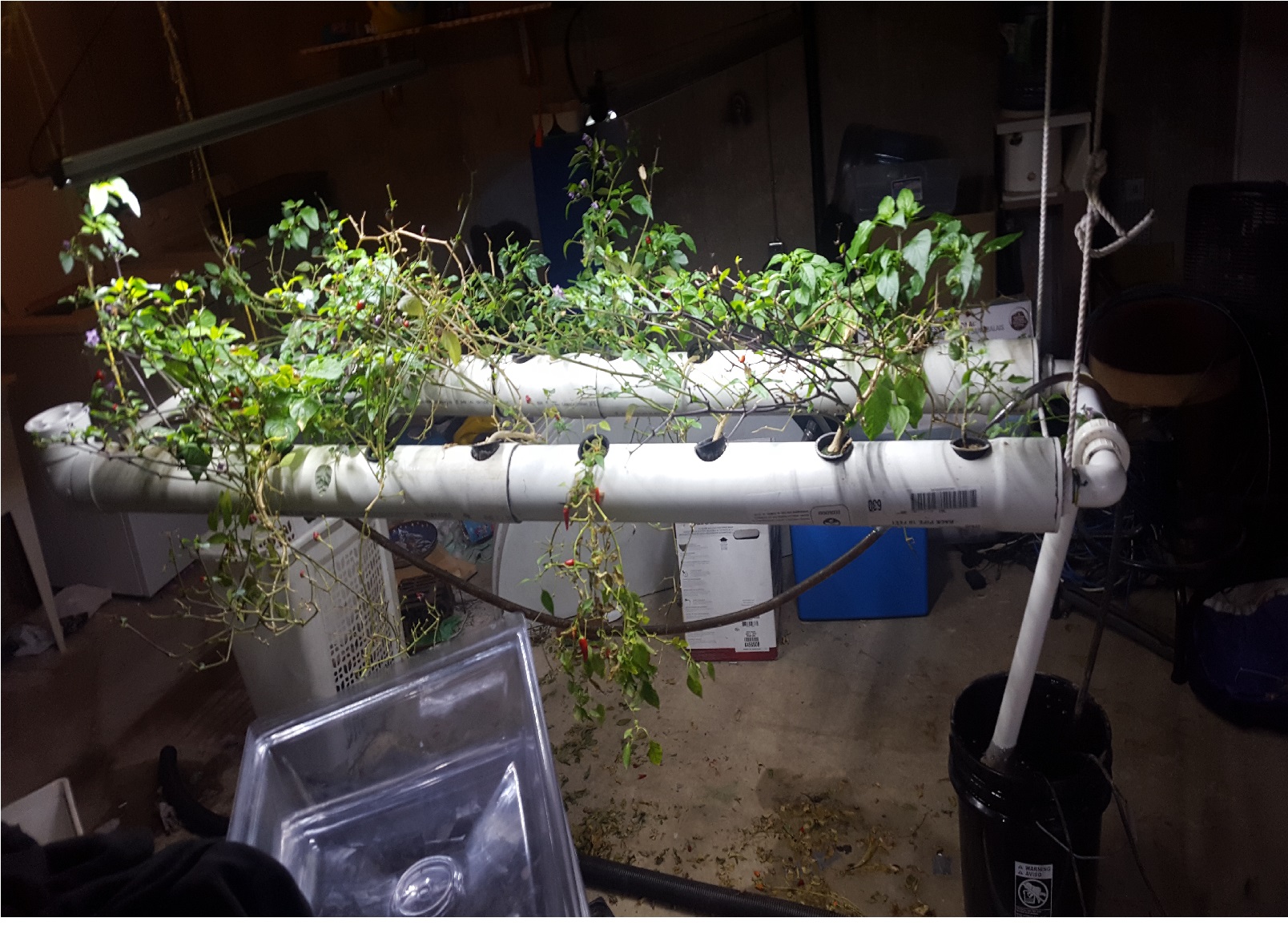

this is another indoor grow with bell and chili peppers ... the photo was of them just transplanted in for the winter(late) so they are looking a little scraggly from the cold ... but they recovered nicely too using 2 of the strip lights ... however after they grew back they could use another light strip in there ... just did a harvest last week and a whole pint of chilies!

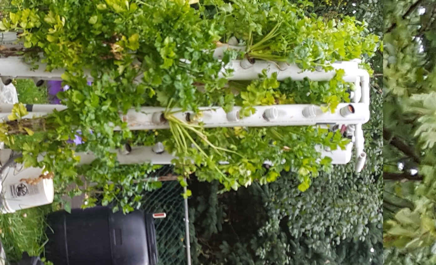

finally here is an outdoor grow of celery! .. this was my first grow ... and my first photo crop
