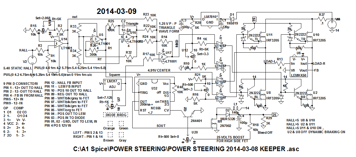

Some of the screen shots and show the difference the transistorized FET drive makes over just a 1K pull up, also is the schematic updated to what I plan to use.
If you down load and run the .asc file, look at TR,TL,BR,BL and in a separate plot IR13, & if you jumper around theLEMHX50, the wave forms look better. I'll take a few more photos to post when I get done with changes.

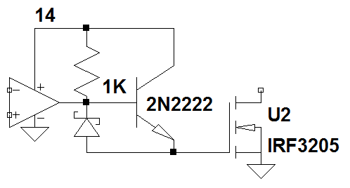

Kinarfi, Well the Mosfet is a Voltage controlled device, but it also has a consideable amount of Gate to source Capacitance.
The More the Capacitance and the Higher the Frequency, than it does require More Drive Current to Offset Delays in Charging that Capacitance and turning on the Mosfet.
In the Last circuit you Posted, you should also have a Gate to Source Resistor. (about 5 to 10K)
Actually I do, they are attached to the FETs, I usually use .125w resistor wrapped under the leads.

I am curious as to why you are not driving your power fets with a common fet or IGBT driver IC set like the IR2113 or such that have built in totem pole architecture specifically designed for high side gate driving at multi 10's of KHz frequencies?
Because I don't know of them and don't have them on hand and at $4.55 a pop, it's a luxury I can't afford, wanna send me a few?:rolleyes::banghead:
and now that you brought the subject up, is the 2N2222 going to be a good driver or is it too weak? I already popped one and fried one on the high side, my hand wound inductor shorted out, popped the quad opamp and the inductor drive FET got hot and I burnt my little finger. :banghead::banghead:

If you dont have any MOSFET driver chips then use two transistors, one PNP and one NPN with the emitters and bases tied together. That makes a much better driver than a resistor.
The 'spike' would be the current when the MOSFET internal capacitance is being charged up. That's part of the issue regarding the correct drive for MOSFET's. If we dont have the spike then we get very slow turn on and/or slow turn off. That spike turns it on (or off) and then we dont need that high current anymore, just the correct voltage level.

Untitled.png IMHO, and in my mind, this is as good a totem, it has the npn of a totem but the pnp is replace by the schottky. If I had a less than 0 potential, then the use of the pnp would be better. As soon as I get my circuit repaired and functioning, I will post some screen shots from my scope.
Being that I am using the 2N2222N, and have had one of the burn up and then in same one (circuit wise) blow up & I can't see any physical causes, (solder traces that short & the likes), so I'm concerned about it electrically.

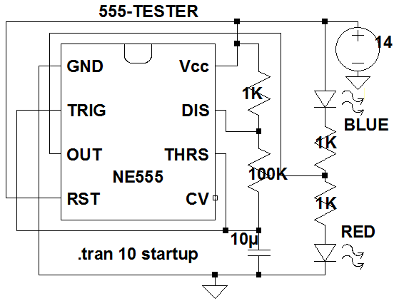

Chemelec, while I was having problems with LM555 in the past, I made a tester to see if they were functional, well I had several of them laying around and decided to make another on and in the process, I could see their value as a FET driver.555 TESTER.png I had a red and a blue LED and used them as the indicators and it makes for an interesting visual que.

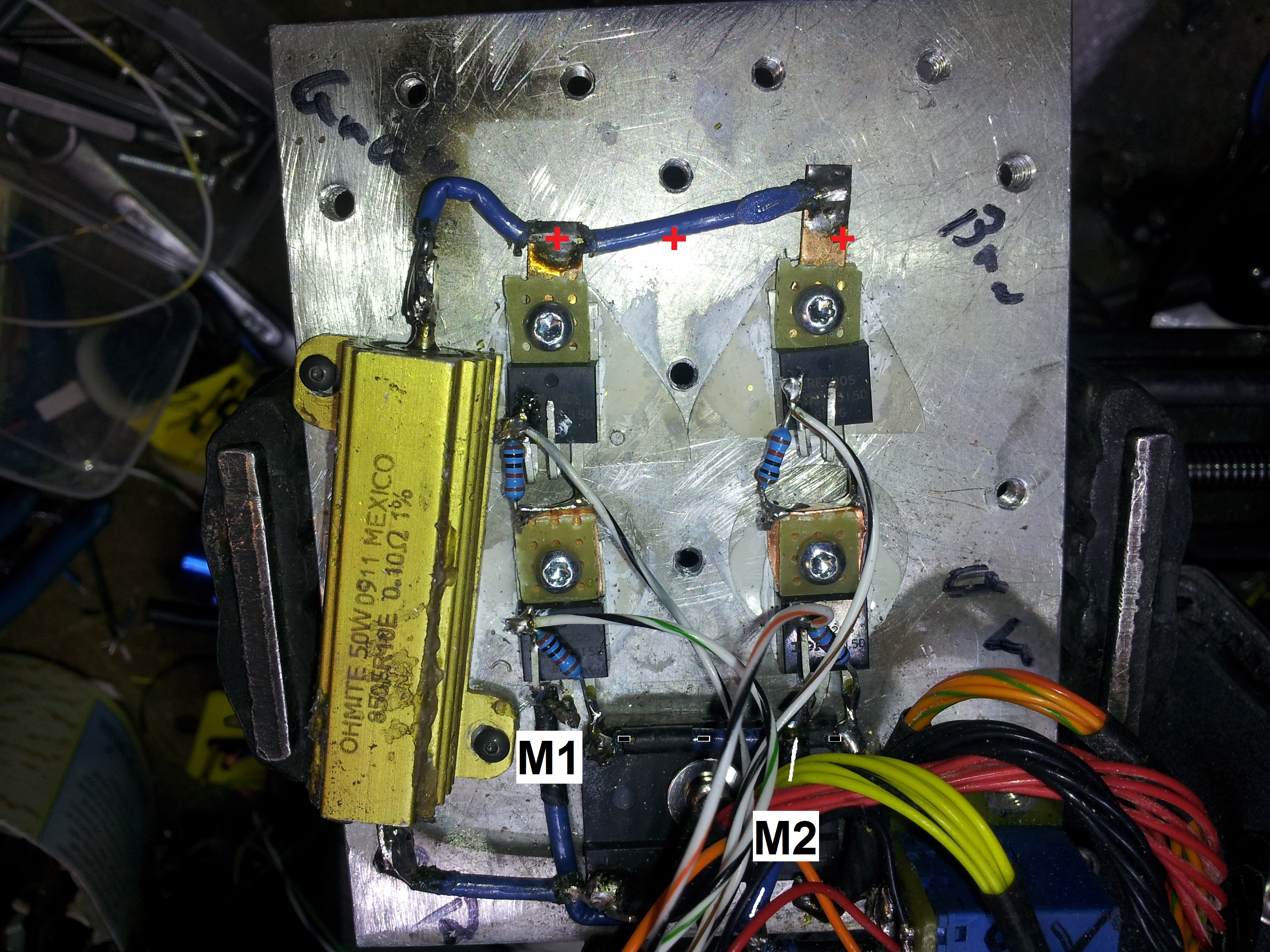

That would be nice, thank you, PM sent, I have some adapters go I can use them, with recent developments, I have been thinking I need to rebuild the circuit board on a bigger board and may/probably move the power FETs outside the control box and on a larger heat sink or sinks.

In the circuit I do have a .1 ohm resistor as an attempt to limit current and the Lem HX50 is a Hall effect current transducers that outputs .0125 volts per amp with a 2.50v center and can measure up to 150 amps in either direction.

Well 0.1 ohm probably is not enough resistance, but it depends on your source voltage. If your motor can draw lots of current at 12v then at 12v a 1 ohm resistor for example would only limit current to about 12 amps, and then it would have to be high power rated. So it may not work as good as you want it to depending on the source voltage and the typical current draw.
If you already have a current sensor and it is fast enough then you can use that as feedback to shut down for a given amount of time like 10 seconds or something like that.
MrAl, Your not thinking large enough, Motor specs, Operating v: 6v - 12v, Nominal v: 12v, Stall Torque: 343.27 oz-in, Stall Current: 133A, Kt: 2.58 oz-in/A, Kv: 443 rpm/V
.1 ohm may be a bit shy, .2 may be a bit heavy, IMHO. The LEM transducer is instantaneous and is being used as a feed back, with .2 ohms and LEM feed back, I was limiting out near 30 amps, then I blew another FET and got on the forum and asked for advice about heat sinking,
I am not sure what you are asking then. Current limiting with a resistor only works in certain situations, and if you have the current already being measured then there is a way to use that measurement to feed back to a circuit (perhaps another circuit altogether) to either shut down or just lower the current.
A typical method is to measure the current through the transistor itself and shut down if the current goes too high.
