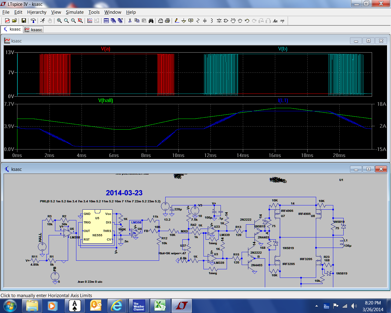

On my last posted .asc, there are 3 halls, you can only use one at a time, the first hall (Hall) starts at 0(5.2), goes down, back to 0, then up and back to 0, the next (Hall 2) is short duration, the third (Hall 3) has a long 0 time in the middle so current can drop to 0 before P2 goes high.

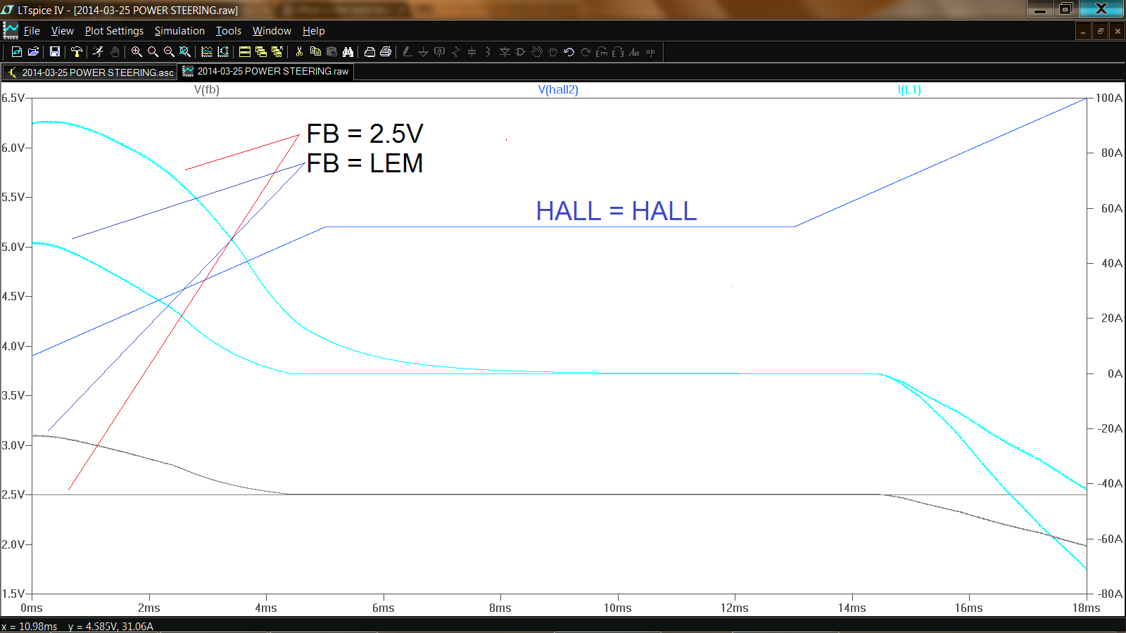

OK, I'm starting to get it. So FB is like something to limit the current to a safe level?
HOPEFULLY
Spent the morning tweeking this, the hall input goes from min to max as if turning the steering wheel from hard left to hard right.
If I am careful in my set up, putting enough dead band in the middle, do you see any problems with 2 drivers, one for P and one for N
It's interesting how the current lags so far behind the FETS, that's why in one of my sims, I had such a long time at 0, 5.2, input

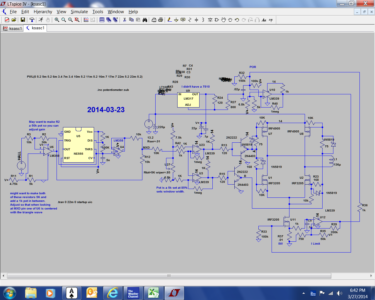

So here is rev 1. I got to thinking about just plugging in a voltage where you had a regulator. Since I don't have a 7810 I used a 317, and sure enough now it needs a power safe circuit like you had in your original. So I added that. Since I think FB is some kind of current limit I stuck in a current limit circuit. It triggers at about 18 amps but is easy to change if more or less is needed. Hope this is correct. The pressure sensitive hall is a neat idea. Do you have a link?
Anyway, I hope you have a scope.
I didn't notice any current lag, but I don't have FB.
Edit
Maybe in a real early one it was because power on reset was active?
Edit 2
Notice I made the cap at the output of the regulator smaller. That's because I was to lazy to rewrite your plw to wait for por. So If you want the big cap after the regulator you might need to make por longer

POR??? I looked at your drawing and I like and will use your current limit,

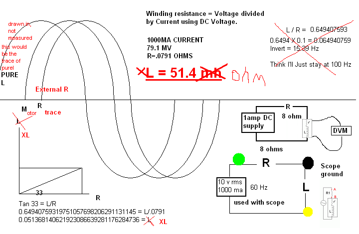

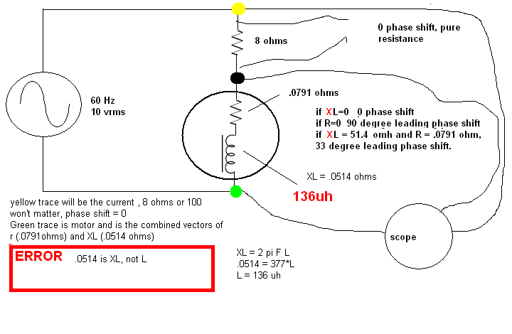

The lag probably comes from the motor being put in aa 136uH with a 0.0791 parallel resistance, you have been using 1 ohm parallel.

Well it's not Power on reset, more like a delay. Should probably add a zener and make it a voltage above 9 volt circuit.
Yea, I saw the low resistance. That must be the locked rotor resistance? I'm hoping the inductance is much higher.

I spent some time and brain cells to get those numbers (.0791 & 136uH) see up loads
Question I used 60Hz for this testing (sine wave), If I try it again with a higher frequency square wave, does the math change?

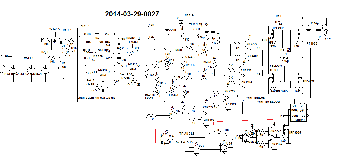

AM I looking for trouble by limiting my current from a PWM circuit with another PWM circuit? they both have the same triangle generator involved.
Changed a few things, a bunch things
