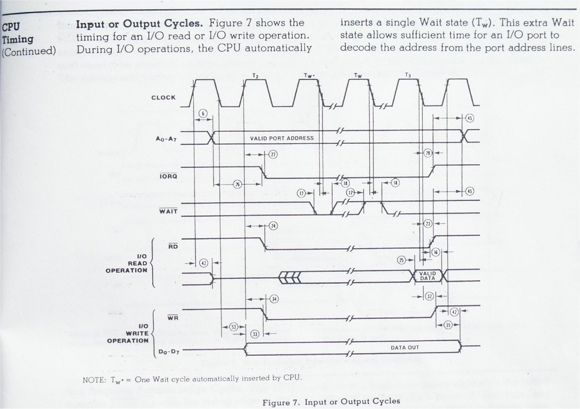

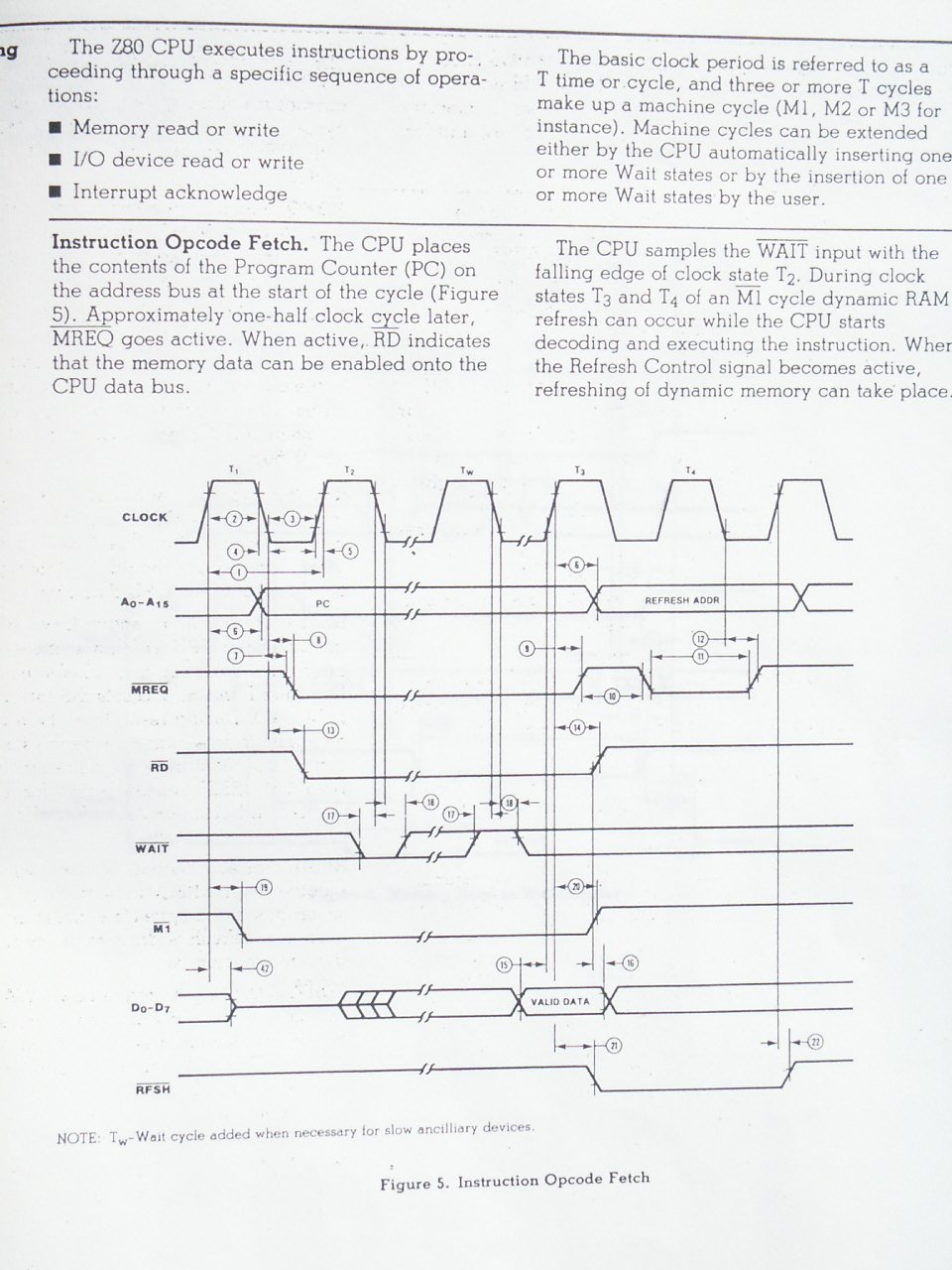

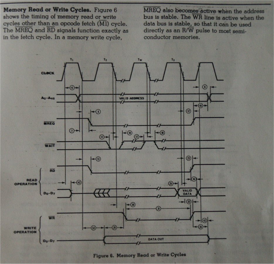

Here are the OpCode fetch, Mem read/write and IO read/write. There are a few more about interupts etc, but we'll leave that for later:

None of that made any scence to me. :( I will do some more research on timeings. I added some more circuitry to it. I will take more pics soon. Probably later today? I don't know. It depends on what i get accomplished. :) Thanks for scanning thoes images for me. :) I will keep looking at them until something makes a bit of sence. I have a question that bugs me, though. How can things be 0 and 1 at the same time? And then why does it make an "X" in some of the timmings?
Think of it as looking at a multichannel scope hooked up the Z80 pins.
When they do that it is because those represent all 16 address lines and the 8 data buss lines. So d2, d4 & d7 could be high on the data buss and the rest low. So they draw it as a don't care or it could be anything scenario. So they draw the high AND the low at the same time and the X at the end. The X just represents the start of another state such as valid data when you transition from say invalid data.
You can ignore the WAIT input line because you won't be using it because modern chips are all quick enough to keep up with the Z80.

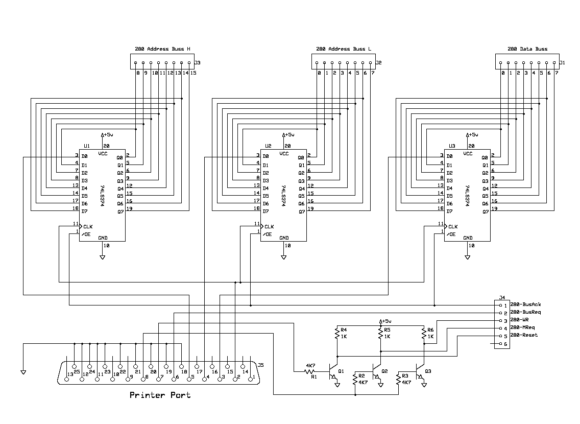

I have managed to build a programmer for loading code into a Z80 system in circuit via the parallel port. I'll post a schematic if you're interested. The software needs alot of work but at least it loads the binary data into RAM now. I don't have an EEprom to try it with, but I'm sure all that'll need doing is lengthening the time between data writes.

I'm having a little problem saving the schematic as a GIF right now. After all that drawing and now it won't save as an image.:mad: :( :mad: :(
I'll post both the software and the schematic once I get that figured out. One doesn't make sense without the other.

Ok, here's the schematic, code and Z80 program (eeprom.txt is the list file from TASM) . The code is in C (eeprom.c) and is compiled as a win32 console application using the free lcc-win32 compiler. In the file eeprom.c, the HEX codes assigned to unsigned char Data[] are the binary codes that get loaded into the RAM on the Z80 board. None of this is finished yet or fully checked for accuracy so don't started building anything yet. ;)
