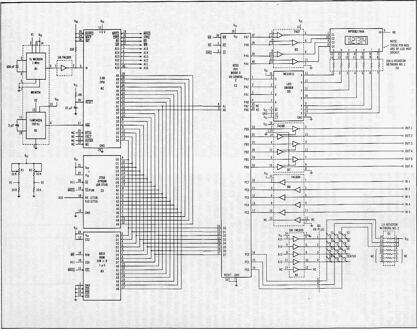

Ok, if you think the Z80 is useless, then what about the 8088? I have one of those. I got it out of a PC XT, along with that DRAM. How about his CPU? I like the sounds of that, but some of the pins are multipurpose. I think they are mulitplexed? I don't know, but a few of the address lines are for addressinga AND data? How does that work? I have the pinouts of the 8088 included.

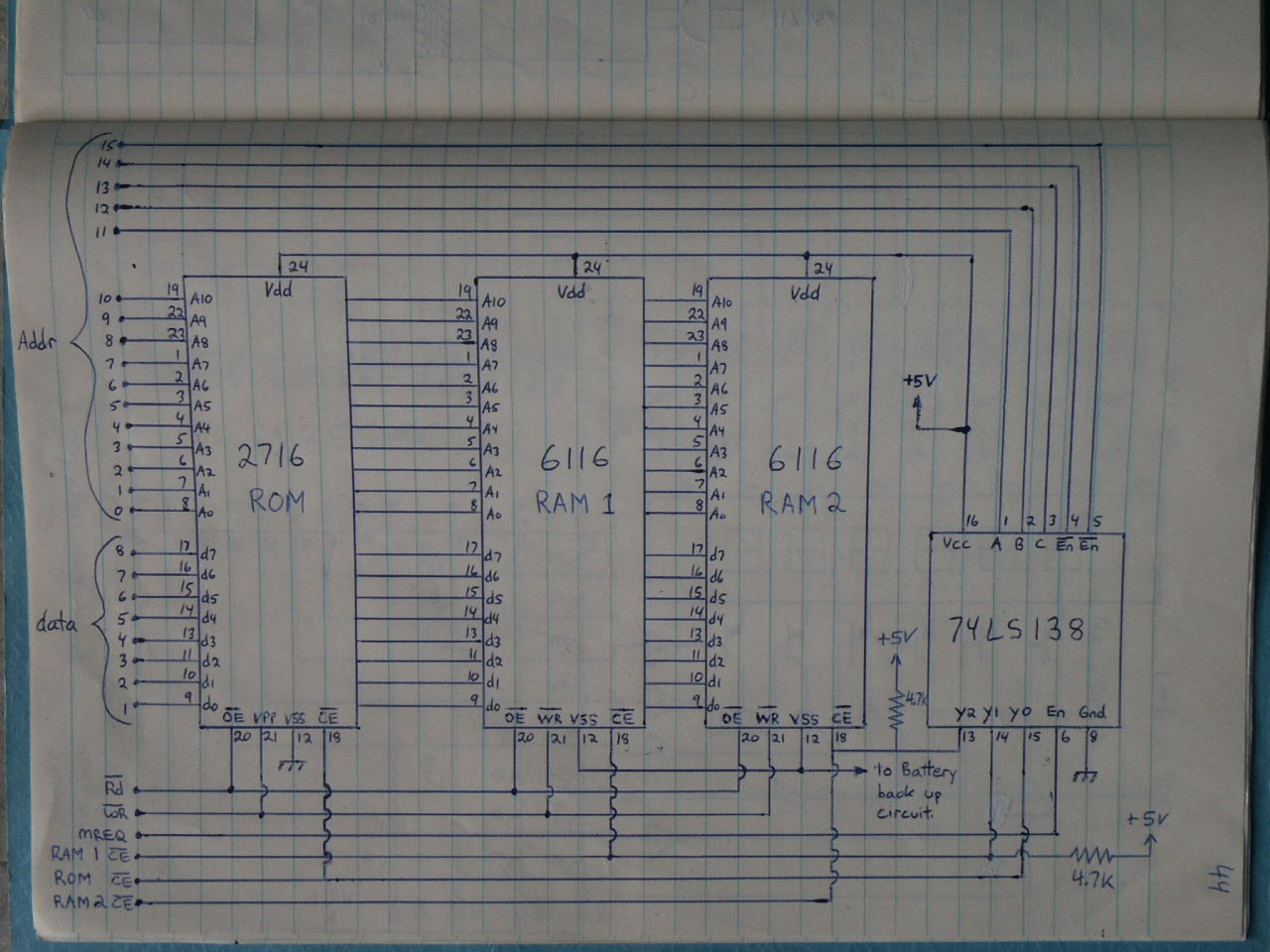

What I've attached below is a drawing of a Z80 project that I did, you guessed it, way back in the 80's. The data and address lines on the left goto the Z80. The RD and WR lines on the left are the read and write lines from the Z80. The MREQ is a line from the Z80 that tells us that the address/data busses are being used for memory operations. It enables the 74LS138 when high and thus allows the memory chips to be addressed.
The Z80 also has a IORQ line that tells us that the address/data busses are being used IO. It is not shown on this diagram.
The memory map of this circuit is as follows:
ROM 0x0000 - 0x07FF
RAM1 0X0800 - 0X0FFF
RAM2 0X1000 - 0X17FF
When the Z80 is first powered up and reset, it will look for the first instruction at address 0x0000 which is in the ROM chip. What happens after that is up to what is programmed into the ROM.

I have a question; What is the syntax of the address "*x****"? What i mean, is, what do each one of the digits mean? Like the number before the the "x", and the 4 numbers that ar after. They are in HEX, right?
0x just means that the 4 digits following it are HEX digits. It is to avoid confusing a HEX number with decimal number if there is no A,B,C,D,E, OR F in it. Like the number 1234. Is it HEX or decimal? You know that 0x1234 is hex which is 4660 in decimal.
And why is there 3 CE lines coming off of the circuit? Shouldn't all be connected?
Besides being connected to the 3 memory chips and the 74LS138, they go off to another diagram on another page (There are 7 pages) to some special control circuitry. For this example we can ignore the special control circuitry.
What is the purpose of the multiplexer?
It is connected to the upper address lines to select the 3 memory chips like this:
When address lines 11-15 are low, Y0 of the 74LS138 goes low and activates the ROM.
When address lines 12-15 are low and 11 is high, Y1 of the 74LS138 goes low and activates RAM1.
When address lines 11 & 13-15 are low and 12 is high, Y2 of the 74LS138 goes low and activates the RAM2
Thus we get a memory map like this:
ROM 0x0000 - 0x07FF

Ahh, i see. But then how would i control the memories without that circuit? Also, are thoes SRAM or DRAM chips?
It is actually the 74LS138 which controls the special control circuitry as well as the memories. ie: data flows out those lines to the other page, not in.
They are SRAM chips. I don't think you'll be able to find the same chips I used because they are really old and dated now. Who wants 2K RAM chips these days? :rolleyes: Just get a 32K one and a 32K EEPROM and you'll have the whole Z80 address space used up. Even those may be hard to find.

Anyway, I've scanned the EZ80 circuit for you, it should (hopefully) allow you to see how a simple Z80 circuit looks, and stop all your silly questions relating to it? :p :p :p
Ooh! Thank you so much! I really appreciate it!
Nigel, that is a nasty trick they use to scan the Keyboard Rows via the upper address lines! :eek: First I thought they were just using the IO addressing to scan the rows, and then I realized that IO transactions only involve the lower 8bits of the address buss.... Hmmm... Must be some undocumented function. Ahhh! I figured it out. They are using the Memory mapped IO probably with the LD (0x????), A instuction. You made me dig out my old dusty hardcover paper Z80 manual. :rolleyes: Now look what you've done!:D
