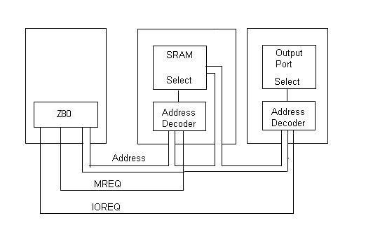

Decoding is the key.
Here is a block diagram of one of many address decoding schemes.
The address decoder is the logic that determines whether a chip will be used or not. Its input is some or all of the address lines. It can be combined with a memory or I/O request signal. I show the requests signals as extra inputs to the decoders. Its output is the signal that will be connected to a chip's enable/select pin.
Chips that are designed to interface to microprocessors have at least one signal called "chip enable" or "chip select". When the chip is enabled or selected, you can write data to it or retrieve data from it.
Decoding can be as simple as a single address line. Or you can decode with NAND gates. Another scheme is to use a decoder chip (see kchriste's schematic) to get multiple select outputs. Some chips have multiple enable/select inputs (see RAM chip in Nigel's schematic), which means they can do some or all of the decoding.
If the Z80 can address up to 64k of memory, and i have 32k of ROM and 16k of RAM, then ROM will have the addresses 0x0001 to 0x7FFF, and ROM will have 0x8000 to 0xFFFF, correct?
Not exactly. Decoding determines if that will be true or not.

But i don't understand how i can address other hardware. If i want to address a certain chip, then how do i know what it's address is?
It is determined by how the address is decoded. Lets say, just for this example, you have 16 equal sized (4k) memory devices that you want to interface on the Z80 address buss. This would make them 4K memory devices maximum because 64 / 16 = 4.
Ok, so what you do in your mind is split the Hex digits that represent the address buss into two parts:
0xF000 + 0x0FFF = 0xFFFF
1st         2nd     entire thing
The upper digit controls a 1 of 16 demultiplexer. It will select one of the 16 memory devices. The lower 3 digits select memory within the device selected by the demultiplexer. For example:
0x1ABC will select byte number 0xABC in memory device #1
0x2ABC will select byte number 0xABC in memory device #2
0xAABC will select byte number 0xABC in memory device #10
0x1678 will select byte number 0x678 in memory device #1
and so on...
The same basic rules apply for accessing IO or Memory mapped devices. The only difference is whether the Z80 exerts the MREQ or the IOREQ line which are tied to the correct address demultiplexer ( One Demux for Mem and one for IO devices).

Aah-ha! I get the addressing now! The demux will chose what chip has access to the busses? So while one chip is active, then the others are all in the high impedance state? Ok. :)
The only thing i still don't understand yet, is how to select memory or i/o. Should there be another mux/demux? Would i connect the enable lines of the demux's up to the to the MemRQ and the IORQ?
Yes, exactly like that; connect the enable line of one demux up to the to the MemRQ and the enable line of the other to the IORQ line from the Z80.
