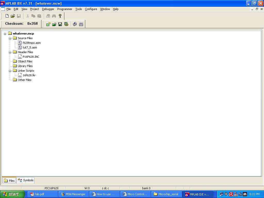

I checked ur tutorial on how to do rs-232. Ive tried to build the project in MPLAB and got the following error
PLINK 4.02, Linker
Copyright (c) 2006 Microchip Technology Inc.
Error - section '.config' type is non-overlay and absolute but occurs in more than one input file.
Errors : 1
It's my first project in MPLAB. I checked the tutorial I added the following files:
Header files : PIC16F628
Linker scripts: 16f628.lkr
source files: f628tmp.asm + tut 7_5.asm
this how my work space looks like:
thnx for ur continous help
Can't help you with MPLAB, I never use it, but the assembler MPASM (installed along with MPLAB) will assemble the file.

perpetual_dream,
I think you have to get rid of the linker file. Isn't your code done in absolute, rather than relocatable mode?
Regards,
Robert
No, it gives me an error whenever i remove the linker file.... it can't be compiled... It's my first project in MPLAB as I said I don't know how stuff goes... but I read the tutorial and it says it needs the source header and linker files.....

perpetual_dream,
I just downloaded the tutorial, created a project in MP Lab, and assembled it. I didn't use a linker file, and the project assembled on the first try. How did you create your project? Over.
Regards,

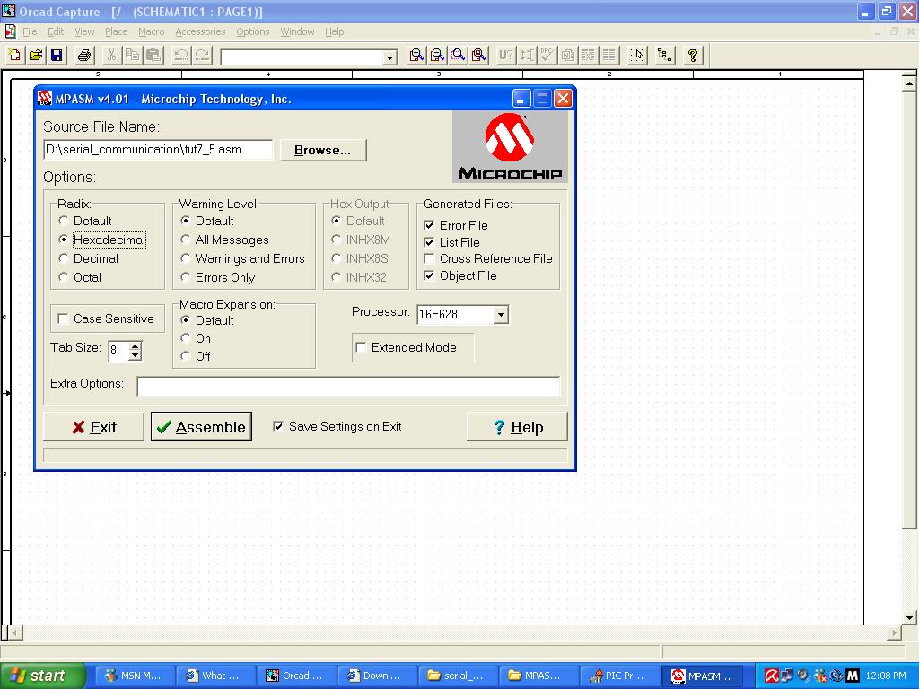

I write the source using a text editor, and save it to hard-disk with a .ASM file name. I then run MPASMWIN and load the .ASM file, click on 'Assemble' and it produces a .HEX file I then load into WinPicProg. By selecting a 'tick box' on WinPicProg the last operation becomes automatic after the first time, once the new .HEX file appears WinPicProg detects it, loads it, and blows the PIC.
I've NEVER used MPLAB, nor seen any reason to? - but I come from the days when all MicroChip tools were DOS only!.

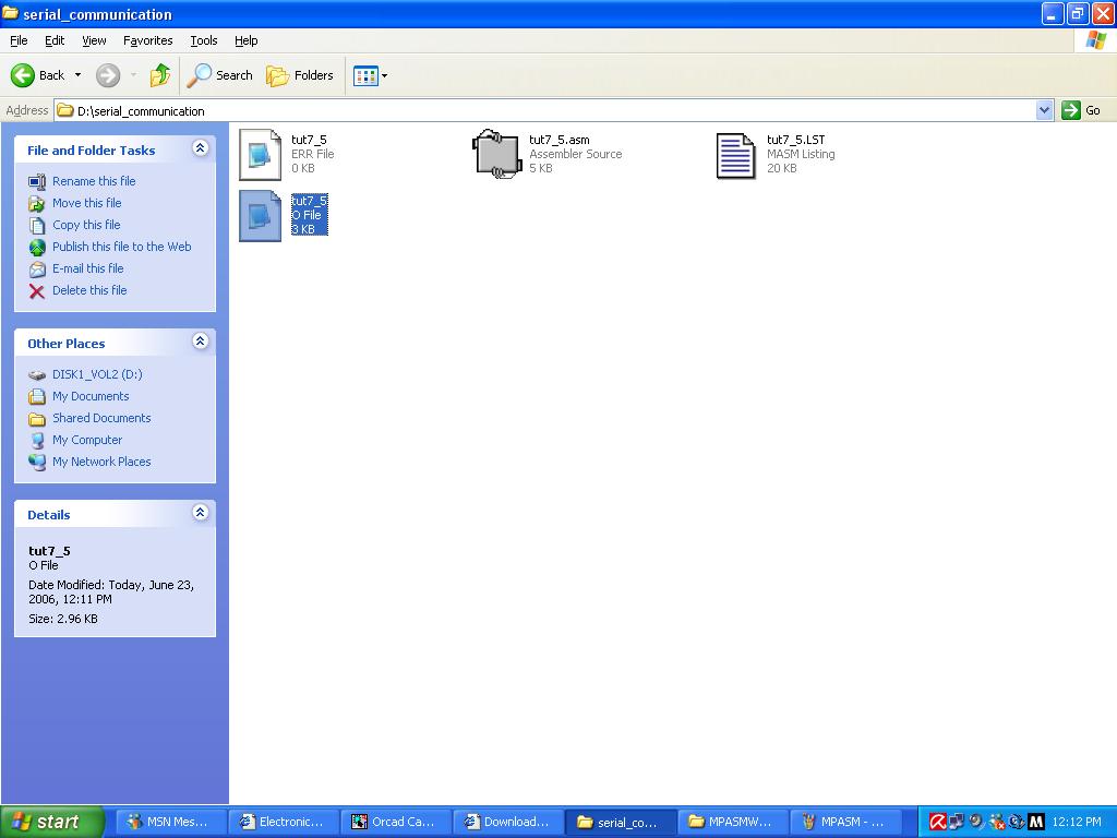

OK... I know Ive asked two many question... I've done the following...
I ran MPASM... I Loaded the file... I checked the HEX radio button and I chose the list and object files as the generated files and pic16f628 as the processor and clicked on assemble....
I am left with the generated files in the attached image.... object file and a list file...
I went to winpicprog and tried to open the object file but it just can't detect... I'm lost somehow... what am supposed to do 2load the code in the microcontroller !
THNX a lot nigel... I really really appreciate ur help

I don't have 'Object File' ticked on mine, the file you're looking to load in WinPicProg ends in .HEX
akg said:
and where is the .hex file?
In the same directory the source code was - assuming there wasn't an error generated, in which case you don't get a .HEX file.
