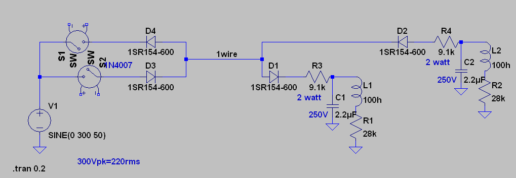

What Capacitor to use in this half wave rectifier circuit to encode signal?
As a mater of interest, what would you-all do if you wanted to control more than two relays via one wire?:D
spec
Hi spec,
If "C" is a smoothing capacitor it can't work when both switches are closed as there will be AC across it. An alternative to a capacitor across the relay coils would be a diode across them (For R1 the cathode to the bottom end of the coil.) The coils would probably have enough inductance to maintain the current via the added diode during the unpowered half cycle.
Les.

Hi spec, If "C" is a smoothing capacitor it can't work when both switches are closed as there will be AC across it. An alternative to a capacitor across the relay coils would be a diode across them (For R1 the cathode to the bottom end of the coil.) The coils would probably have enough inductance to maintain the current via the added diode during the unpowered half cycle. Les.
Nice analysis Les,
So you spotted the obvious flaw in my circuit. :banghead:
Back to the drawing board (note pad).
spec
I have had some more thoughts about this relay. I have never seen a relay before that is rated for both AC and DC so I was wondering if this is just a DC relay with a bridge rectifier built into it. Also calculating the value of a smoothing capacitor would not just calculating the value so it did not discharge much over half a cycle. The capacitor would charge to near the peak voltage of the mains supply. (240 x 1.414 = 340 volts) Some allowance would have to be made to the value to allow for this.
Les.
