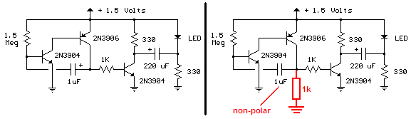

Better you use a transistorised astable multivibrator with NPN & PNP transistor and a POT in series with feedback Capacitor. This is the cheapest circuit and the simplest one.
Use left npn biasing resistor as 1m, pnp collector res 1 k, feedback capacitor (1-10uf) & pot 220e to 1k. Use led biasing resistor as per supply & led current.
The wrong supply and the supply node is emitter of PNP transistor. Please excuse me as I draw in hurry.
Bill bowden has almost the same circuit except it has a voltage doubler so it works from a single 1.5V battery cell:
