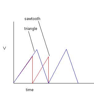

what are different of triangular wave and sawtooth wave ?
Bascially its the rate of rise and fall....voltage versus time...See my sketch
