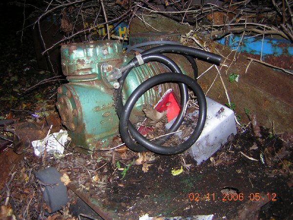

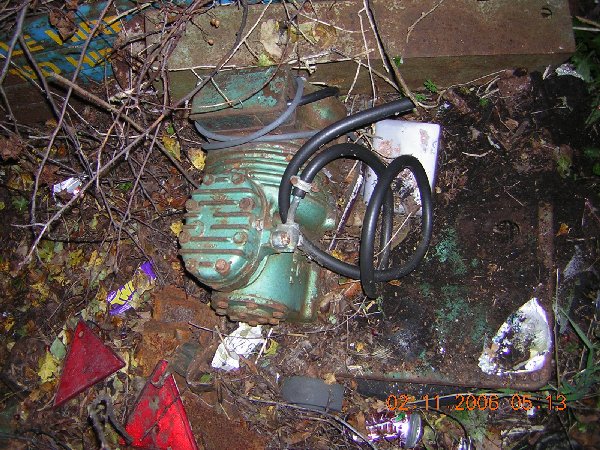

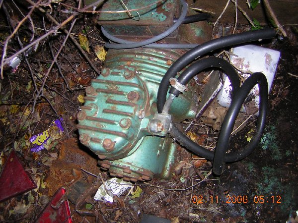

Hi Alternety,
Ive just been out into my garden, to look at an old 'Fridge-pump' that
i thought was still there. It is still there, i took a couple of pics
just to show you what they look like.
They are sort of a 'sealed' unit, at least on the pump side of the
unit. On the motor side, its a brushless motor, and pretty much sealed
but not as well as the pump side of the unit which contains its own
oil-bath and does not normally meet the external environment.
This particular unit has been sitting around in the dead leaves in the
garden for a long time, if i wanted to use it, i would clean it down,
check the motor over with a meter, and i would expect it to run.
And i would expect it to operate.
They are very hardy little units.
This one was picked up from a skip ( i think Americans call them
dumpsters ? ) and used for a while, then put to one side.
The pictures are just in case you don't know what i am talking about.
Best of luck with it, John :)
