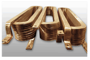

Actually you will find a lot of the higher end welder transformers are wound with flat, square, or rectangular windings instead of round windings.
Flattened winding gives the most surface area per cross sectional unit which helps with cooling. ;)

Theres a term for flat windings, just cant remember it.
Not exactly easy for diy, but it does help heat dissipation.
Copper flashing is one of the most common types of flat copper sheet on roles.
These guys probably have what you are looking for.;)
Edgewise, thats what I was thinking of, see the pic below, its just a fancy name for bending the copper around the thinnest side to get the most on the winding.

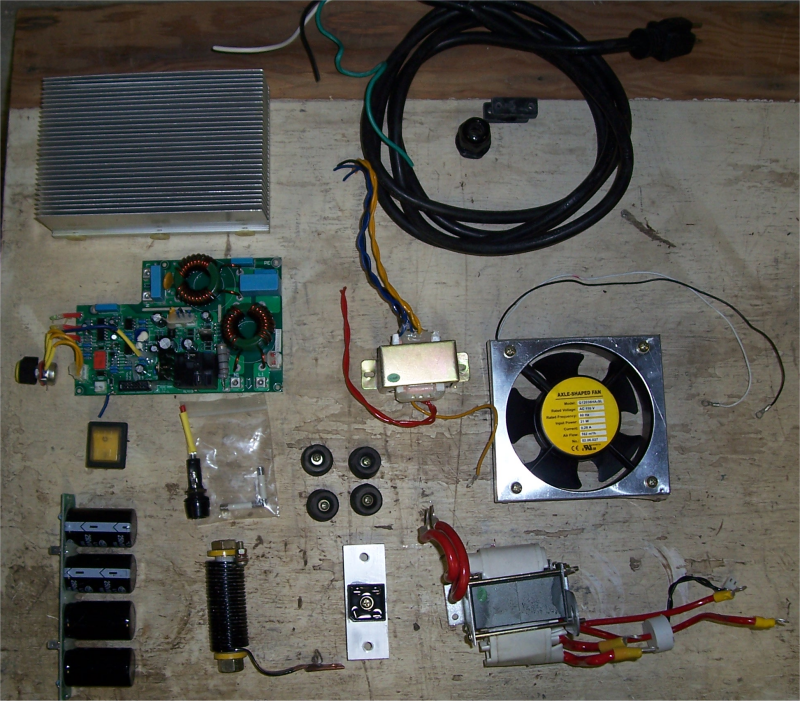

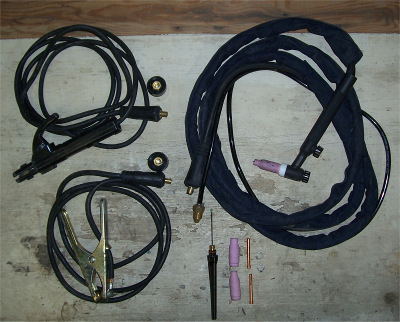

Last weekend I found a broken Tig/stick inverter welder at the flea market. Paid 30$. When I bought it, I was thinking that I could fix it and get a good machine for next to nothing. But I did not check it very much and when I arrived home I realized that it was Mastercraft welder, a brand from the Canadian Tire stores.
To make it short, I just despize this brand and I don't want any electric Mastercraft tool in my shop. This welder is a good example of wy I despize the brand. It is only 4 years old (the boards are dated Feb. 2008), the inside of it being immaculate making it very obvious that it has not worked a lot before dying. Do you think that the guy who bought it new had a good deal? Less than 4 years later, about only good for recycling! As I saw in the web It was selling for around 500$ at the store before being discontinued.
I decided not to try to fix it.
Here are the parts that I salvage from it (missing one board on the pictures).
I will use some of these parts for my MOT welder. With just the welding cables I am happy with this deal.

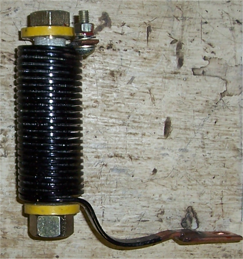

There is this part; is this what is called an inductor? Could it be used in my welder?

That could be an inductor but might be a resistor, or an inductor designed with a specific resistance.
Do you have a schematic of what circuit it was used in?
No, I don't have a schematic. It would be dreaming to think that it is possible to get one.
This part seem to be just 23 turns of flat copper 1/4 inch by 1/16 with a big steel bolt in the middle. The bolt is isolated from the copper by a fiberglass tube and 2 rubber washers. No noticeable resistance seen on my multimeter.
One side of this part was directly connected to the positive plug of the welder, that is where you connect the exterior welding wire. The other side was connected to one of the 2 boards.
Its the reactance coil which is basically just a big lossy inductor hence its low tech design and yes you could use it in your welder.
I would be curious to see what influences it has on the weld puddling effects.
Inverter sets dont really 'need' and inductor to smooth the arc, that device is probably meant to prevent hf noise from getting onto the output leads.
I know its a killjoy thing to say however it probably isnt gonna be a high enough inductance to make much diffo in your circuit.
