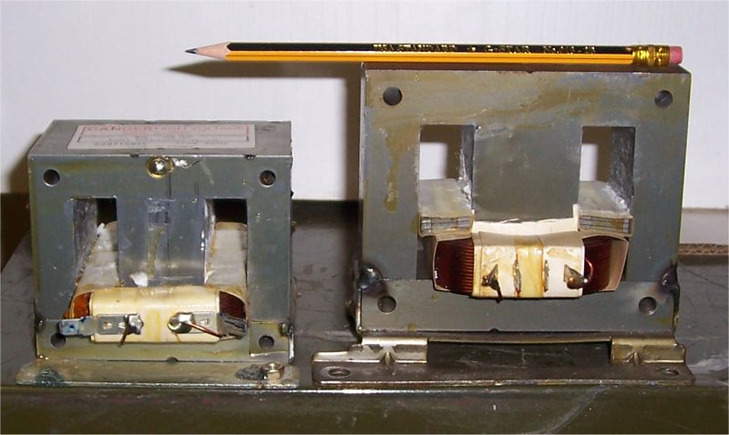

Here is a newer MOT compare to an older one. Even with the shunts in place there is (I think) more room in the older one than in the newer one with the shunts removed.
2mot-png.73599
Are those both from the same wattage oven, if so theres a big diffo in size.
Unfortunately, I can't tell. I did not check that. Next time i'll get an oven as a donor I will check the wattage but also I will salvage more parts. There is so many nice things inside a microwave oven.
Alain can you measure the width and height of the gaps and the distance between the gaps on both transformers, in metric for me? I'm curious to work out the math my minds eye says that the newer one even with the shunts on it has substantially more winding room.
The wire gauge of what you're going to wind the secondary with is required as well, if you don't mind. If it's anything other than enameled wire you're wrapping it with measure the insulation thickness as well.\
For the small one, without the shunt the free opening is 15 mm by 32. The shunt is 5 mm and the distance between the 2 openings is 32 mm.
For the big one, the opening is 20 by 40, the shunt is 8 mm and the distance between gaps is 40 mm.
