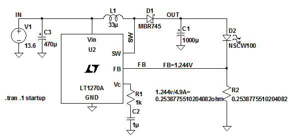

I need to power up a led strip with 36V at 4.9A.
I have a computer PSU that I can use to AC-DC but the output is 12V, 18A. So the question is: how do I convert 12V/18A to 36V/4.9A?

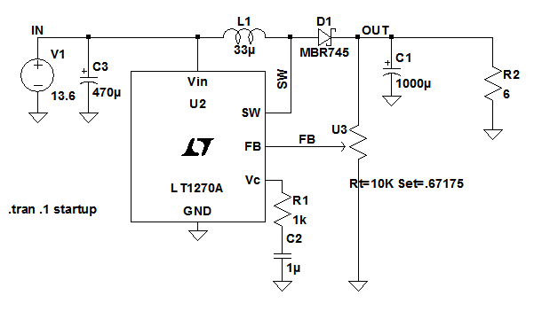

However, if you do need to convert 12 volts to 36 volts, this circuit will do it. I use the design in untitled1.png to charge the battery in my computer from 12 volts when away from home
