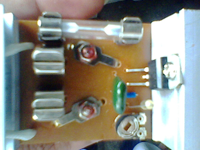

i have a 1600w voltage convertor.it has a variable resistor of 250k in it that controls the output ranging 6-155 V AC. the convertor was made for 110V AC .i wanted to set variable resistance for an output of 12V AC.now can anybody tell me wether it will work to provide 12v AC and a current of approximatly 35-40A.form that output voltage , i want to operate a car audio amplifier to derive a 200 W sub-woofer.is the whole plan possible?

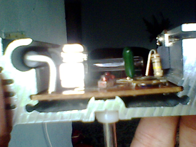

i dont know the type of supply so i am uploading pictures of supply
the transistor used is a BTA16
Looks like a standard phase controlled lamp dimer type to me.
The 1600 watt ratting is its maximum power at the line voltage so at 110 volts thats around 14.5 amps. That would likely be its working current limit at all voltages but I would never trust one of those to directly drive a amplifier at 12 volts output. :eek:
For an 12 volt audio amplifier power supply a good old battery charger of the right size with some good filter capacitors works rather well though. I have done it many times. ;)
