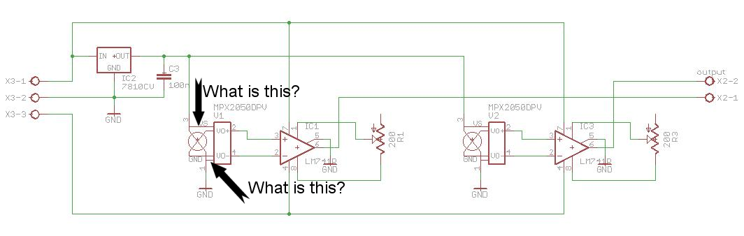

I poseted here the circuit of the sensor with the amplifier . I didn't have the package of the INA114 in Eagle so I put the LM714.
Thank you :)

Good practice calls for decoupling caps 0.1 uF on the IA power pins. I don't see any. Also in your schematic I don't understand what I have marked up?
So you want to add some .1 uF caps on each IA pins 7 & 4 to Gnd as shown in the data sheet also see Figure 11 page 12 of the data sheet. That is how your transducer should be connected.

I am working no with this circuit and it gives me a good results... But no I have an other problem!!! I put it in a new topic.
