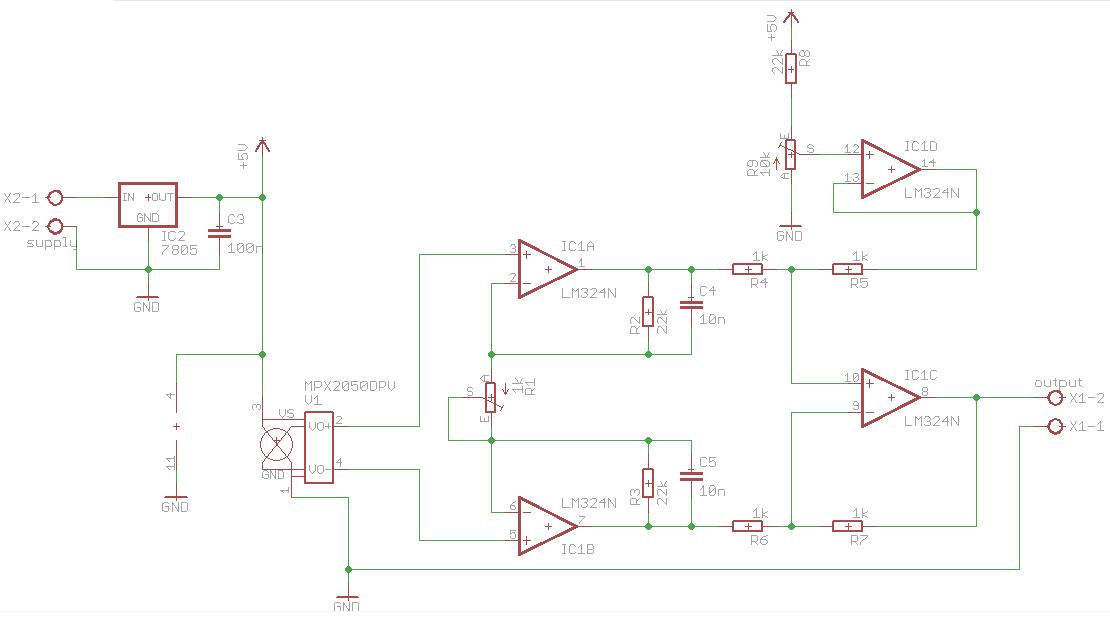

I have an other question now:
I have designed an amplification circuit for amplifying the signal received by the pressure sensor signal MPX2010DP.
Given that the output voltage must be between 0 and 3.3V, is that I can use this circuit?
You find this circuit in the attachment.
Thank you
Yes, you can use that circuit with changes to the gain but using the LM324 configured as an Instrumentation Amplifier is really a poor choice. When doing a circuit like this all of the resistors should be 1% precision film resistors or better. They need to be matched perfectly or you will have all sorts of gain and offset issues as well as temperature coefficient problems. You would be asking for problems. The LM324 is a pretty old chip and never intended for IA circuits. Personally I wouldn't do it.
A much better choice that will eliminate the problems I mentioned would be a chip like the INA128 which is an instrumentation amplifier designed for exactly what you want to do. All you need to do is add a single gain resistor and the use of a good quality 1K Ohm pot will get you there. This will make for easy and accurate calibration using a 1K 20 turn pot. The INA128 is very, very common and very inexpensive averaging between $9 and $11 USD depending on flavor.
Based on your application the MPX2010DP is a better choice as long as it affords the range you want.

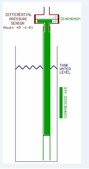

I will now try to capture the water level in the tank (30cm) with MPX2010DP. I have the amplifier INA114.
I am now designing the conditioning circuit of the sensor. The output voltage must be between 0 and 3.3V.
I hope to have a mesure linear with the change of the water level.
Best regards.

Should work just fine. Let us know how things go.
Ron
Mounting the pressure sensor like that is a really bad idea.
You already have a very small depth of water (30cm max) to give pressure head.
Using this method, the pressure will be (30cm - water column in the tube).
The sensitivity will be greatly reduced.
As the temperature changes, the volume of air in the tube will change, this will change the height of the water column in the tube and hence the indicated pressure.
To use this sort of measurement technique you need to feed air into the top of the tube to displace the liquid from the tube.
That way you get a true level measurement.
Try googling for "bubbler tube level measurement" for mor information.
Otherwise, you need to mount the pressure sensor so that it is below the bottom of the tank and in direct contact with the liquid.

The temperature is every time 25°C...
I try to find a solution for my project following existing equipment or equipment that I can provide.
So I try to have a good mesure with the pressure sensor MPX2010DP and INA114 instrumentation amplifier. I hope avvoir a good result.
Otherwise I'll try to look for other solutions ...
