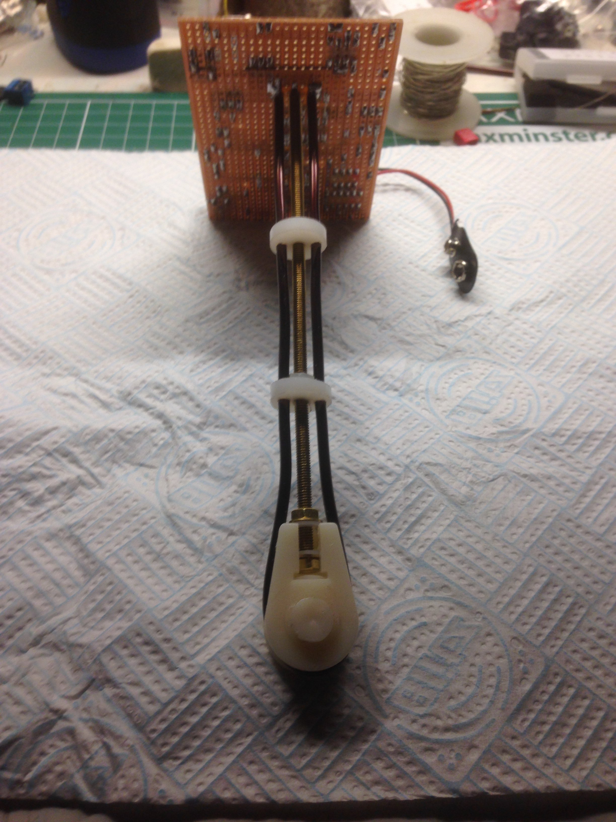

I need to keep track of water depth from 0 to 100mm (4") in a container. Initial calculations show that a pair of 100mm square conductors placed 5mm apart will vary from approx 20pF to 1.4nF. There are designs on the net that will measure capacitance down to 20pF - See The second circuit here. I'm thinking of laminating aluminium foil so it's water proof and 3D printing a mesh to keep the separation fixed. I don't really care how accurate the measured capacitance is, just if I can calibrate it to give a reasonable reading of depth.
Anyone any thoughts on this approach? Is there an easier way - not float switch. At what separation will capillary action become a problem?

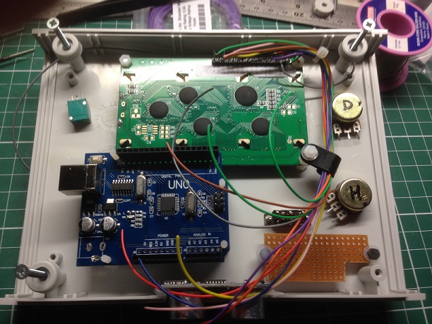

I had a brief foray into depth gauges last year when I was trying to measure the contents of our IBC's.
I made two differing models .. Probe 2 is a capacitance probe which is linked to a moving coil meter which worked OK; however, since the liquid content of the IBC's was a form of soap I ended up using a sonic probe and an Arduino which was much better for our use.
If either of those appeals to you I can look out the details and send them on

The capacitive example I showed above as 'Probe 2' is closely based on the experiments that JimB has detailed and works very well, is quite accurate and easy to use.

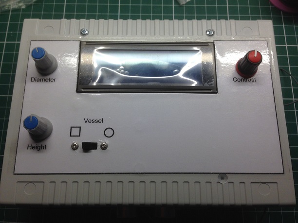

The only reason for opting to use an ultrasonic device (HC-SR04) was that the liquid concerned was actually a liquid soap which got the probe rather messy.
Would you typically submerge the ultrasonic depth sensor pointing up so it reflects off the water-air boundary? Or have unsubmerged pointing down so it reflects off the air-water boundary?
The device was built into an ABS enclosure which was wide enough to span the screw cap air vent on the top of the IBC .. ..
The HC-SR04 is not visible on this picture, but it is mounted in the bottom edge of the case.
Temperature variation never raised any issue, but condensation, if the unit was left in situ too long was another story.
