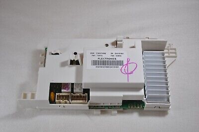

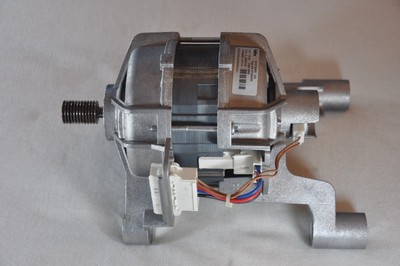

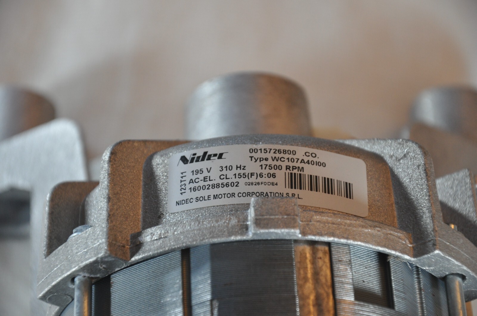

He gives the type number & there are listings on ebay with good photos.
It appears to be intended for inverter drive as it states 195V 310Hz 1750RPM.
The same seller has the motor controller from the same machine; the photos of that show a three phase bridge output stage (three near identical half-bridge sections).
The relevant photos for reference, for when the ebay listings are deleted:

It not only need a high voltage, but a varying frequency three phase AC power system to control the speed.
It's an induction motor, not a DC motor.
They are just not suitable for low voltage operation, sorry.

However if you have the original control board then it should be possible to use this VFD with the original voltage intended for the W.M. , i.e. 1ph 220vac.
