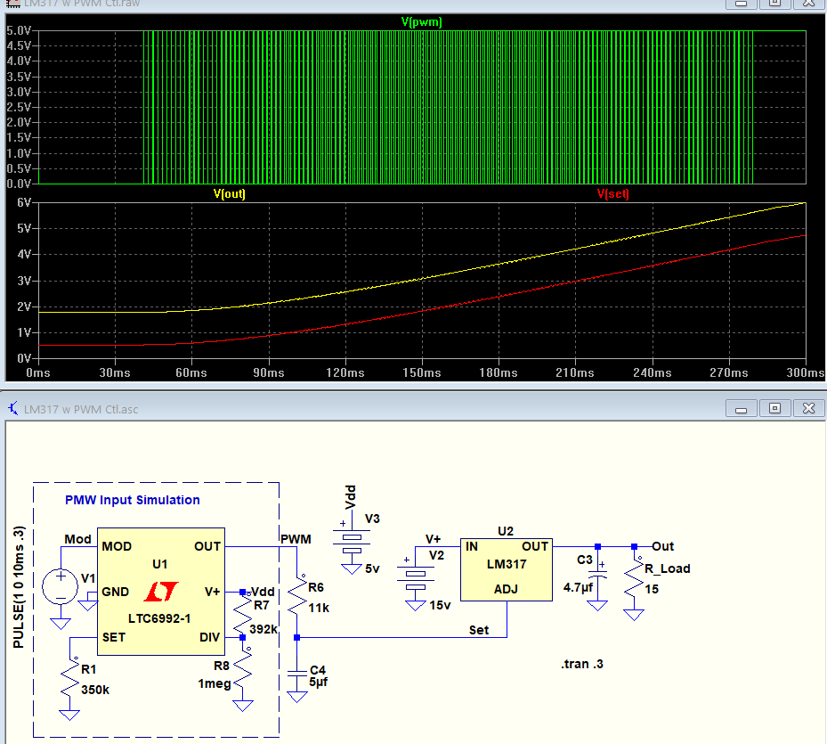

Want to increase or decrease current via Arduino's PWM. What kind of circuit can do that?

I want to charge a NiMH battery pack, using a temperature sensor, and once I'm done fast charging it, wait until it cools down, then top it off with trickle charge for a limited amount of time.
What kind of circuit can regulate current based on PWM? Not constant current by itself: the Arduino would do that via feedback from a current-sense circuit I will have.

Buck or boost converters can - if you google there are numerous suitable charging circuits using Arduinos out there. You should also monitor the battery voltage, which again is easy using a micro-controller like an Arduino.
If you have a current-sense circuit, then you don't need a constant-current circuit, you just need a voltage regulator, such as an LM317, whose voltage is controlled by the P;WM signal.
You then control the current by adjusting its output voltage.
Below is the LTspice simulation of an example circuit:
The maximum output is 1.25V above the peak PWM signal voltage (for a PWM duty cycle of 100%).
You can amplify the PWM signal from the Arduino with a transistor amp if needed.
But note that will invert the phase of the PWM signal.

Interesting.....can you show current through R_Load please?
Here it is (purple trace):
The current is proportional to the voltage, of course.
