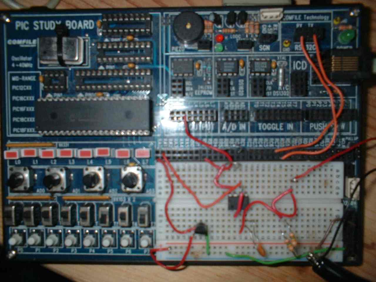

Hi Richard,
I have been doing this kind of thing for several years now, and own quite a few of the Olimex boards, and a couple of the (albeit earlier) futurlec boards. The Olimex boards are NOT bootloaded; they have an ICD2 interface built in, as the newer futurlec boards claim to have. The earlier boards I have from futurlec sit in my junk box, because they were troublesome to program using the futurlec programmers which came with them. Yes, all the LEDs, buttons, and connectors are nice (although they use the cheapest of parts,) but the boards were a hassel to use. The Olimex boards worked fine, even though I had to add whatever switches and LEDs I wanted. I do agree that the small breadboard is useful, but one this size can be added to any board for about $3.
When I first saw the futurlec boards, I thought they would be great, but they turned out to be not so useful. I still like to shop there, they do have some great prices. :D
The board I use most of the time is one I bought in Korea, from a company which no longer makes them. The price was around $60, and I would recommend them if they were available. It looks like this:
Edit: PS, sorry it is a crappy photo! :D
