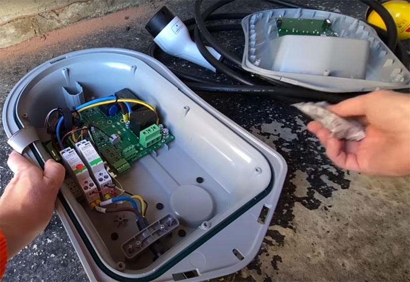

Hello everyone,
I wanted an opinion on an idea that came to me ...
I would like to design and build a Wallbox to charge Type1 and Type2 electric cars ... obviously for educational purposes only ...
Given that I am a programmer with experience in programming ATMEL microprocessors, sensors, displays etc ...
but I have no experience on power electronics and I don't know how to proceed ...
Someone kindly, can you give me links or suggestions of wiring diagrams to follow even basic ones,
which I would then enrich with micro processor display control etc
Thank you.

?? Standard Type 1 & Type 2 chargers have a mass of safety interlocking and monitoring electronics, but other than that pretty much just pass AC mains straight through while enabled.
There is no power conversion, other than a small PSU for the monitor and display part.
One with the lid off in the image below, grabbed from a charger installation video on youtube.
The AC input is the largest green terminal block at the lower right of the PCB.

lol, I though this box contains rectification and switching topolgy for up 800V to charge car battery...
hm, mistake was made
That's all built in to the car system, so it can regulate the power in to the battery.
The Tesla "Supercharger" tye machines may be different, but for home use it's just AC at up to 32A
