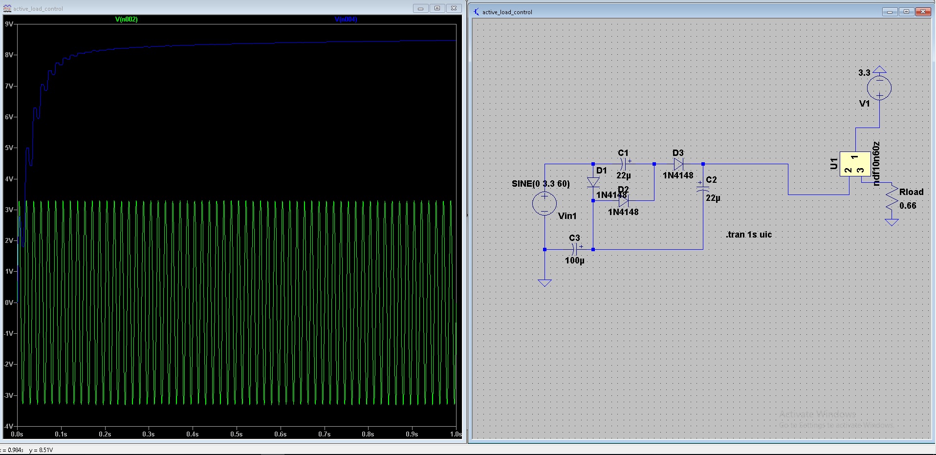

Hi there, I'm having a problem tripling the voltage of a PWM signal, I need to convert 3.3 in at least 9.9V but I'm having a tough time in simulating that in LTSPICE, I can only get it to work for a SINE wave signal and even then the voltage doesn't even reach 9.9V but rather about 8.5V.
What am I doing wrong and is there a way to make this work for Pulse signal?
I'll attach the image of the circuit and result.
Thank you
EDIT: I've realized the voltage wasn't reaching the 9V because I was using diodes that dropped significant voltage while conducting, if I use Schottky diodes the result will be much better. (The question for the Pulse signal remains)

A multiplier circuit of that type builds up a DC voltage and can't preserve a PWM waveform, if that's what you are hoping for.
I don't plan to do that, forgot to mention that PWM signal is supposed to be rectified and transformed into a DC voltage, I was using an RC filter before I realised I needed a higher voltage but if this simulation worked with a PWM signal I wouldn't need that right? The question now is why doesn't it work when I use a Pulse?

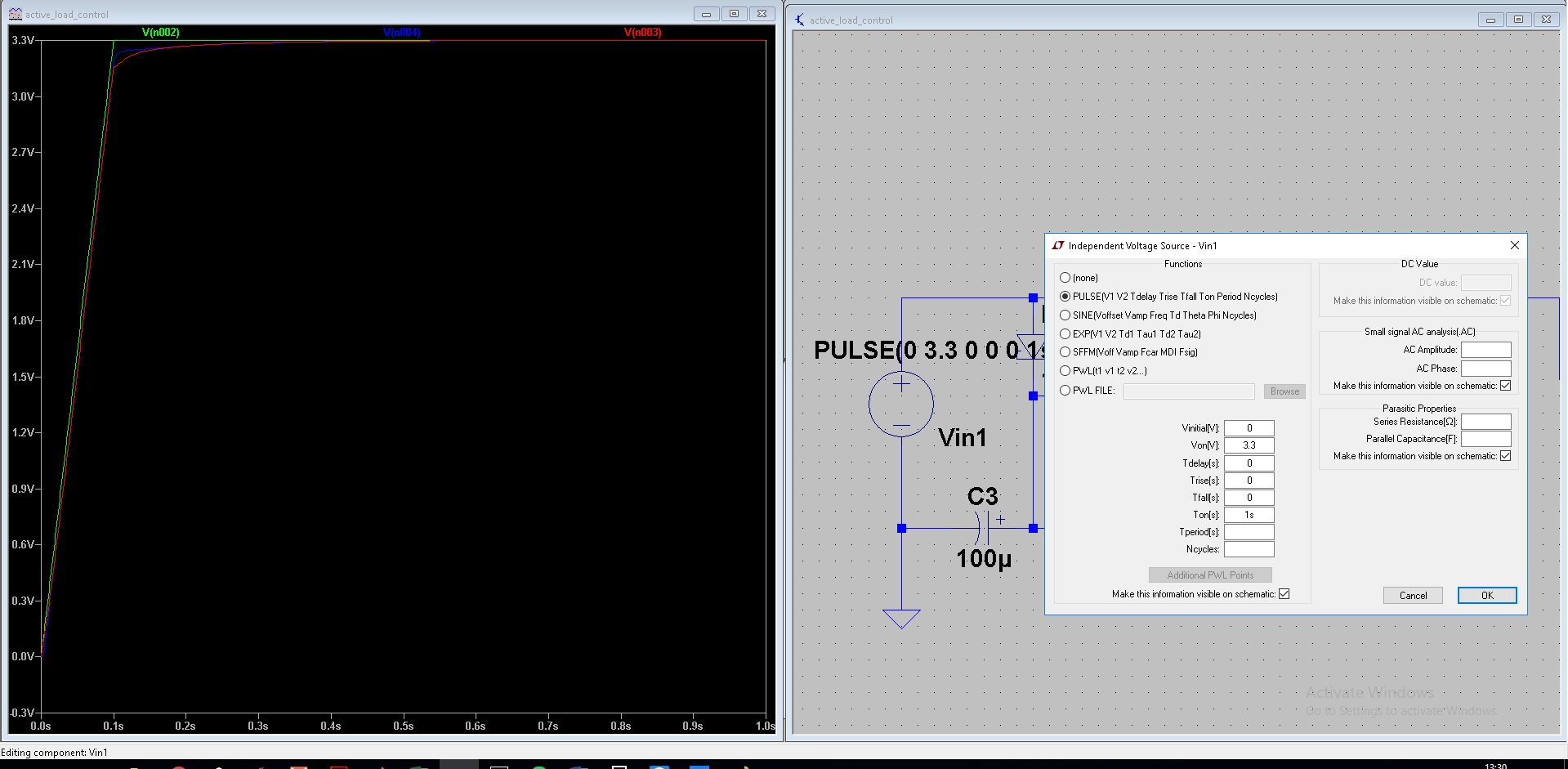

You've probably just got the pulse parameters set up wrongly in the voltage source - could you show us the voltage source dialogue with the settings you're using?
I just configured the pwm to always be on so that he would admit the maximum voltage, I know the rise and down times aren't 0 but for simulation purposes wouldn't it work?
Picture in attachment.

Ah, so there's you're problem. It won't work with DC - an AC (or pulsed DC, between 0V and +something) is required to drive a charge pump like this. Try a 50% duty cycle for a start.
Are you hoping to get a continuously-variable DC voltage (0-10V) by varying the PWM duty cycle, because I'm afraid that won't work (at least, not very well). The trippler will tripple the peak voltage of the PWM, not its average voltage. You will, however, be able to vary the maximum current available by varying the PWM duty cycle so if you load the output with a resistor to ground, you may be able to get the desired effect.

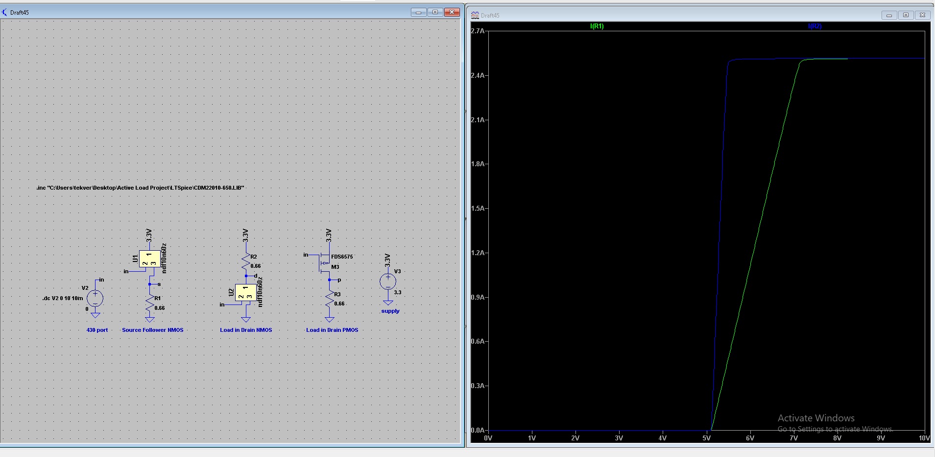

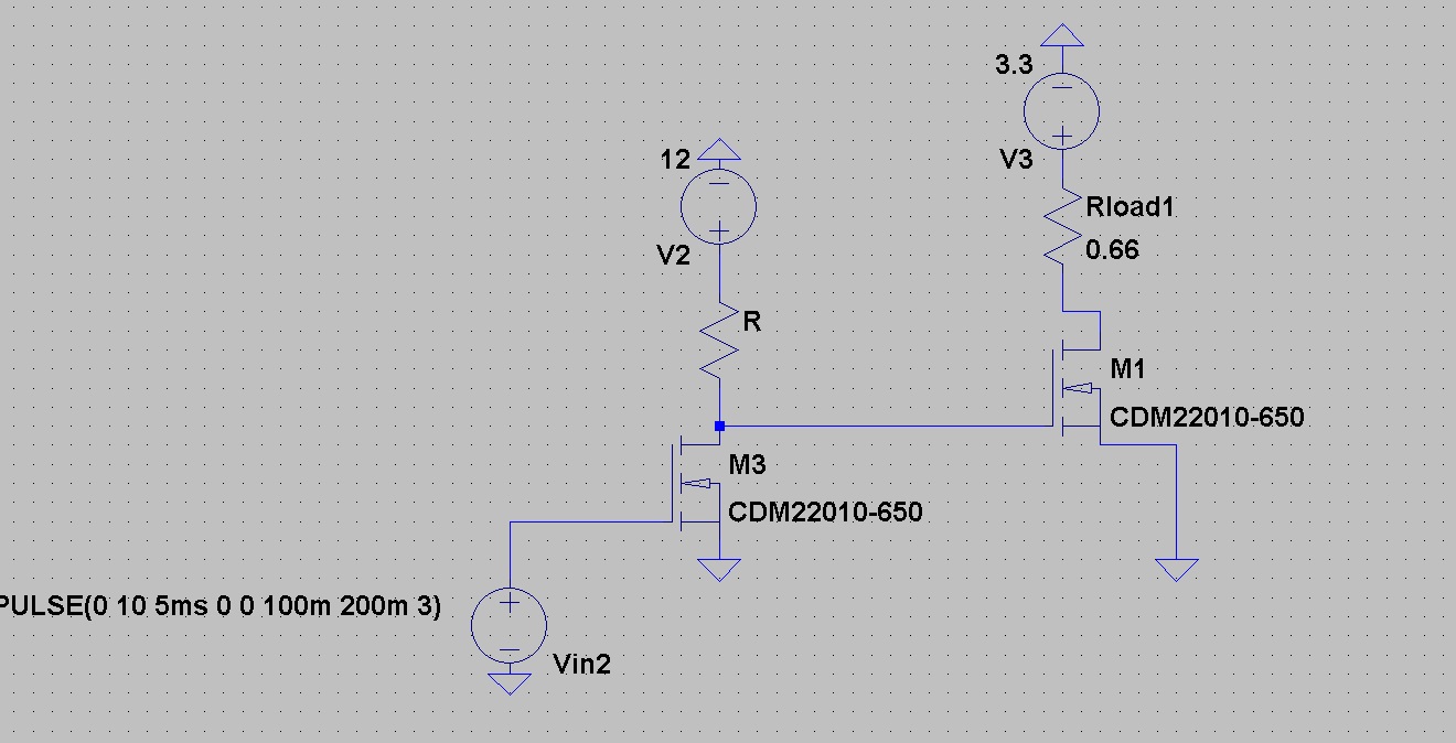

I just want to test a power supply with an active dummy load, if you look at the first image I uploaded on my original post the whole circuit is there, the NDF10N60Z is a power MOSFET that will control the current going through Rload, V1 simulates a 3V3 power supply I want to test. The reason why I need the DC voltage from the PWM to be greater is just because in my simulations, the load is only reaching the current limit for higher voltages than 3.3 at the MOSFET gate.

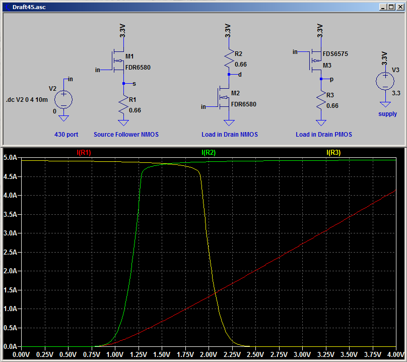

Why is the NMos switch configured as a source-follower (load in the source side) which requires you to have to get the gate to 3.3V+Vt+Voverdrive to fully turn it on? If you put the load in the drain side of an NMos, then you could find an NMos which can be fully turned on with only 3.3V of gate drive (requires ungrounding the load).
Alternatively, replace the NMos with a PMos, leaving the load between the drain and Gnd. The gate drive is now 3.3V off, and 0V is fully-on provided you get a PMos with a Vt of about -1V.
The plot shows the current through the three load resistors R1, R2, R3 as a function of the 430 port voltage V(in)

Almost any NFet with a Vth of < 1.5V, with an Ron < few 10s mΩ should work. Likewise, PFets with a Vth of ~ -1V. The ones I showed in the sim would work, but might be in surface-mount packages...
Also what parameter should I look for in the datasheet that lets me know what voltage it requires to be fully turned on?
You look at the Vgs voltage used to specify the ON resistance.
It should be specified for a Vgs of 3.3V or lower to work in your circuit.

I cant run your simulation because you didn't include your library. I'll guess that the Rds as a function of Vds of your Mos model is much higher than the one I used. Note that the FDR6580 has a guaranteed RDS(ON) = 13 mΩ @ VGS = 2.5 V.
Whatever you use needs to have a low RDS(on) with a gate voltage of less than 3V.

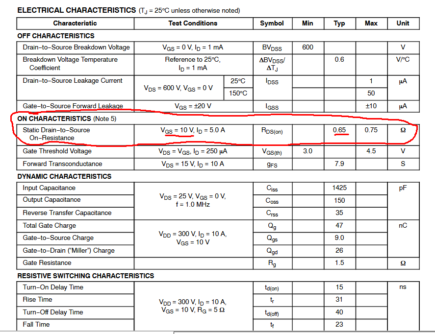

ps: I looked up the NDF10N60, and it is totally unsuitable for this task. It is a very high voltage Vds =600V, and very high Rds(on) = 650mΩ with a gate voltage of 10V!

Thoughts on using a 12V supply so you can use 'normal' MOSFETs.

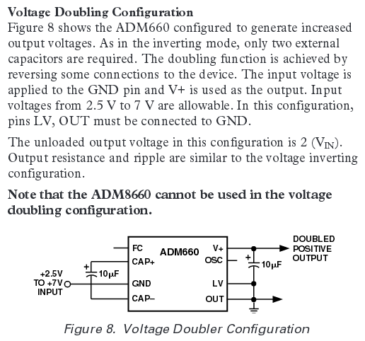

I went looking for a switched capacitor power supply and did not find what I wanted. (looking for what is in the 3.3V only RS232 driver ICs) They take 3.3V or 5V and make +/-10V for the driver.
The ADM660 is normally used to make a negative supply when you don't have one. But there is a strange mode where it will make a voltage doubler. Two ADM660s can make a 4x circuit.
1) 3.3V--> 6.6V
2) 6.6V--> 12V
Now with a simple transistor + resistor you can have a 0/12V signal on the gate of the MOSFET.

However, so far the "simple transistor + resistor you can have a 0/12V signal on the gate of the MOSFET" seems the best option... Just to be clear by that you mean what's represented on this circuit I've drawn am I right?
hmmmmmmm............
Ton = 1 second??
and Tperiod = blank?
use Ton = 0.5 ms and Tperiod = 1 ms

No. The On-resistance of the MosFet and the 0.66Ω load resistor form a voltage divider. If the Rds(on) is 0.600mΩ, what is the voltage across the load? What is the current through the load? You dont need LTSpice to answer those questions. To get most of the 3.3V supply voltage across the load, what would the Rds(on) have to be compared to 0.66Ω?
