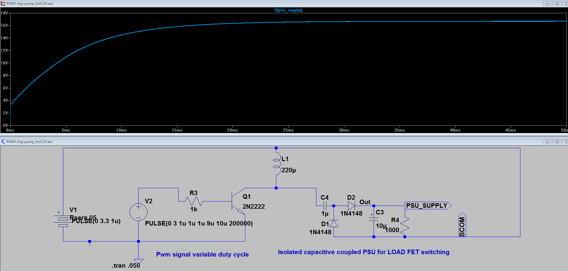

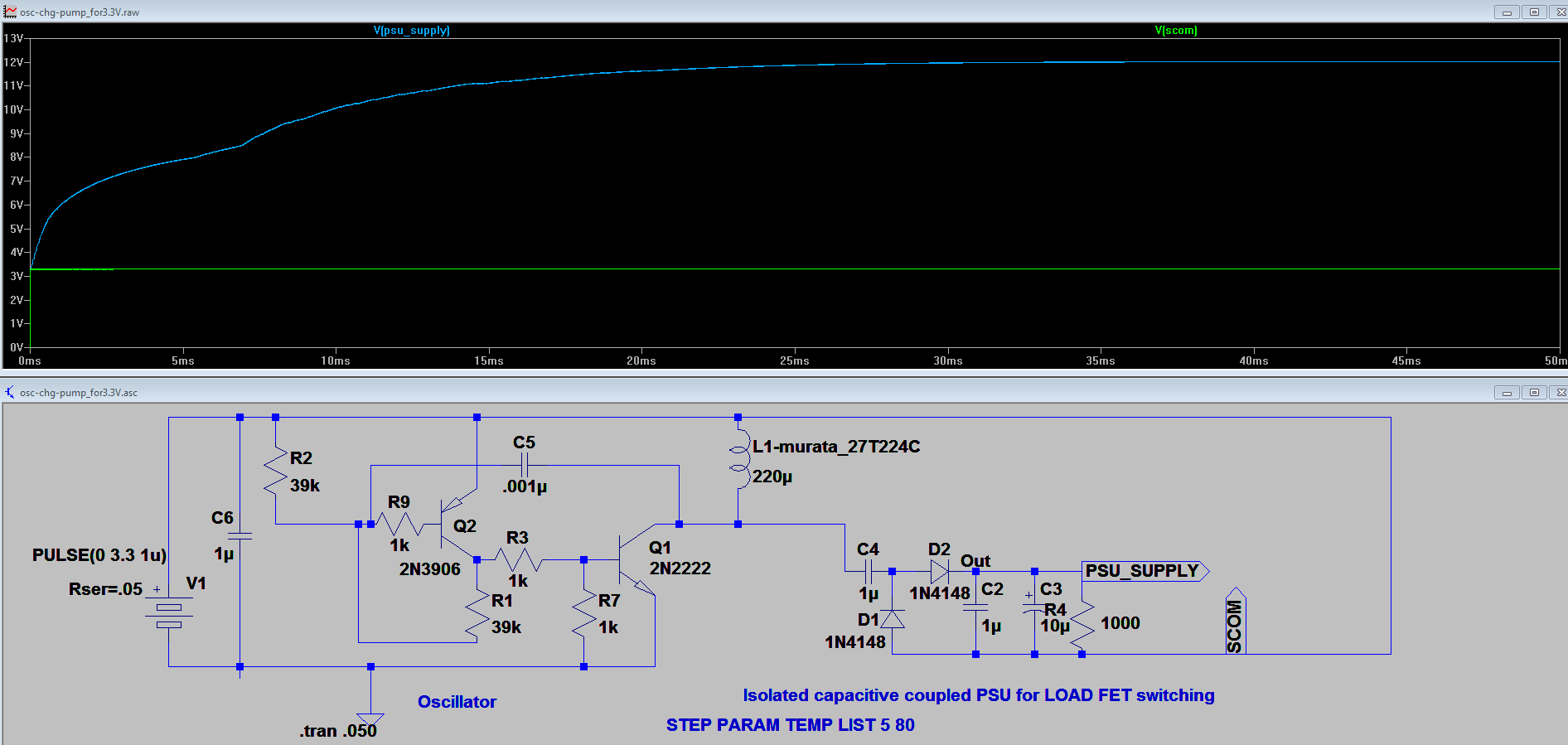

I had to handle something like this a while back. I believe you have a DC3.3V supply. The circuit generates its own 'PWM' for boosting the voltage. You can supply your own if you have a PWM source of reasonable current capability (up to 130 mA spikes on boot settling to 70mA)
Here's a circuit that will do 2 things with a load of about 1k which is ok for FET gates as the output cap will provide the current transient for the gate charge.
1) provide an isolated gate drive for the FET of around Vpeak -3.3V with SCOM as the 'ground'
2) Provide a Vpeak gate drive of about 12V if you use the common ground.
Edit: If you want to adjust the voltage out, replace the 1000Ω ouput resistor with a 1K pot. Lower the resistance to lower the output voltage .
This liberates you to use cost effective low RDs On NFETs with the 12V rail driving the gate. If you remove the burden 1K resistor you will probably need a 12 to 18V zener to clamp that charge pump gate voltage from rising too high.
  • osc-chg-pump_for3.3V.asc

Ok, here is a PWM driven option that drives voltage up via PWM DC%.
  • PWM-chg-pump_for3.3V.asc
