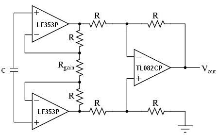

I just built the IA like the figure in the attachment. I'm using Op Amps with GBW 4MHz.
The resistor values for R(Gain) and R are 20KOhms and 10KOhms respectively. The op amps are connected to +12 and -12V supply.
But i can't get the triangle output... Is there anything wrong with it?

The schematic looks good. What supply voltages did you use? What voltage are you using for the AD537? I'm assuming the cap in the IA schematic is one in the AD537 VCO.
Yup! The timing capacitor is the one attached to the AD537...
I'm using +9V supply for AD537.
As for the op-amp, +12V to V+ and -12V to V-

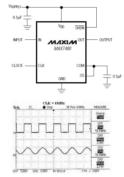

Hi, thanks for that idea. I'm using MAX7480 which is 8th-Order, Lowpass, Butterworth, Switched-Capacitor Filter...
I manage to get the perfect sine wave output from the VFC square wave. The clock is 100x of its input frequency (generated from function generator).
Is there any method for generating the clock automatically?
If i want any frequency let's say 100KHz, it would able to generate the 10MHz clock........if i want 100Hz, it would able to generate 100KHz clock.
Can it be done through programming? I'm using C... n my project involves parallel port.

The max cutoff frequency of the MAX7480 is only 2kHz. Other switched capacitor filter ICs can go much higher.
How come i manage to get 20KHz of sine wave through 2MHz clock?
In between, can i generate an automatic clock through programming?
I guess your IC was made on a Thursday afternoon. One made on a Monday morning wouldn't go as high.
Actually, the datasheet says that the 2kHz limit is because higher frequencies cause higher noise and distortion. I think a 4th order filter is able to go much higher than an 8th order filter and they can be cascaded to have an 8th order.

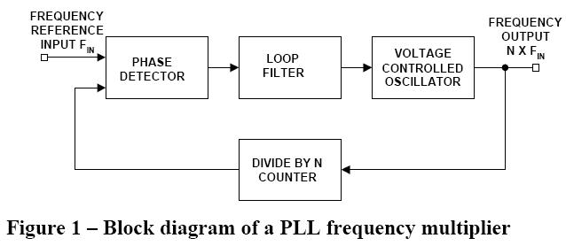

As Audioguru said, a switched-capacitor filter is a good solution, but you have to run your V-F converter at 100X for the clock, and then divide by 100 for the signal. This may not be practical, depending on the desired signal frequency.
Why it is not practical? Is it the 100x frequency is not stable?
100x means 100 times. The AD537 will only go up to 150kHz. This is your fastest clock frequency. You have to divide this by 100 for your function generator output, so your maximum sine wave frequency will be 1.5kHz. I doubt this is high enough for you.
Hi, base on the figure. The Output frequency is actually from the AD537 150kHz?
n the input reference frequency is the 1.5kHz (after divide by 100)?
OH! i still thought that the input freq. actually is 150kHz and so tht it can generates an output of 15MHz. I'm wrong.
