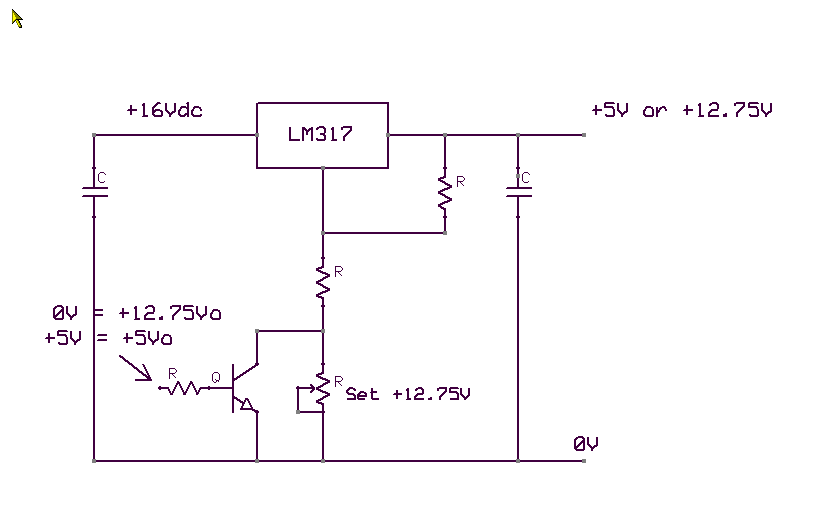

The method I used was a LM317 [ the TO92 version].
By switching, with logic, the lower Vset resistor its possible to switch +5V or +12.75V.
I used a couple of simple pots to get the two voltages correct.
Do you follow OK.?
EDIT: this is a circuit you could consider.
Change the Vset to suit the EEPROM that you need to program

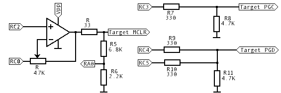

**broken link removed** describes an opamp solution he used in ICD2 clones.
vpp-png.22336
The opamp solution was never as popular as transistors but it takes less parts. I used it in a programmer cluster where I distributed a regulated voltage sufficent to run the opamp. Each programmer board had a 5V regulator and VPP is set by the 47K pot. The intention was to make several of the programmer boards but I only had two made when I ran into the Bill's Junebug PICkit2 USB clone. :)
Note: Luthar's page used to be one of the top hits when you googled for ICD2 clones. It has fallen so far on the list that I included the image and link here in an effort to help people find this old but good gem.

Whilst Luthar was the originator of the ICD2 clones, I would point you to our own Bill. If you download his designs for the inchworm and junebug they both demonstrate how to switch the 12V line with minimal components.
I added a link to my previous post.
Luthar's info in dated but to the point regarding the VPP question. If you want to build a programmer Bill has schematics on his site for the Inchworm an ICD2 clone and the PICkit2 clone the Junebug. He also has kits.
The Junebug is the way to go because its USB interface is fast. The RS232 based ICD2 programmers are too slow to work with the large memories used in many PICs.

Thanks Eric. I was not too sure about your solution to start with as I didn't understand the resistor switching and would have to get a LM317. Now I've looked at the gif you included and I realise I have a LM317T (bigger package, I assume that's irrelevant) it looks good and I'll probably give it a try.
3v0, thanks too. I like the op-amp solution as well. I've even got an LM358 too so I might try that.
