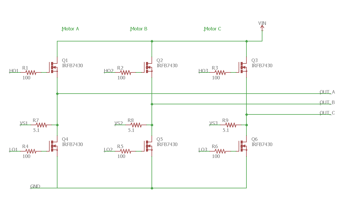

I'm trying to figure out why my motor driver doesn't like a 90% duty cycle. It works fine at 0-80 and 100, but at 90 it gets hot. I've found that the gate driver is lowering it's duty cycle at that range. I don't know why. More details and traces below.
I'm using an IR2136 driver
https://www.infineon.com/dgdl/ir2136.pdf?fileId=5546d462533600a4015355c8a02116a5
and the transistors are IRFB7430
https://www.infineon.com/dgdl/irfb7430pbf.pdf?fileId=5546d462533600a4015356169bcd1e53

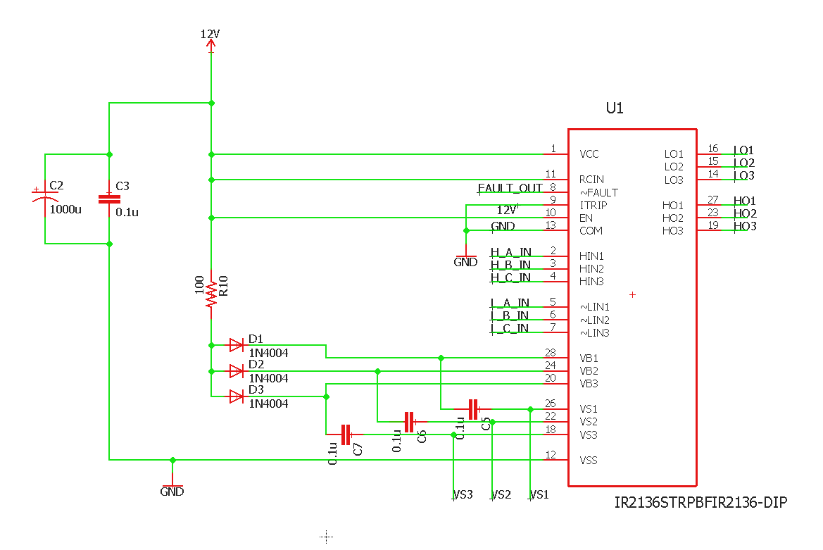

Here's my circuit
The motor being driven is 0.3 ohms through any pair of leads. Controller is a PSoC, set up to do PWM on the high side. The commutation table seems to work well so unless requested I'm going to skip that whole schematic and code.
Now here is the issue, at 90% duty cycle it gets very hot. It's fine at 0 to 80 and at 100, just not 90. I found a trace that at least seems to point to the reason why. If anyone is so kind as to help I'll be glad to get other current or voltage traces as needed. I can do up to 3 current traces and 4 voltages at once. The following traces are of the gate voltage coming from the driver chip. At 30% and 80% they're fine, close to the expected duty cycle, at 100% (not shown) it's just a plateau as you would expect. But at 90% it's not nearly 90%, closer to 60%.
Details
PWM f = 20kHz
FET positive supply 14.8-14.6V from a lipo battery
Driver chip supply 17.4V from a 10A current limited power supply

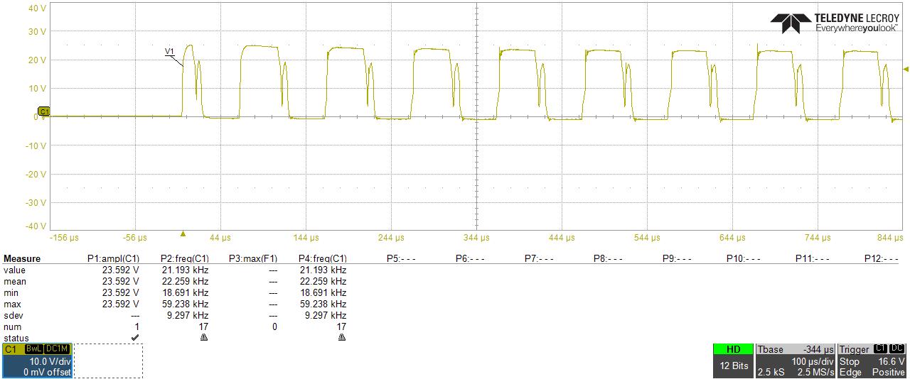

30% - the top trace is the one of interest, the lower one is just me monitoring the low side gate, as expected it stayed near 0.
80% - note on this one the motor moved, so the lower part at the start is not the full signal, seems like it should be 0 though not a lower pulse.
90%
Any ideas?
Thanks for any help!

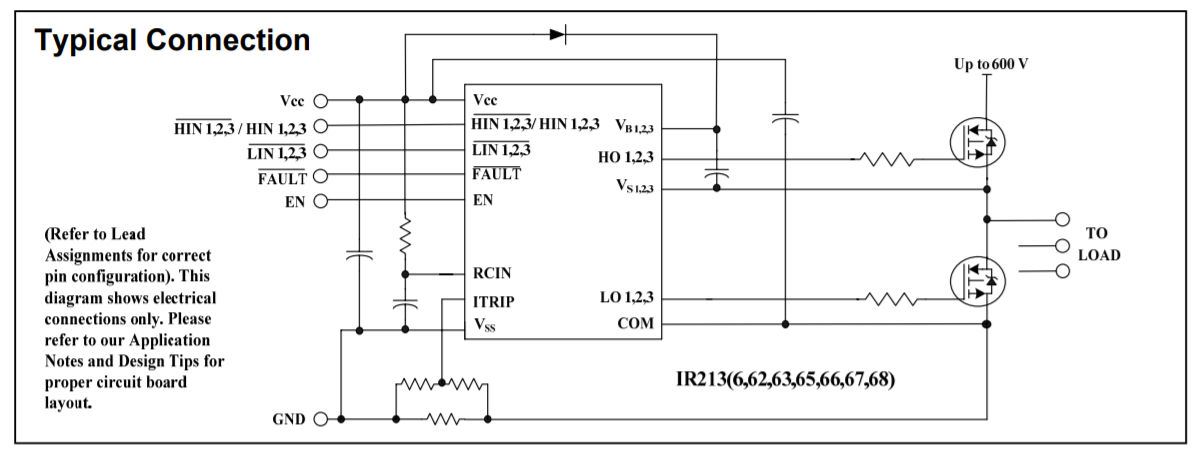

Your high side floating supply is running out prematurely. Larger bootstrap caps and/or drive the bootstrap caps from a higher supply. Also and smaller R10, much smaller, if you even need R10 at all. RC time constant x 3 is 5307Hz which is lower than your pwm freq. The caps arent even able to fully recharge each cycle.
To verify: Drive just one high side gate continuously. Does it always die after a certain amount of on-time? Does the problem improve when you increase the PWM frequency and worse when you lower it?
Do you understand what the bootstrap diodes and caps are supposed to do?
Ah, you have a point. I saw those on the example layout (no values) and assumed they were just filters. When I search for other examples of using the IRF2136 it looks like 10uF is more typical and I've used 0.1F. The polarity marking on the diagram should have tipped me off.
So these supply a bit of extra current for the charge pump to switch the high side capacitors on more quickly. Right?
Thanks!
Not extra current or faster switching. Those caps are the sole source of current unassisted by the 12V supply while the high side gates are on. The high side gates will be unpowered without them. They are a poor man's temporary duty floating power supply. The drawback is they can never run the high side at 100% duty.
They get recharged only whenever the low side in the same half bridge is on. Not when the high side is off. If commutation doesnt already do this, you must manually switch the low side on and off in between high side turn-ons to charge the bootstrap cap before activating that high side gate again or you will starve the high side gate of charge.

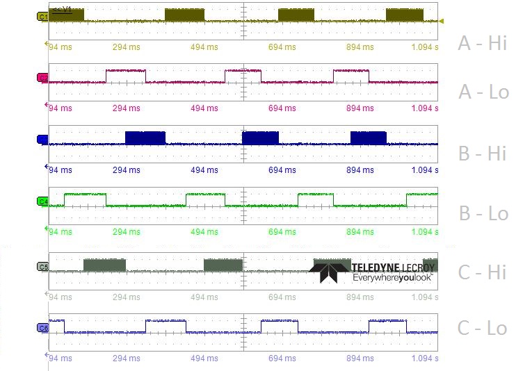

Here is what the commutation during a normal motor rotation looks like now. This is from the PSoC microcontroller to the driver chip (they are actually inverted, but here +5V is on)
It seems like even while spinning the wait for a charge would be fairly long, and if I want torque while slowed or stalled it will not appear at all with my current scheme. Is that correct?
So is the right thing to do in my firmware to add a complimentary PWM on the low side of each channel during it's pulse? So that each gates low side turns on in between the PWM pulses of its high side. At first I thought that might complete a circuit across another gate, but since two high sides are never on at the same time it should have nowhere to draw from except the capacitor.

No, the voltage boost circuit relies on the inductive spike to boost the voltage beyond the source voltage. The bootstrap cap doesn't do that. It's much simpler:
1. When the low-side is on, current can flow from the gate drive supply -> boostrap diode -> bootstrap cap -> low-side switch -> to ground. This just charges the bootstrap cap up to the gate drive supply.
Show in Figure 1:
https://www.infineon.com/dgdl/an-1123.pdf?fileId=5546d462533600a40153559692661096
2. When the low-side switch opens, the charge is now stored in the bootstrap cap.
3. Now, whenever the "to load" pin rises above ground, the bootstrap cap rides on top of this and the diode prevents the stored charge from draining back into the gate supply.
4. The high-side MOSFET source pin is connected directly to the "to load" pin and it's gate drive voltage is referenced to its source pin.
5. So the bootstrap cap gives you a voltage between gate-source on the high-side switch that is always enough to turn the gate on and off.
Do you understand why you can't just connect the gate drive supply directly to the high-side gate and expect it to work? Suppose it did work: a high-side switch in one phase was on and a low-side switch in another phase was on and current flows through the winding:
1. The voltage at the "to load" pin for the high-side switch taht is on would rise up very close to the motor supply since the high-side MOSFET is low resistance when on.
2. The high-side gate needs 12~15V between its gate-source to turn on.
3. Your gate drive supply of 12~15V is sits on top of (or is referenced) to ground/0V.
4. But the gate voltage required to turn on the high-side gate is not the voltage between gate and ground. It's the voltage between gate and source. In other words, the required gate voltage is a 12~15V that sits on top of the source pin (or is referenced to the source pin).
5. But your source pin is not at 0V. It's much higher than 0V, and higher than 15V if you are running your motor off something higher than 15V.
6. You need a 12~15V at the gate that is referenced to (sits on top of) the source pin, not to ground.
In other words, connecting the gate supply directly to the high side pin and assuming it turns on and works produces a contradictory scenario where the high-side switch can't possibly be on.Does that make sense?
The boostrap circuit doesn't behave as much like a inductive boost circuit as much as it behaves like a capacitive charge pump that rides on top of the source pin of the high side switch aka "to load" pin.
Your PWM is at 20kHz but you are using very slow 50Hz rectifier diodes. Use high speed diodes instead.
Yes use the right diodes. Ultra fast. The reverse recovery time is slow and steels power from the capacitors.
R10, 100 ohms seem high. Maybe 10 ohms. At high duty cycle there is not much time to charge the capacitors.
This type of circuit does not do well at very low or very high duty cycle.
I totally missed that on the diodes, thanks. I just downsized the resistors on my schematic to 47 ohms, but I haven't built another board yet, so down to 10 it is.

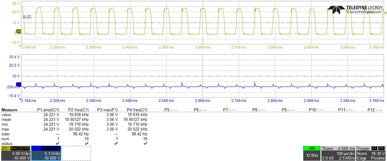

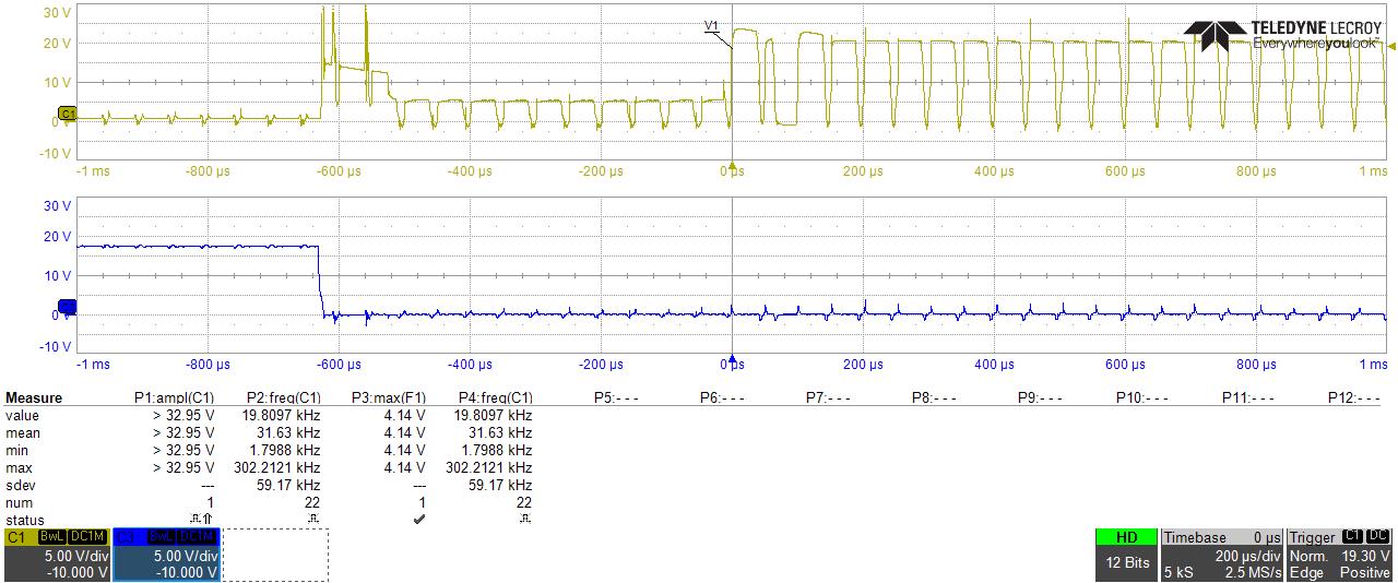

I'm thinking I should scope the capacitor voltage to see if it's staying high enough. The FETs are not getting burning hot now, but they still get kind of warm. I wonder if it is just because the motor is only 6 mOhm, so even with an Rds ON of 1.7 mOhm, the fets are still dissipating some considerable power.
I replaced the diodes with UF4004, and put 2 ceramic 1uF capacitors in series across Vb-Vs.
Sounds like fixing the diodes and capacitors solved the problem. You can not connect a scope probe (ground) to VS.
You can connect two probes, one to VB and the other to VS and add/subtract on the scope.
