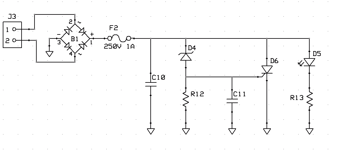

After some research, i came to the standard "crowbar" circuit (powerprotection2.jpg) And I think that this could work. Here is what i have so far, but am a little unclear about how to choose some of the components:
B1 - Rectifier in case someone puts AC voltage on the input
Type - Schottky, Schottky Silicon Carbide, Avalanche or Standard
?? (Doesn't Matter??)
Current Rating - Greater than the fuse Rating (1A)
Voltage Rating - At lease the maximum voltage to protect against (120V)
Speed - ?? (Doesn't Matter??)
Reverse Recovery Time - ?? (Doesn't Matter??)
F2 - Blows to protect Circuit
Type - Fast
Current Rating - Slightly Greater than Current draw of System Being protected (1A)
Voltage - minimum 2x maximum protected voltage (120V)
I2t less than I2t of SCR
C10 - Reducing Input noise
Capacitance - 100uF used in past seemed to work
Don't know if this will work in this case or not. Can try different types
Voltage - Greater than max protected voltage (120V)
Type - Electrolytic
D4
Breakdown Voltage - Slightly Greater than the normal working voltage (26, 27,28V)
Reverse Current - Greater than the draw from SCR and R12 (in parallel at breakdown) (???)
Power - Reverse Current x Max Voltage (???)
Max Voltage - Greater than the max protected voltage (120V)
R12 - provides current to the gate of the scr when D4 breaks down, current flows from + through D4 to SCR and through resistor to ground
Resistance - (???)
Power - (??)
C11 - Prevents thyristor from being triggered at power on. (called snubber)
Capacitance - High enough to snubb D4 (), Low enough not to create high state at the gate at power on. (??)
Voltage - Greater than max Voltage at SCR Gate which will be max protected voltage ( > 120V)
Type - (???)
D6 - SCR
Voltage Rating - Higher than the max protected voltage (120V in this case)
Current Rating - Higher than the Fuse rating (1A)
To Do:
Select SCR, then R12, then D4, then we can just try C10, C11.
SCR: MCR12DSMT4G (ON Semi)
Let me know if I am way off track here and if you have any suggestions, let me know. I will update this as I go for anyone who has the same problem in the future.

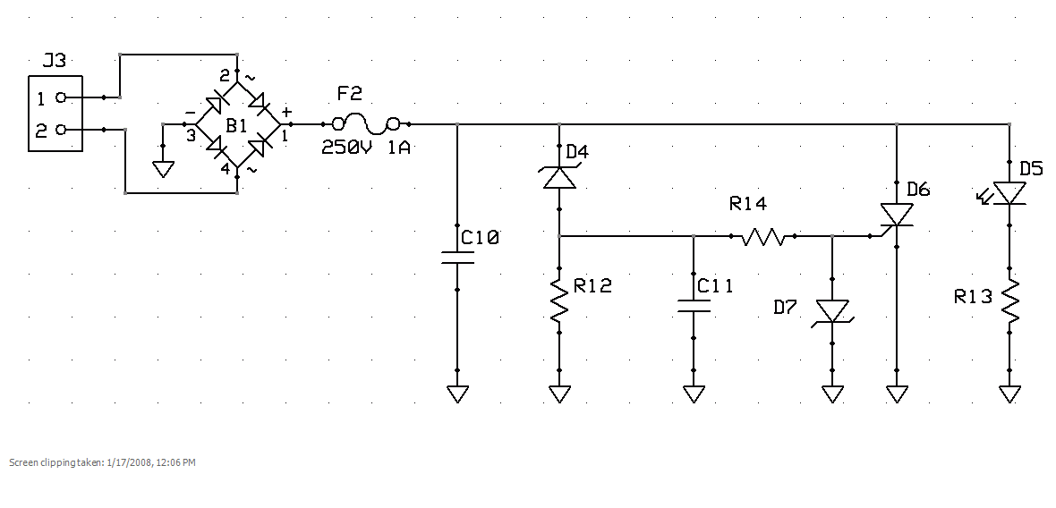

Ok, now i am stuck. Supposedly the resistor acts as part of a voltage divider circuit with the Source impedence in order to provide the correct voltage to the gate of the scr. What if I don't know the source impedence because I don't know the source. The idea is to protect from unknown inputs, so is there an assumption normally used that i haven't seen in my searches?
huh??? whether you put 28V or 120V the TVS conducts and keep the voltage at ~ 28V. The idea is that it short the unkown input supply for a long enough time so that the fuse blows and then holds off the input voltage.
put a series resistor (on right side of capacitor) in the SCR gate.. then you can also have a zener from gate to ground to keep gate voltage clamped. Put the additional zener on the right side of the resistor so it benefits from the resistors current limiting.
Right, except the TVS quit working properly (conducted all the time, even below the 30V it was rated at.) Is this (the first circuit) even viable, and is the second a better choice?
Done(see schematic).

You don't need the zener on the gate. The gate is basically a diode, and if the voltage gets high enough to cause that zener to conduct, your SCR is already toast.

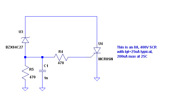

If you use a sensitive gate SCR, you can also use a low power zener as below.
