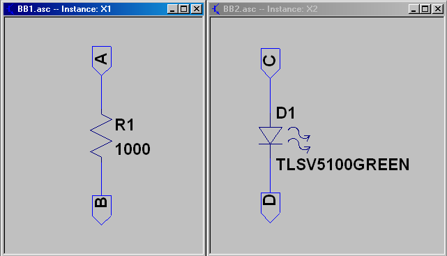

MikeMl,
Are you defining active elements as "ohmic" or not? ...
If the current is mostly proportional to applied voltage, then it is Ohmic, be it part of an active device, or not. I do not consider the base to emitter junction of a bipolar transistor to be "Ohmic".
For Beakie's benefit (before this thread degenerates further), here are the contents of the black boxes:
Note that you can easily infer the resistance of the hidden resistor from the plot. Note also, that a Green LED has a characteristic forward voltage when emitting light, and it has a rather low reverse breakdown voltage...
I guessed diode, but didn't pay enough attention to the forward voltage to guess what kind. Also too lazy to look up voltages of various color LED's ( not to mention I didn't want to give the answer away :) ).
