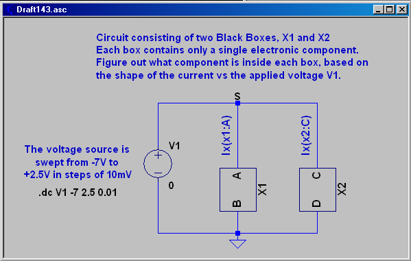

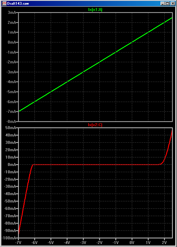

Look at the following circuit and plots. It consists of two black boxes wired in parallel. A voltage source is connected, and is swept both negative and positive. The applied voltage is the independent variable, and is plotted on the X-axis. The dependent variables are the two currents, Ix(x1:A) and Ix(x2:C) through the black boxes, X1 and X2, and are plotted on the Y axis, respectively.
By looking at the shape of the I/V curve, try to figure out what is inside each Black Box. Hint: each box contains only a single two-terminal electronic component.
