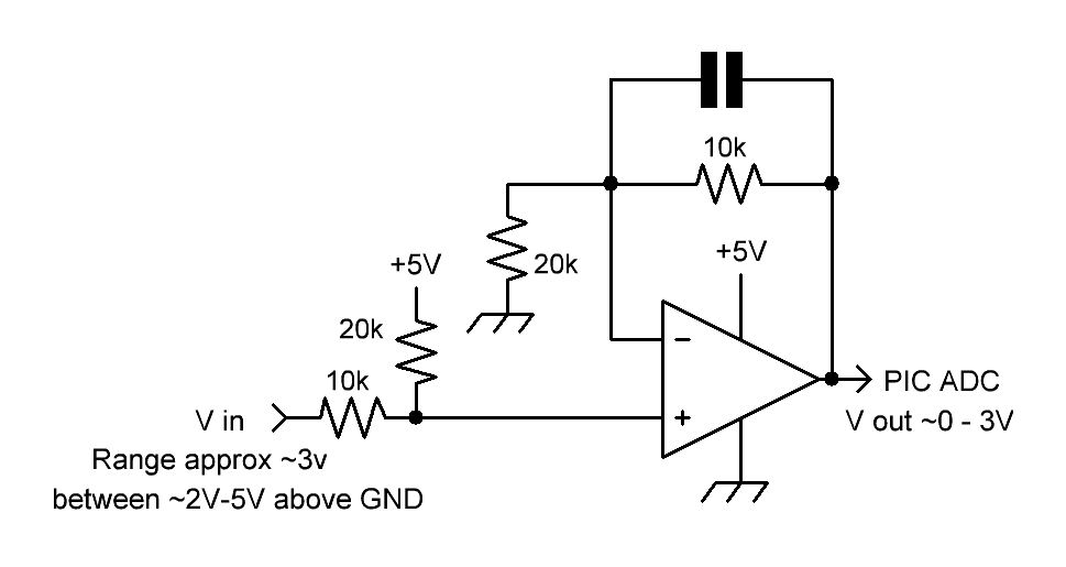

I need to level shift a voltage that has a range of ~3V and sits between ~2 & 5V, to a non-inverted 0 - ~3V to feed to a PIC ADC input (PIC is running on 5V).
And it of course needs to done simply and cheaply (when doesn't it).
Idea #1 (ignore the resistor values for the moment, they are placeholders) open to other ideas but pcb real estate is limited.
The cap is to try and keep out any rubbish that might be on the incoming voltage and the op-amp is a rail-to-rail device TLV2371.
Nope. You want to shift the input signal range downward. But an attenuator referenced to a voltage that is greater than the average value of the input signal will shift that signal upward.
ak
Why not do it in software? Simply subtract 2/5x1023 from the result.
Edit. Unless you intend to use the internal 4.096V reference.
You have roughly the right idea, a "differential amp" - but the input reference should be the 2V offset and the output reference zero.
The 20K that connects to 5V should be grounded (output reference), and the 20K grounded should be at 2V (input reference)
And the Vin 10K & 20K should be opposite values.

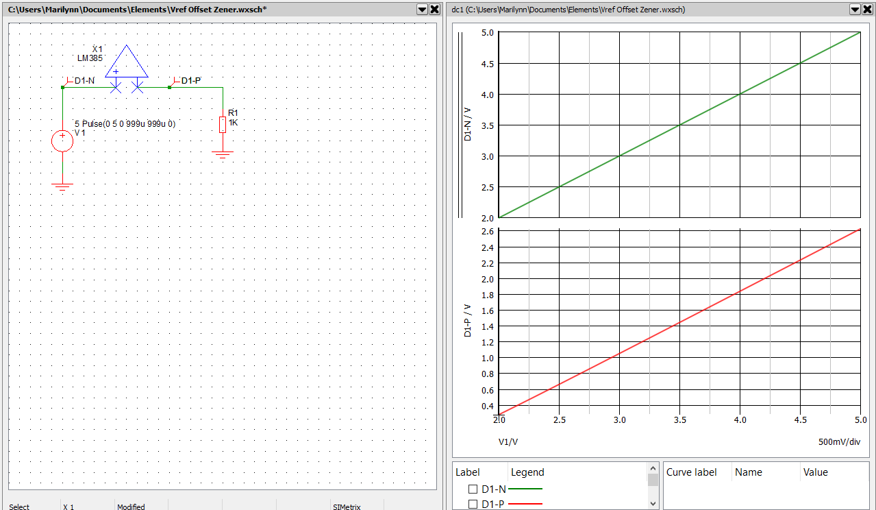

You can get a +/- 2% zener, 2V, and a R, say 1K, and that will do the offset.
Or use a 3 term adjustable Vref (the LM385 is functioning as an adjustable zener)
Note the symbol is screwy because I could not find a standard spice model for the part.
Also the 385 may be obsolete but there are replacements for it, TI, Analog Devices.....
This particular model was 2.4V I think, but you get the idea. The zener / Vref gives you a fixed
Voffset which is all you need. 2V and 2.048 V seem common as references.
There is a consideration for Vref settling time if your input signals
are transient large signal rich, otherwise can be ignored.

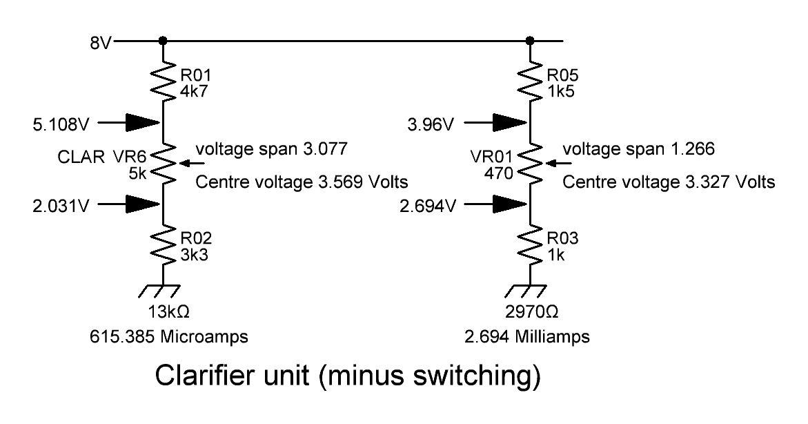

Left side of attached diagram is the bit of interest (right side is a preset - not user adjustable).
Marked voltages are assuming components are 'ideal' and 8V line is actually 8V, something we know is unlikely to happen in the real world, hence the use of ~ above.

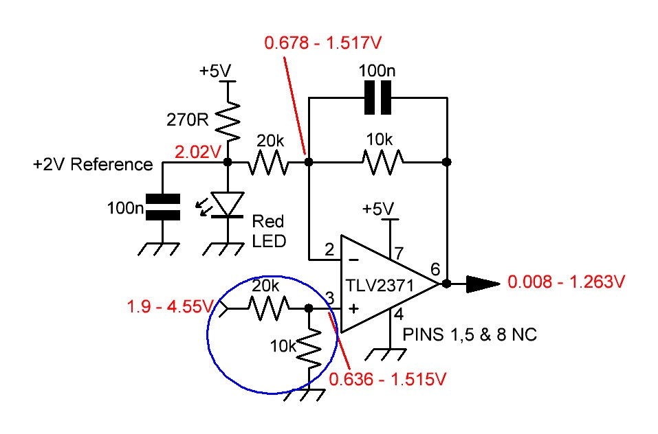

Finally got the chance to build this and test it - and of course it doesn't do what I want :banghead: - can anybody see a flaw in the implementation.
I would have expected the output voltage to run between ~0 and 2.65V with the given input voltage range.
No, because you have a differential amp with a gain of 1/2, thus your output offset is -1V, and the output swing is 1/2 the input swing.

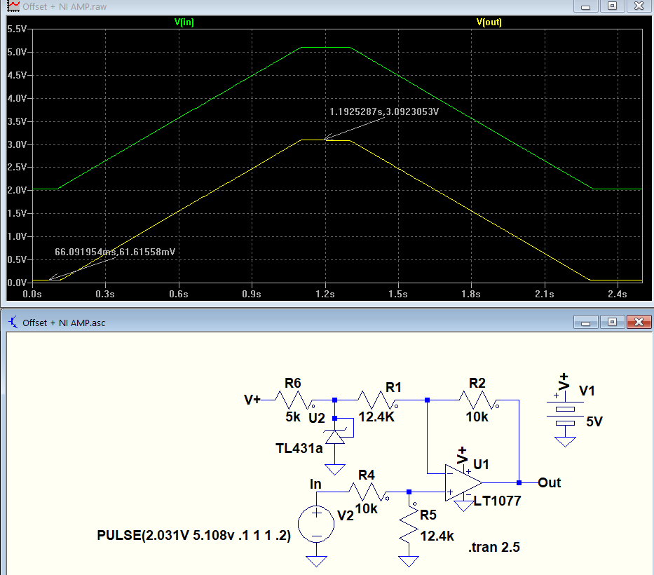

Below is the LTspice simulation of your circuit adjusted for your original requirements and using a stable reference:
First I calculated the value of R1 to give an inverting gain that generates -2V output offset from the TL431 2.5V shunt reference voltage.
Then I determined the R4 and R5 input resistor values to give the desired non-inverting gain (+1 here) at the output.
In this case it can be just the same values as R1 and R2.
From that, the simulation shows the output (yellow trace) going from ≈ 0V to 3V for an input of ≈ 2V to 5V (green trace) as calculated.

Just change the 20K resistors to 10K, so it's a unity gain differential amp.
You may have to tweak the bias slightly to get the best range.
Yep, helps if you use the right calculations, using the right one gives me the same number - Vout = (V2-V1)*Rf/Rs :oops:
Will have another go with amended values, thanks.
Did actually try that and the output dropped from 1.2V to 1V - but it is possible I had a bad connection - been too hot and sticky in the back room today.
Turns out I had shorted a wrong resistor (In the test bed I had 2 x 10k in series for the 20k) - correcting that now gives me 0 - 2.53V output for 1.82 - 4.35V input.
I'm going to try using 100k resistors to (hopefully) lighten the load on the incoming line to restore it back to it's original 2 - 5V range.
