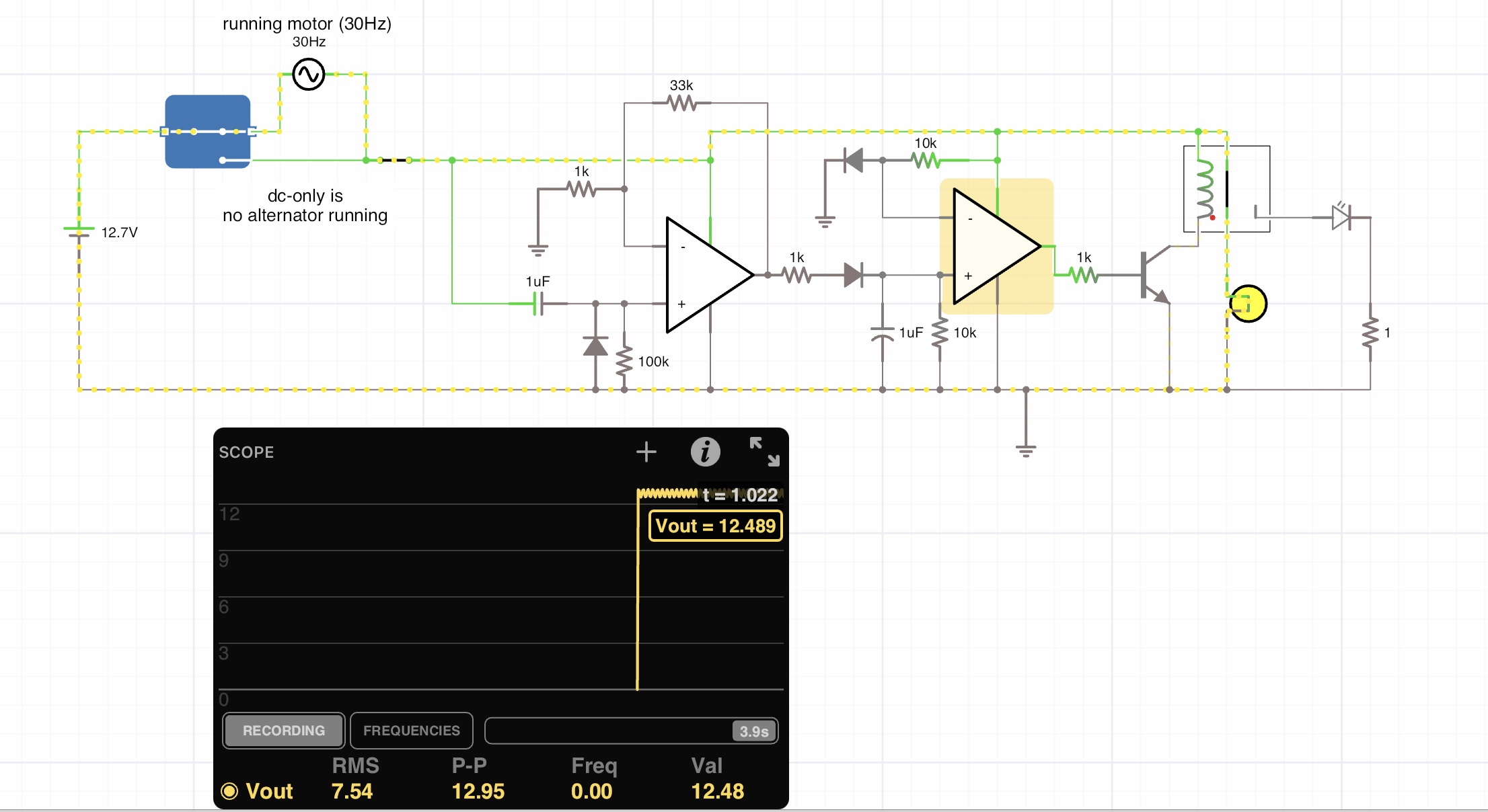

Need help again, i have coming home feature on my car, now i installed bixenon lens and dont want them to run everytime i lock or unlock my car i want.them to run obly whrn car is running.
So i need a simple circuit that just turns a relay on or off (relay controls bixenon and led bulb) depending on battery voltage, example if battery voltage is over 13v, relay turns on and closes circuit for a ballast to turn on, when car is shut off, voltage drops to 12.7, relay deenergizes and led bulb turns on for a coming home feature.

Oh my god, didnt ask you for regulations or any of that, i have my bixenon lens in high beam reflector, and led in low beam reflector so even if my bixenon cuts out my low beams will turn on. But thats only if my alternator craps out. I just asked for a circuit that switches off when voltage is below 13v. So i will use my low beam reflector only for comin home feature, so my battery doesnt get used for nothing.
Alternator charges at 13.8 to 14.2v and under full load it falls to 13.6v so voltage 13v is perfect voltage that wont allow them to turn off or on based on load, accidentaly. And actually wiring it somehow to the ignition switch is not a bad idea

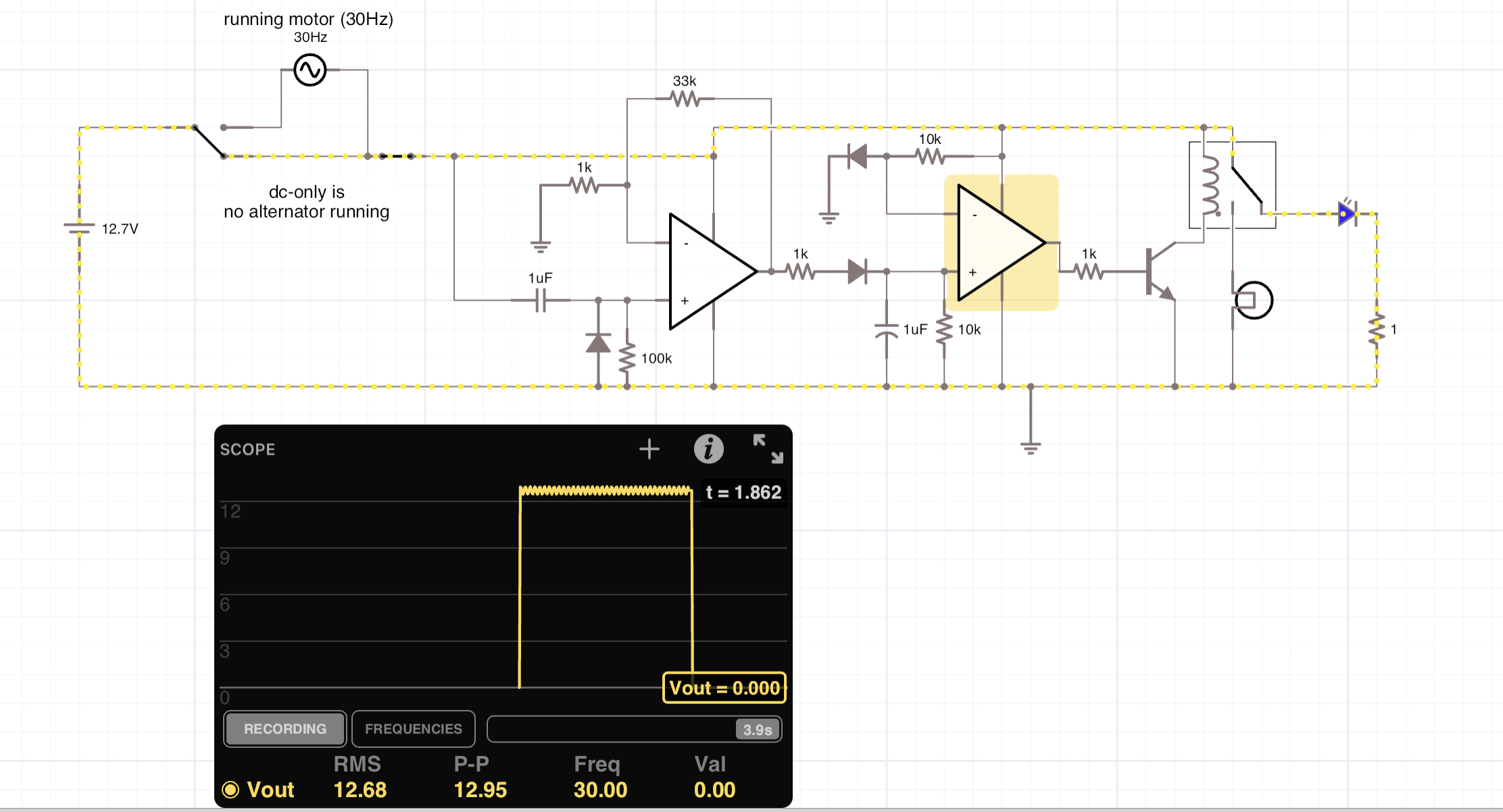

You can just capacitively couple the battery to an amplifier. Rectify the output into a filter to keep the output high any time an AC signal is present on the power rail.
that way, every time the alternator is running, the signal will be sensed and the relay coil will be energized. When just battery is powering, then the relay coil is not powered.
that way, load on the battery or charging variation is not important.
note the switch before the signal generator allows straight DC or, when switch is flipped, DC with a 0.25v AC signal on it.
The ignition feed or the alternator warning light feed would be much better than measuring the battery voltage.
